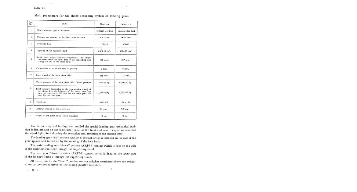

Gentlemen, my nose strut seems a bit soft. How many PSI of nitrogen should I inflate it to?

20 (+/- 1) atmospheres (293 PSI) for the nose wheel strut.    Main wheels (FYI) are 48 atmospheres.

here is a table from the maintenance doc regarding the nose and main gear strut
regards
Bruno
