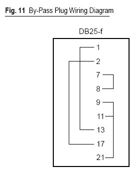

Okay. If the intercom is working then the
AUDIO paths to the two microphone inputs to
the intercom are intact. Without having
a schematic of the IC . . . I have
no way to deduce how the PTT commands
are processed going though the IC.
In one of the Flightcom installation manuals
I found a suggested tool for bypassing
the IC . . . which is also useful for trouble-
shooting.
[img]cid:.0[/img]
Suggest you check your manual for such a
recommendation and have the tool on hand.
With the IC bypassed the radio should
work normally as if only the pilot's headset
is connected directly to the radio. Whether
or not this produces improved behavior is
an important clue for tracking down root cause
of your problem.
