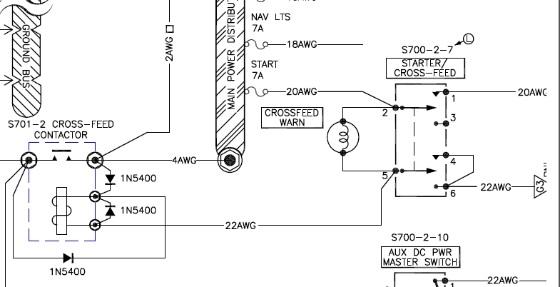

PostPosted: Wed Jan 04, 2017 10:16 am    Post subject: SD-20/SD-60 Question Reply with quote
I am running a SD-60 and a LR3C-14 Voltage Regulator on one bus with its own battery and a SD-20 with its own LR3C-14 Voltage Regulator on the second bus with its own battery. The engine is a Lycoming IO-540.
Okay, Figure Z-14 . . .
QUESTION 1: I intend to operate my two electrical systems isolated with a bus tie that will be used for engine start only and then untied afterwards. What happens if I forget to untie the two busses after engine start and both the SD-60 and the SD-20 are providing current to the combined system? Do they share the load equally on the combined system? What happens should the system load reach 50 AMPS? Does the SD-20 simply max out at 20 AMPS and then the SD-60 picks up the rest of the 30 AMPS?
Not necessarily. Both regulators should be set for
optimal BATTERY maintenance (14.2 to 14.6 volts).
It’s practically impossible to set them to the same
voltage. Hence, while paralleled, the alternator
with the slightly higher setting will ‘hog’ the
load until such time as it maxes out, bus voltage
falls until the alternator with the lower set-point
picks up the difference.
QUESTION 2: If I do remember to untie the busses . . .
How would this happen? If wired per the published
drawing, the crossfeed contactor is automatically
closed when a SPRING LOADED switch is moved to
START position. This gets you two batteries for
cranking while illuminating a CROSSFEED WARN
light. When the engine starts, the switch is
released, the contactor opens, the light goes
out. Nothing to 'forget'.
