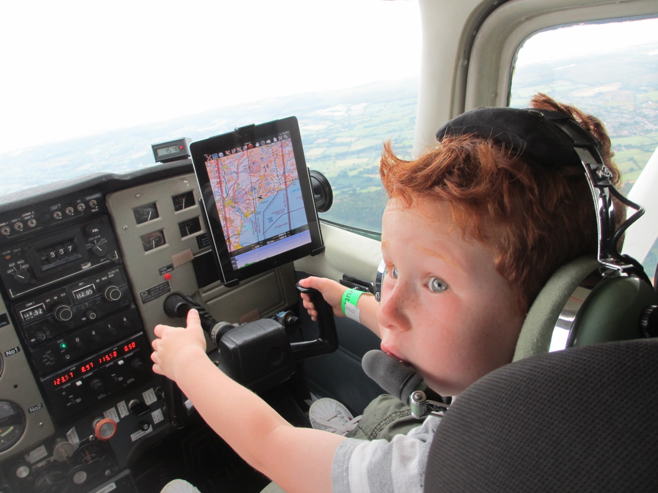

PostPosted: Wed Jul 09, 2014 3:39 pm    Post subject: sundry questions Reply with quote
This is my 4year old grandson, flying P2, with my IPad suction mounted on my C172
John
Sent from my iPad

Excellent Photo
On 10 Jul 2014, at 00:38, John Tipton <jmtipton(at)btopenworld.com (jmtipton(at)btopenworld.com)> wrote:
[quote]<image.jpeg>
