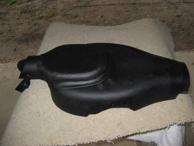

PostPosted: Sun Jun 22, 2014 5:48 am    Post subject: Baffling Question Reply with quote
Thanks Kelly. Always good to have a couple of approaches. I already have the Van's cowl fitted and just can't justify pitching it. I'm enjoying the 'journey' and doing some mods to improve (I hope) the Van's approach.
I didn't like Van's alt air ...... I know, you can reset it after shutdown .... so I did this:
[img]cid:part1.08020702.04030205(at)cfl.rr.com[/img]
Because I can ......
I'd probably be flying by now if it wasn't for all the mods Razz
Linn
