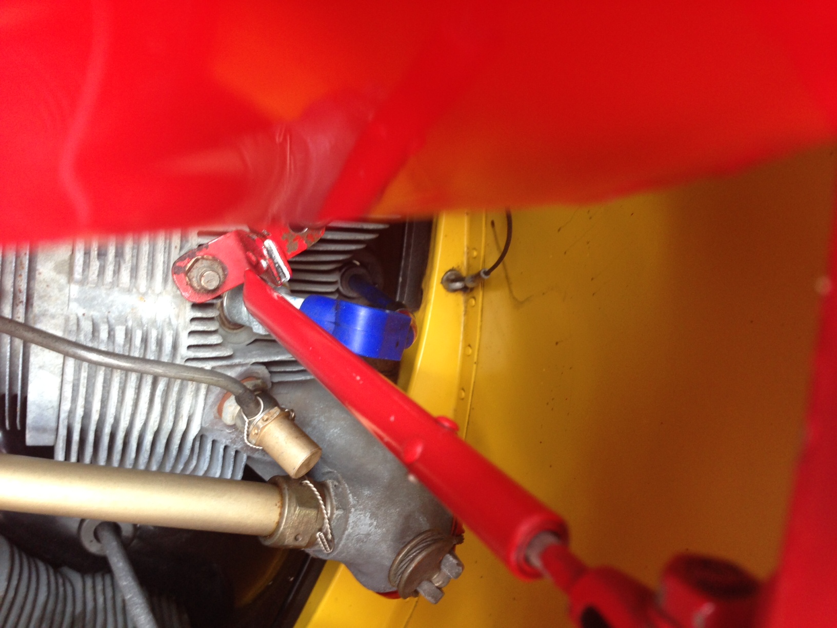

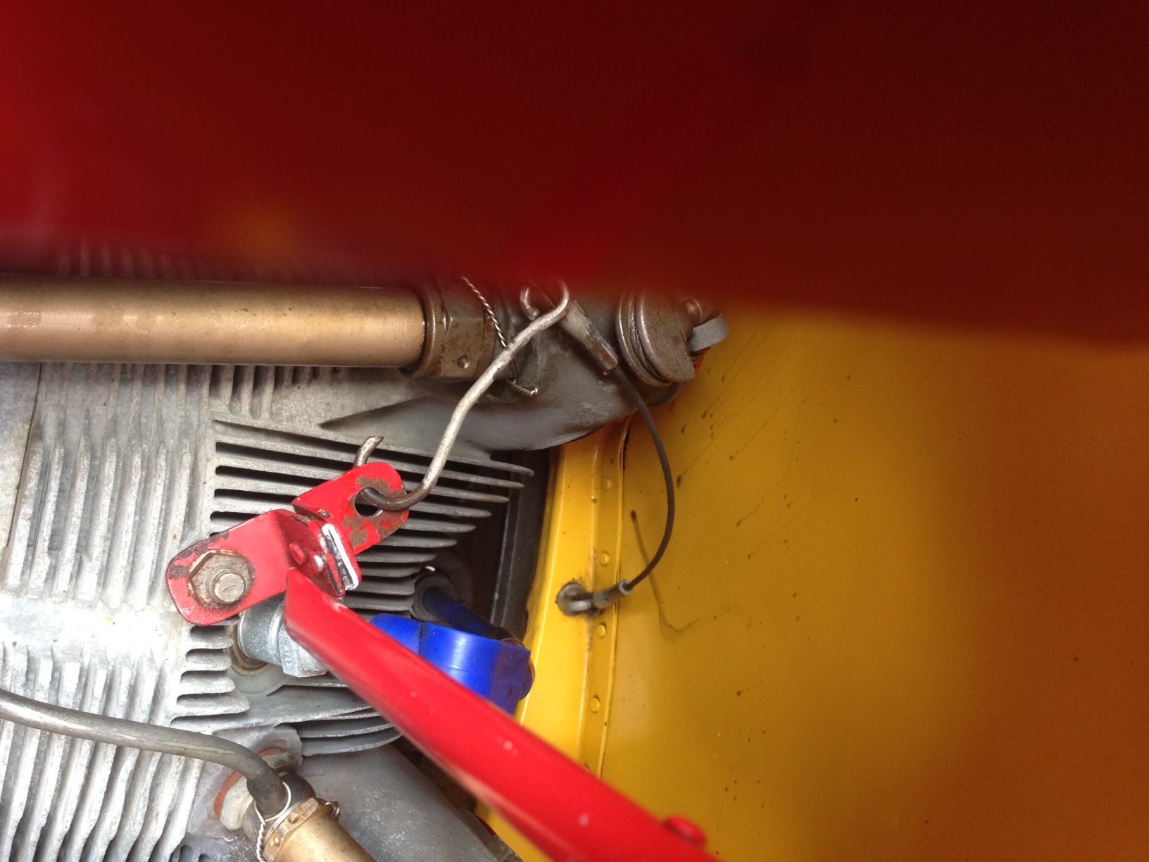

All: I came back from a flight and found a cooling louver ring support Rod broken. Looking to see if anyone knows where I can get a replacement. Is the lower rod that supports the hook and wire that holds the lower calendar up when the cowling is open. Pictures attached.

Thanks Doug...need the one that hold up the hook and wire on the lower cowling. See photo and thanks again...

The CJ rods fit the YAK. Call doug Sapp.
Doc

Call Doig. A lot cheaper than machining another one
Doc

Unless I am mistaken, the CJ rods are the same as the ones on the Yak 50, but not exactly the same as the 52's. The difference is the 52's rods have a slotted, countersunk end at the louver ring outside end (which makes them fit flush to the ring) and the CJ's are simply a flattened rod.
Dave Jester, take a look at the end of the rods around the outside of the ring on your 52 and then go look at the rods on your neighbor's CJ's ring.

Oops! I was thinking it was a LOUVER rod. Not the adjustable ring brace rod.
Sorry for my misunderstanding.

Correct Dennis. The YAK 50 louver axels are different and are not interchangeable with the 52. The ring braces rods and ends are though.
Doug has them. I keep a couple of spares just incase. The straight and the 45 degree ones.
Doc
