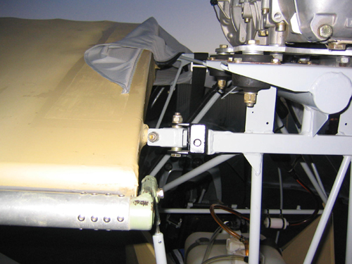

PostPosted: Mon Jun 26, 2006 6:05 pm    Post subject: Re: Still fighting--- Reply with quote
Hi All,
On an Item of note regarding "Still Fighting". I have a Firestar II that I bought used a few years ago. It flew quite well and without trim. About two vears ago I decided to recover the fuselage due to some wear and tear of the fabric and primer failure issues. I thought about repriming the fuselage cage with epoxy primer as had the original builder. However I decided to have the cage powder coated for the better durability it offers.
After completion I flew my Firestar only to find out that now I had a right wing heavy issue and needed lots of trim. I didnt change anything on the wings or struts. I bought the English Ujoints and corrected the problem by changing the incidence of the left wing. ( It took three washers in the joint).
Apparently during the powdercoat process of heating up the cage to make the material flow, the heat (400+ degrees) allowed the cage to relax enough here and there to change the incidence between the wing panels.
So if you are thinking of powdercoating your cage, it is highly advisable that you do so at the start of construction. Otherwise you may end up retrimming your plane as I had to.
Thanks for the Great Kolb Forum
The Baron
