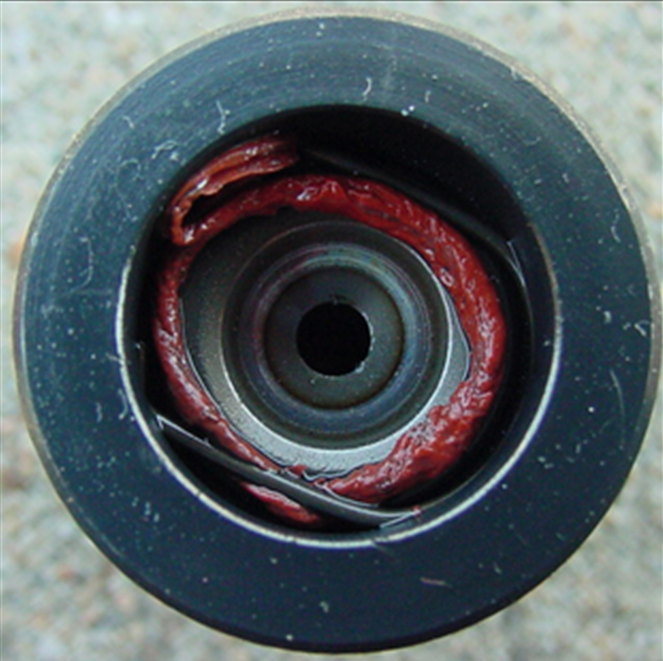

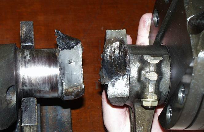

For those of you advocating the use of RTV in aircraft engines, or for those who might be tempted to use it, I offer the attached photos.
One photo is of a hydraulic valve lifter, packed with RTV.  RTV gets soft in the presence of motor oil and gasoline.  Heat accelerates the deterioration.  You’d be surprised where it ends up…
The other photo is the result of loss of torque on critical fasteners.  RTV was used instead of the indicated (required) sealant.  In operation, under the stresses of the power stroke, RTV in critical joints allows things to move that shouldn’t – like crankcase halves.  Movement results in fretting.  As the main bearing saddles fret, the through-bolts lose their clamping force and the bearings begin to move.  In this instance, the main bearings walked fore and aft, stopped by the adjacent crank-pin cheeks.  When the bearing touched the cheek, it left a mark – a stress riser.  The result is inevitable.

Gentlemen -
You will not find RTV listed among the approved sealants for either brand of engine.
The only place it is acceptable is sealing gaps in baffles.
Neal George
Continental Motors

Thanks for the 'result' photo's

Your point is well taken. But, You are generalizing the term RTV. RTV is not a product. It is a description of a product that is Room Temperature Vulcanized. The chemistry of RTV products is wide and varied with performance accordingly. Not all RTVs are created equal! There are RTVs that do not "get soft in the presence of motor oil and gasoline"

No One - Is advocating using RTV inside the engine. The IDIOT that did that should never blow his nose... He will blow his brains out!
Yet! Lycoming does use an RTV to seal the case halves. So, making a 'general' - "Don't do it!" statement is not the way to go. There were very particulars on What to use and How to use it.
NOTE: All RTV are not the same. And when you consider that Lycomning use to use a Silk Thread and Varnish to seal the case halves - Damn! RTV is one hell of an improvement.
So, I guess RTV is 'recommended'!
One photo is of a hydraulic valve lifter, packed with RTV. RTV gets soft in the presence of motor oil and gasoline. Heat accelerates the deterioration. You&rsquo;d be surprised where it ends up&hellip;
The other photo is the result of loss of torque on critical fasteners. RTV was used instead of the indicated (required) sealant.  In operation, under the stresses of the power stroke, RTV in critical joints allows things to move that shouldn&rsquo;t &ndash; like crankcase halves. Movement results in fretting. As the main bearing saddles fret, the through-bolts lose their clamping force and the bearings begin to move. In this instance, the main bearings walked fore and aft, stopped by the adjacent crank-pin cheeks. When the bearing touched the cheek, it left a mark &ndash; a stress riser. The result is inevitable.

The Overhaul Manual for both Lycoming and Continental engines call out specific products and procedures for sealing the various joints.
Y’all do what you want, but I’m really tired of reading about friends in the news.
A complete discussion of this subject is rather detailed and lengthy, and does not lend itself to email-type back & forth. Anyone who would like to continue the discussion is welcome to call me on the CMI Tech line or drop by the booth at OSH and we’ll hash it out.
