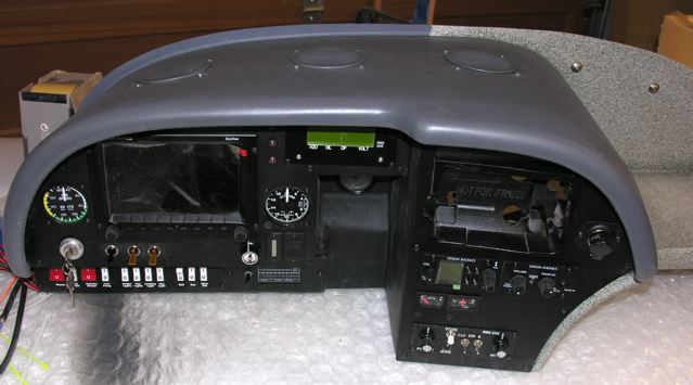

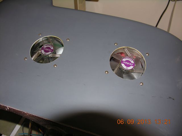

PostPosted: Fri May 30, 2014 8:33 am    Post subject: Key Sanding................and Instrument Panel ventilation Reply with quote
On May 29, 2014, at 10:23 PM, Tony Renshaw <tonyrenshaw268(at)gmail.com (tonyrenshaw268(at)gmail.com)> wrote:
“ I believe there is a likelihood that whether you use 240 Grit paper, or 60 Grit paper, that the substrate will increase in surface area by the same amount”. Any takers? Anyone had enough red wine to give this consideration?
…too early in the morning for the wine…intuitively, as I imagine a field of a given size covered w/ hemispheres…an approximation of grit paper...as I imagine the surface area of the hemispheres as the hemispheres diminish in size…I cannot escape the conclusion that the total surface area will increase in inverse proportion to the diameter of the hemispheres…
…nonetheless…I can think of better reasons to avoid 60 grit when key sanding…
P.S. I have an instrument panel fan, a computer fan, and I am wondering where would be the most advised place to put it? I am thinking midway between the main panel and the radio stack, behind the mono wheel gear retraction handle rebate, on the RHS. Whatdoyareckon?
I reckon putting in 3 those 120 mm computer fans (at) $10 each were the was easiest decision I’ve had to make regarding my panel…I’m uncertain at this time whether or not I’ll use the little louvered vents intended to direct airflow towards the windscreen.
F.
