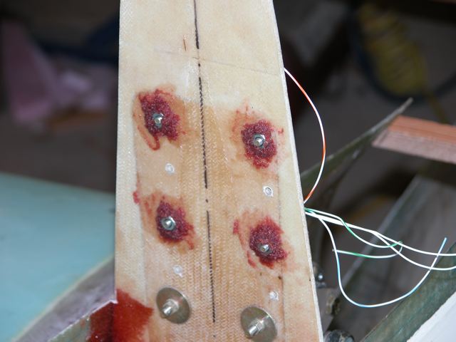

I used nutplates and Allen screws that will allow removal of the servo with a ball end Allen.

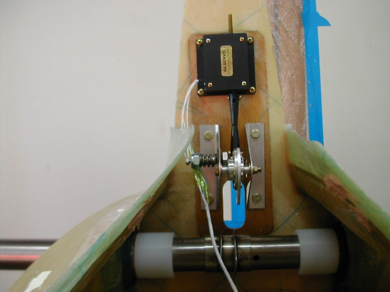

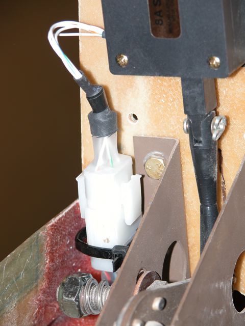

Tony…At that stage of the build, I was not comfortable
w/ using D sub terminals and questioned my ability to
disconnect them w/ one hand…I used this AMP connector w/
the larger, crimped pins…I also floxed the nuts on the
back face of the bulkhead which hold the servo in
position, though I’d use nut plates were I to do it
again…Fred

rlborger(at)mac.com
PostPosted: Wed May 21, 2014 4:03 pm    Post subject: Electrical Wiring Reply with quote
Hay Fred,
Don’t fret. I did mine just like yours:
[img]cid:1D08E18E-513A-4570-A8E3-43E8A951043D[/img]
It works just fine. That’s the way my instructions said to do it:
Trim servo
Step 5
Unpack the MAC electric trim servo and study all the instructions.
Cut off a 32 mm (11/4“) piece of the threaded rod and screw on the two plastic fork-ends until they are
butted together.
There must have been a change in the instructions somewhere along the way.
Blue skies & tailwinds,Bob BorgerEuropa XS Tri, Rotax 914, Airmaster C/S Prop (50 hrs).Little Toot Sport Biplane, Lycoming Thunderbolt AEIO-320 EXP3705 Lynchburg Dr.Corinth, TX 76208-5331Cel: 817-992-1117rlborger(at)mac.com (rlborger(at)mac.com)
On May 21, 2014, at 5:06 PM, Fred Klein <fklein(at)orcasonline.com (fklein(at)orcasonline.com)> wrote:
On May 21, 2014, at 1:41 PM, Donald Cameron <fireflier(at)btinternet.com (fireflier(at)btinternet.com)> wrote:
From memory when i installed mine i had to shorten the fork ends.
Don…not exactly what I wanted to hear, but I thank you nonetheless for responding to my request…after poking around a bit, I don’t see any insurmountable problems to trimming my plastic clevises at this late stage of the game.
Though I’m wondering…when you “shorten(ed) the fork ends”, were you trimming literally the ends of forks thru which the clevis pin fits?…or did you shorten what I’ll call the base of the clevis, i.e., the opposite end where the two clevises abut one another after being brought together by the threaded rod?
Good luck with your paperwork…I’m rather envious,
Fred
