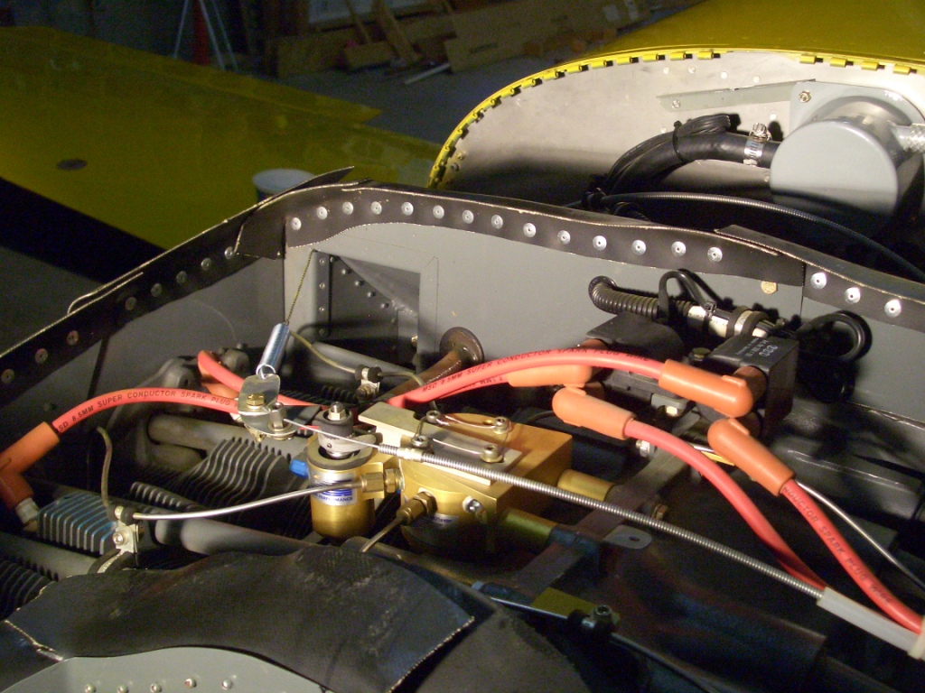

PostPosted: Sun May 11, 2014 8:32 am    Post subject: Airflow Performance Purge Valve Fitted to RV-10 Reply with quote
I did the same on the 8A. The purge valve itself has a spring but I added another to make sure. Photo attached. As someone else has pointed out you can easily get by without a purge valve. In 11 years I used this perhaps half a dozen times for hot day, hot start situation. It does work. The return is plumbed to the left tank so when purging you select the left tank for fuel. The purge valve is also used for each engine shutdown. This ports the pressurized fuel in the spider to the tank to reduce the amount left to gravity drain.
Standard cables like these work well: http://www.aircraftspruce.com/categories/aircraft_parts/ap/menus/ap/controls_00carb.html
Or: http://vansaircraft.com/cgi-bin/store.cgi?ident=1399824452-324-42&browse=controls&product=bowden
On the photo note that this was the first two years or so of flying – before the multiple hard LightSpeed ignition failures. The LightSpeeds are long gone and the plane is doing just fine at 400 hours on dual p-Mags. I’m still holding my breath (like many) for Brad to ship the 6 cylinder p-Mags for the RV-10.

PostPosted: Sun May 11, 2014 10:11 am    Post subject: Re: Airflow Performance Purge Valve Fitted to RV-10 Reply with quote
I started out with the same setup that Carl shows in his photo i.e. simple wire push-pull cable and B nut, plus return spring. In talking with Don Rivera at Airflow Performance, he made it clear he was not a fan of that arrangement, since failure has the potential to shut down the engine. He prefers a more robust push-pull cable with threaded ends and a clevis fitting in place of the B nut.
