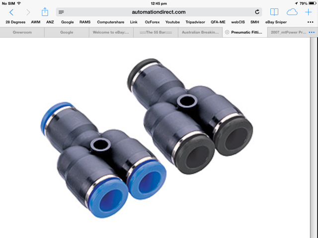

Gidday,
I am considering how I will quick connect my pitot dynamic and static tubes from my wing root to the fuselage and am considering quick connects/disconnects. In the process of this investigation, I have wondered whether I could take a rear fuselage "internal" static pressure as well as the pitot, in case hypothetically it ever got blocked, but without any switching, just melding the two. I would think the worst case would be where cabin static could create a false reading on a rapid climb out, where the static could lag due to a greater pressure from an internal contribution, which would indicate you are flying slower than you actually are, which is safe. Seems to me since most light a/c leak like sieves, and our rear fuselage more so because of flap drive slots into wing root close out voids, that I could use this to my advantage.
Comments??
Tony Renshaw
P.S. I was inspired by these fittings:
Sent from my iPad

| Quote: | Gidday, I am considering how I will quick connect my pitot dynamic
I use the ones in your picture, but not for quick disconnects. I think
they are not really suitable for repeatable connections and they are
sometimes difficult to let go.

Hi Fran's,
I expect the pressure in the aft fuselage might be more representative than cockpit pressure, which is why my plan was to pick it up back behind the baggage bay, near the flap cross tube. I have wondered about plumbing a standby pitot static to the cockpit, but have wondered if I can make it a split system static. We have a similar system with multiple statics for the one system on bigger aircraft, albeit they measure ambient, for obvious reasons.
These fittings do work well though in my superficial testing, and leak of static from the fitting is a bit of an irrelevance, since we are talking about more a static equalization pressure tube more than anything. Believe it or not I have this Nylaflow? Tubing, the hard walled opaque stuff from ACS, and it makes an excellent push to fit. I am tempted to use the 3/8" OD inside a 3/8" ID joiner, and just push them together. Very un-aviation, but if you've ever done it, you'll appreciate how hard they are to pull apart, and no vibration is going to do it.
Tony Renshaw

Hi Tony
Have a look at Winter connectors that I am using at instrument module, also see the pneumatic switches I am using for switch between static and cockpit and switch between static and TE for variometer:
http://www.europaowners.org/main.php?g2_itemId=27305&g2_page=2
Also have a look at my mutilated Winter connector, Sermos (very close to Anderson power pole modular connectors) connector and plastic buckle that melded into a one connector solution for wing to fuse:
http://www.europaowners.org/main.php?g2_itemId=86942
Ron Parigoris

| Quote: | Believe it or not I have this Nylaflow? Tubing, the hard walled
going to do it.
I have used this equipment to plumb my entire pitot/static system.
Only for the wing to fuselage connection I use the "official" quick
(dis)connect fittings. I agree that it is great stuff.
Frans
> going to do it.
