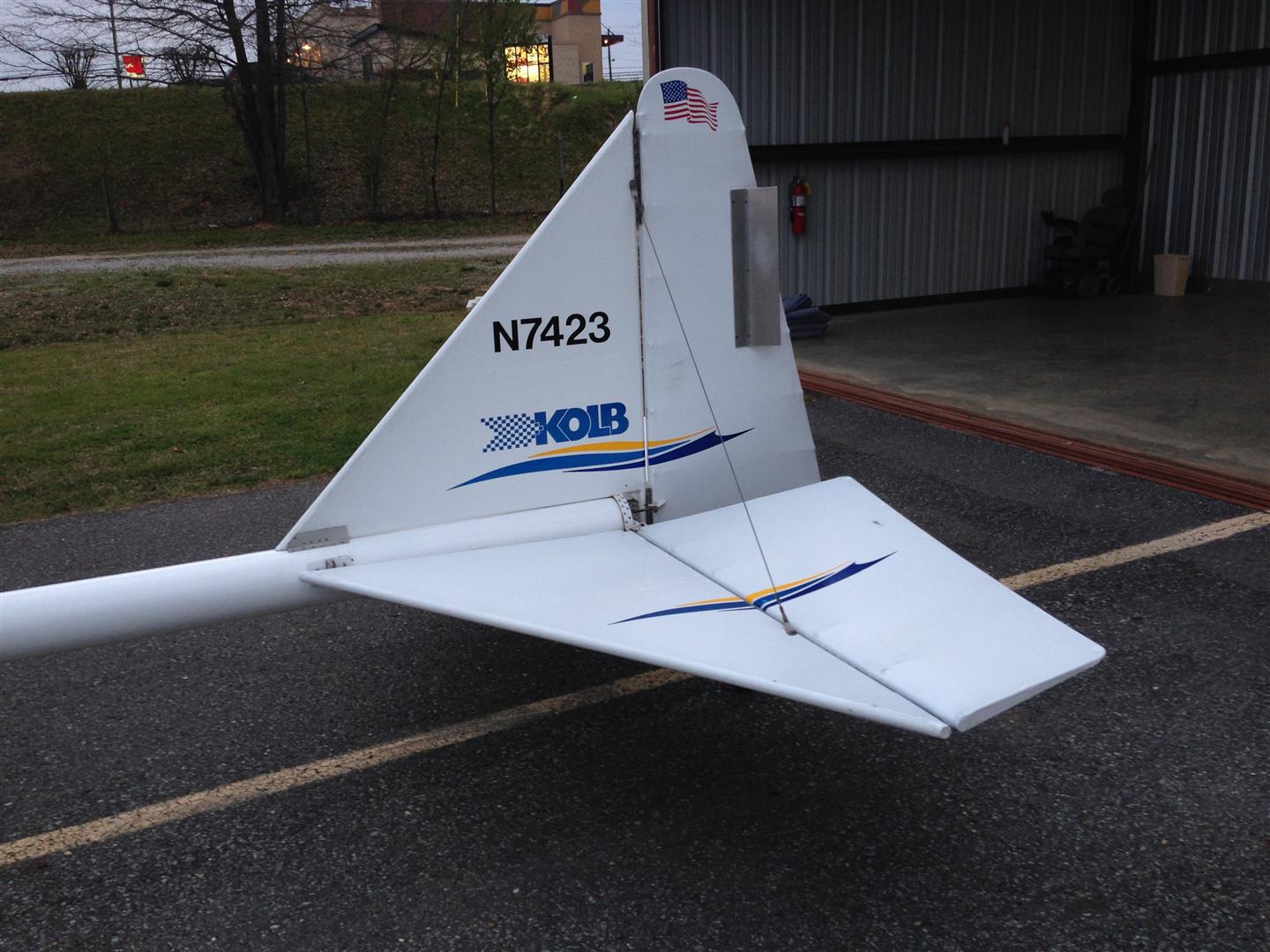

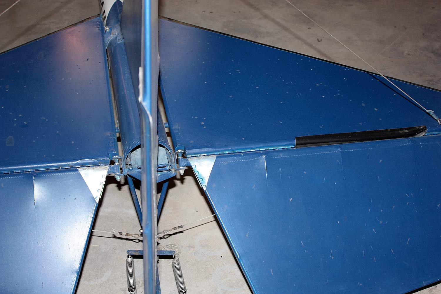

I have a Kolb Kolbra and I am needing some advice on how to change the rigging of the flight controls. I am having to hold a good deal of right rudder in straight and level flight to get the ball centered. I do have a substantial trim tab on the rudder. What can be done to correct this problem? I would like for the plane to fly straight hands off. Is that too much to ask?

PostPosted: Sun Apr 27, 2014 8:01 am    Post subject: Uncoordinated flight help! Reply with quote
it might not be too much to ask... but your results may vary....... when I
looked at your photo... I saw your trim tab on the side of the rudder.....
I am not an aerospace engineer,,, but in my humble opinion the trim tab as
installed is working more as a spoiler, creating quite a bit of drag behind
the tab and not deflecting the rudder as you would want........ in my
humble opinion,, the trim tab would be more effective if it were installed
so the bend was just behind the trailing edge. this way it could become
part of the airfoil...
boyd young
much to ask?

That does make sense. I am just trying to work out all the bugs on this airplane that the previous owner neglected. Thanks for the reply.

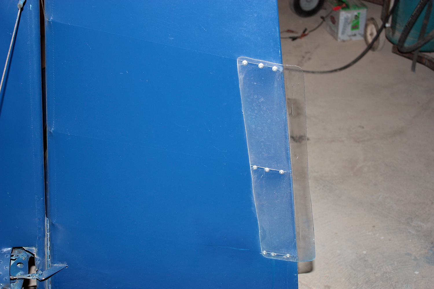

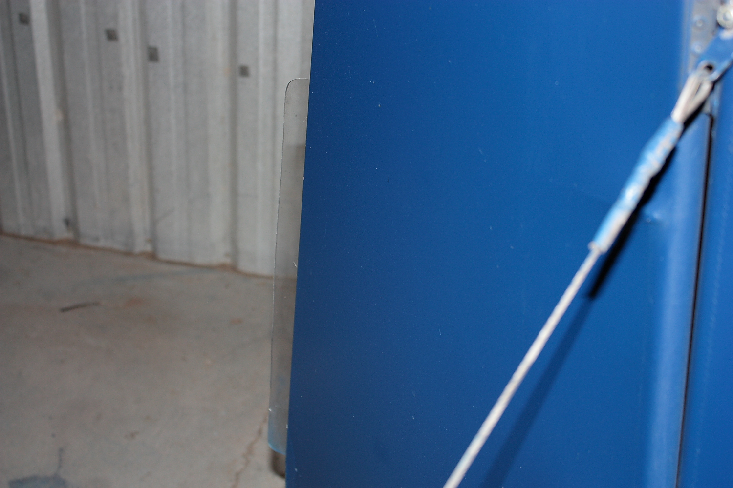

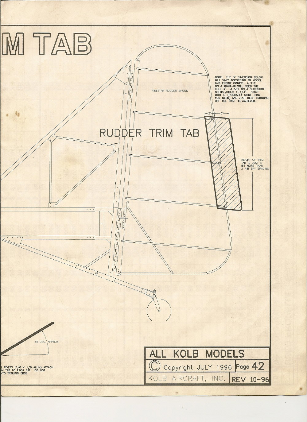

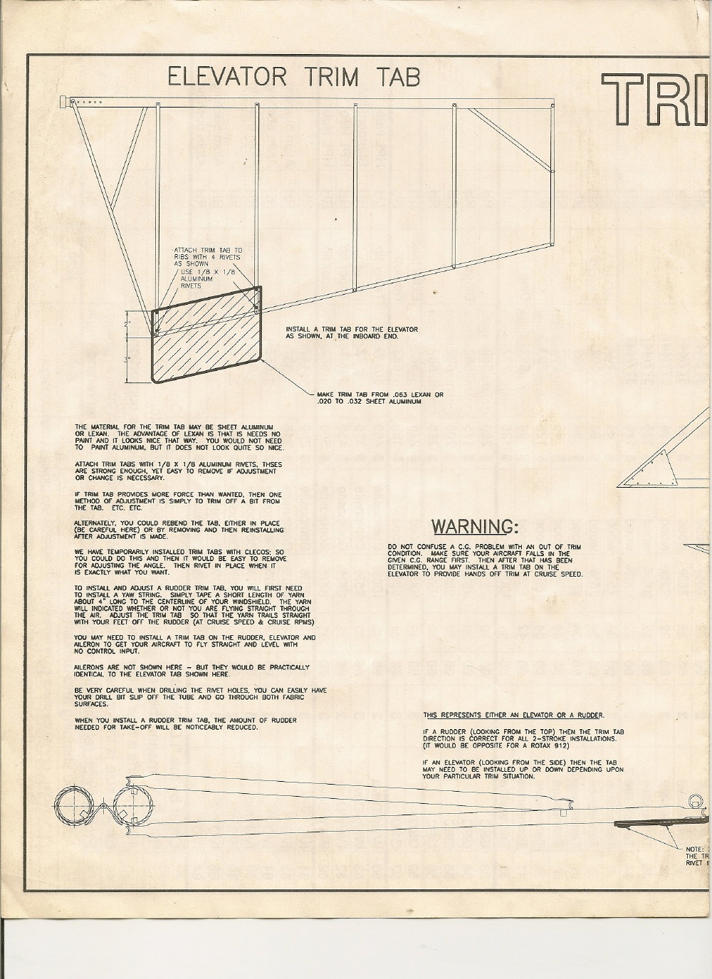

All of the previous comments apply, and they better explain your possible fix. My purpose is to show you what I have to counter trim issues with mine, perhaps there will be something there that will help you with your problem.
If you use lexan for your trim tab, it helps with the visibility problem that yours has. I put a much bigger one than I needed and trimmed it down, 1/4 inch at a time with tin snips, until it did no more than was needed to keep the plane flying straight. Lexan can be bent cold with no problem. I used a 2x4 and cut a kerf in it deep enough to get the bend that I needed. Wood does not scratch it. If you have access to a "brake" then protect it with cardboard and you will have something that will better blend in with your paint color.
Larry

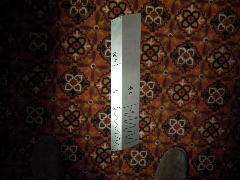

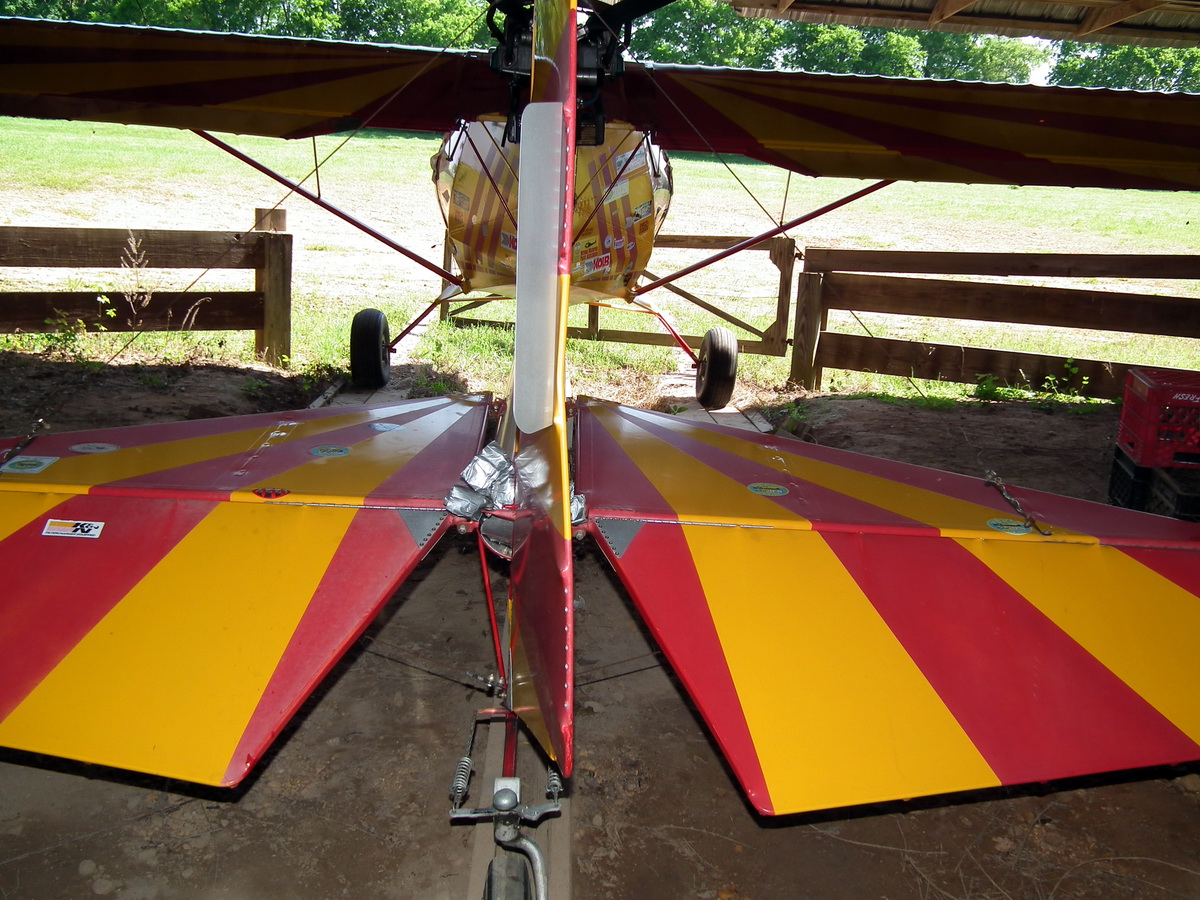

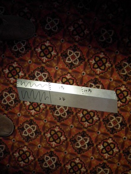

A lot of great information here. I think that I will take the trim tab off
and start from scratch. My problem is not a roll problem. Just yaw.
Adam C/Kolbers:
Looks like the trim tab is on the left side of your rudder. I am assuming
the prop turns counterclockwise as seen from the rear facing forward. This
would be the same rotation as a 912. I don't know what engine you have.
Don't think that is important, but direction of rotation is.
There is a photo attached that shows my trim tab on my MKIII. The size and
angle centers the ball on my slip/skid indicator, feet off the pedals, at
cruise (80 mph) and most other airspeeds.
The other two photos are of an experimental trim tab that I tested and did
not use. However, the dimensions are what I have installed. The squiggly
lines indicate the bottom 1/3 I removed after discovering I had too much
trim tab initially.
The part that rivets to the rudder ribs is 1 7/8" wide. I used 1/8"
aluminum fabric rivets to attach the trim tab.
The angle is about 30 degrees and the trailing edge is 3 1/8" wide.
Total length is 14".
I have done a lot of experimenting with my MKIII over the past 22 years.
Rudder trim tabs is one of them. Finally, found the cure for my airplane,
and this is it.
Adverse yaw during cruise flight is caused, primarily, by the way the prop
wash strikes the vertical stabilizer, upper and lower, the rudder, and the
horizontal stabilizer.
It is not necessary to tuft the tail surfaces to find out what is happening
back there during flight. If you over fill the oil tank or fly in rough
air, there'll be enough oil mist hit the tail section to know right where
the prop wash is going. Prop wash does not come straight back from the
prop, but has tremendous twist, much like a tornado. This is what is
constantly hitting the tail surfaces, primarily the left side of the
vertical stab and the top of the left horizontal stab.
When mounting the rudder trim tab, insure the bend is in line with the
trailing edge of the rudder. Also insure the bottom of the trim tab is
clear of the inboard end of the elevator when the stick is full aft.
The above did not happen overnight. It took a lot of flying over the years
to nail down what the best fix would be.
This is how I did it. Not recommending anyone else do it my way.

Adam
You may have a hard-to-diagnose problem, but you've also got a lot of advice.
I would certainly take off the trim tab and all other 'fixes' and fly it to see what the basic problem is. Then add things one at a time & fly it again
And good luck
Russ K
On Apr 27, 2014, at 2:17 PM, Adam Canterbury wrote:
A lot of great information here. I think that I will take the trim tab off and start from scratch. My problem is not a roll problem. Just yaw.
http://forums.matronics.com/viewtopic.php?p=422467#422467

 Which brings up a point.  Duct tape works greatduring the initial testing of trim tabs on aileron, elevator, and rudder, until it is determined what size and where you place them permanently, if atall.
I used "cleeko's" for mine. Worked well with no sitckey residue.

I think I would be well suited to model a new trim tab like yours and go
from there. Thanks so much!
Adam C/Kolbers:
The latest edition of the Kolb Extra wanted to fly right wing low during
initial flight testing.  Was the weirdest feeling I have ever had in an
airplane.  It did not want to continue to roll right once it got into its
right wing low position.  Could not wait to land and try to figure out what
was going on.  Taped a trim tab on the rudder and she flew straight and
level the next flight.  Which brings up a point.  Duct tape works great
all.
Getting the Kolb trimmed out works best making no more than one change at a
time.
All MKIII's I am aware of have adverse yaw and require a rudder trim tab to
correct.

PostPosted: Mon Apr 28, 2014 7:42 am    Post subject: Uncoordinated flight help! Reply with quote
On 4/28/2014 6:01 AM, racerjerry wrote:
You might want to identify the source of your problem before applying band-aids. See if you can borrow a digital protractor to check the wings for mounting at different angles, but also for wing twist along the span. Tape the protractor to a straight furring strip (1 x 2) that will span the leading and trailing edges of the wing and run it along the underside of the wing to see how much variation you have. Digital protractors are accurate to one tenth of a degree and also you can zero them at any point to make readings / comparison extremely easy. Nothing is perfect, but corrections are much better made after you identify the source of the problem.
I hate to say this, but if you purchase a digital protractor from a home store that has a liberal return policy…
Well, the darned things work so well that you will probably want to keep it anyway.
Jerry King

PostPosted: Mon Apr 28, 2014 8:47 am    Post subject: Uncoordinated flight help! Reply with quote
Adam C/Kolbers:
Keep it simple.
If it was my airplane, I'd pull off the incorrectly attached rudder trim tab.
Flight test the Kolbra without the tab, then tape on a tab in the correct position. Continue to adjust the tab and flight test until happy as a lark the adverse yaw problem has flown away. Wink
I would not concern myself with "rerigging" the airplane until I eliminated the adverse yaw.

Adam, Attached is the Kolb factory trim tab drawing.
Rick Girard

PostPosted: Wed Apr 30, 2014 4:12 pm    Post subject: Uncoordinated flight help! Reply with quote
Rick G/Kolbers:
I'll be darn.  That factory trim tab looks just like the one I posted a few days ago.
Rick Girard

PostPosted: Wed Apr 30, 2014 7:30 pm    Post subject: Uncoordinated flight help! Reply with quote
John, I took the tab off "The Plane from Hell" and tried to fly it. It was okay, if you like flying sideways or getting a big cramp in your left leg trying to make the airplane fly straight. Put it back per the Kolb plans and the aircraft was once again easy to fly and keep the yaw string centered. I only wish I'd been able to put my engine on it and test that configuration.
Rick
