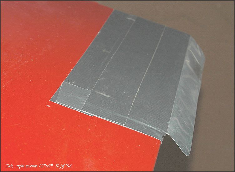

Have had to hold right stick (initial flight about dislocated right shoulder and elbow) and a bit of rudder and right wing continues to want to rise. Flaps and ailerons are fairly close to level with underside of wing. Tried four-inch wide aluminum tab and slight relief, but this said to be '91 Mark III Classic certainly hasn't flown hands off since last person may have tried it.
Haven't been up with this tab, yet. Further ideas?

PostPosted: Fri Jun 23, 2006 4:55 pm    Post subject: still fighting Reply with quote
John, that is quite a tab. First I would level the cabin and
check/compare wing
incidences. Then check tailplane (horizonal stab) incidence
differential.
If only off a little I would go with the TNK offset universal.
-Anybody know what they get for them? $$$?

jflan(at)zianet.com
PostPosted: Fri Jun 23, 2006 6:21 pm    Post subject: still fighting Reply with quote
First, thanks. Appreciate the good feedback I've had. Here's what we did and
realized today had skipped putting protractor under horizontal stabilizer
(flying wires don't twang like my friends Kolb Ultarstar II...more base,
while his are treble, but left and right not far apart). I had been tweaking
for a week or more, trying different approaches, then went back to basics
as level as possible, since dropping left flap had produced 5 or more mph
less indicated at same rpms.
We set boom at 0 degrees with protractor and then checked angle under wings.
Both were 10.3 degrees or at least within a degree of each other.
Then leveled stick and measured slope under wings
Left aileron 13 degrees.
Left flap 14.5 degrees
Right aileron 13.5 degrees
Right flap 12 degrees
The pipes controlling flaps and ailerons were last measurements:
Left 22.5 degrees
Right 21 degrees.
The four inch length tab with about two extended aft and bent about 15
degrees helped, but stick was still needed to keep it near level in flight.
Still feels like yawing. Replaced the aileron tab with 12" length and have
not flown. Not a good morning. Today, hopefully monsoons will start here in
the drought-stricken Southwest.
jsf
