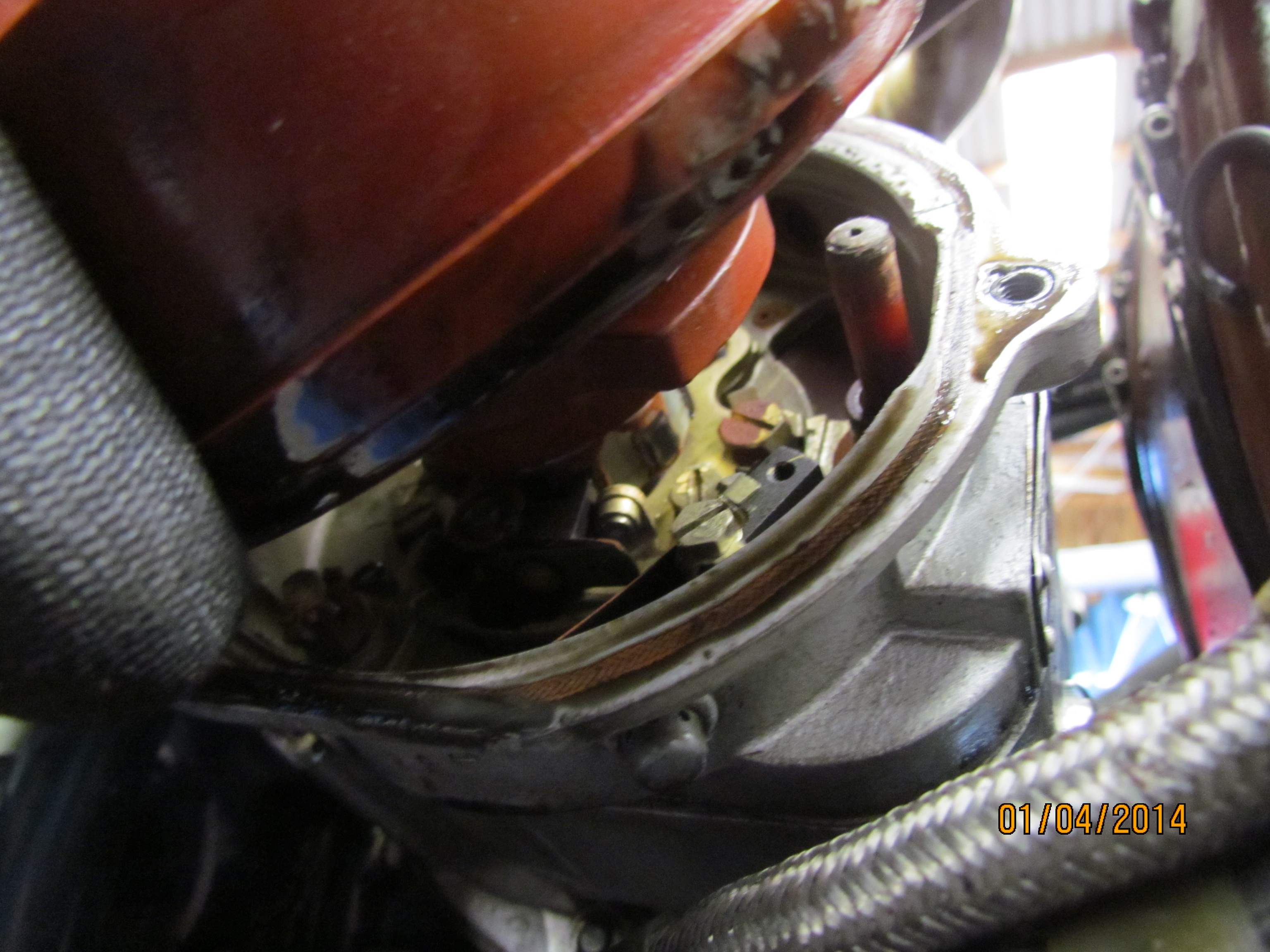

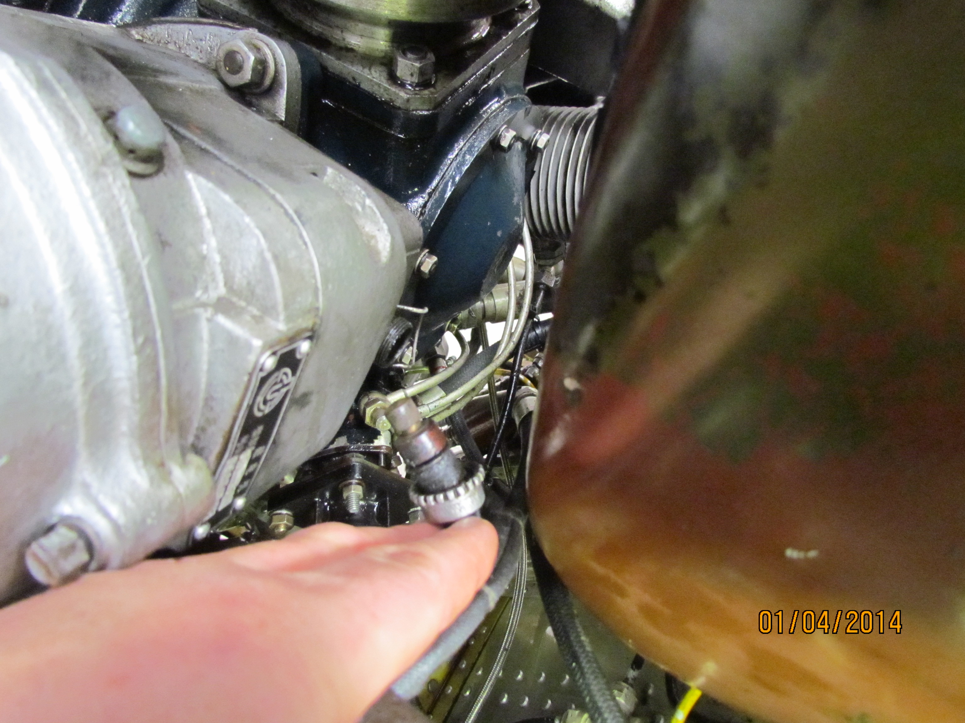

PostPosted: Tue Apr 01, 2014 10:36 am    Post subject: Re: Magneto failure Reply with quote
hello every body,
here are the pictures from today.
I ve checked the connector at the bottom and the back of the mag, i ve opened the cap but can't access to the rotor (wire to short) and i saw the ht stick but dont removed ...
which one is the mag 1 ? the left or the right when you seat inside???

PostPosted: Tue Apr 01, 2014 10:54 am    Post subject: Magneto failure Reply with quote
Bruno,
Did you remove the 4 bolts that hold the mag front cover plate to the
mag? If you did not, please remove them and the mag distributor cap
along with the front cover plate and all the wires will lift completely
off the magneto. That will expose the rotor, points and high voltage stick.
Then check the high voltage stick.
Normally, mag 1 is the left magneto (when sitting in the cockpit looking
at the engine) and mag 2 is the right mag.
Dennis

jan.mevis(at)informavia.b
PostPosted: Tue Apr 01, 2014 11:09 am    Post subject: Magneto failure Reply with quote
With all due respect, but I think that you should try and find someone who
is knowledgeable about these engines.
From the cockpit: left magneto is nr 1 (plugs on front of cylinders) and
right magneto is nr 2.
I've seen an engine where the P-leads to the mag switch were inversed. You
can check that with a multimeter.
When you open the top cover, you can lift the distribution cap, eventually
push the kabels a bit (or if absolutely necessary, remove things but that
should not be necessary).
You should be able to remove the cigarette without pulling too hard. If
not, it MAY be busted. If you force it, it WILL be busted.
At the backside, there are two screws that allow to remove the bottom
cover. From there, you have access to the coil.
It is not possible to make a diagnosis from only those pictures.
Particularly the coils: at the outside, they may seem OK (unless you find
traces of burning).
Very often, they give good sparks as long as they're not too hot
(typically after 20, 30 minutes). These mags do become quite hot when
flying, you'd be amazed.
When the distrution cap is lifted, you can check the points. Check if they
open/close properly. Check the spring on the points.
I wish you good luck, but honestly, if you've never done this before, or
if you're not really an experienced mechanic, you should try and find
someone who IS knowledgeable.
After all, it's your life that is at stake. Don't take any risks.
Ignorance kills.
Good luck,
Jan
traces of burning).
Ignorance kills.
Good luck,
Jan
On 01/04/14 20:36, "airmanv2" <bruno.blanchard2(at)gmail.com> wrote:
>hello every body,
>Best
>Bruno
>Fly safe
>Read this topic online here:
>http://forums.matronics.com/viewtopic.php?p=421465#421465
>http://forums.matronics.com//files/img_5375_292.jpg
>http://forums.matronics.com//files/img_5362_843.jpg

Bruno,
stick.
Dennis
