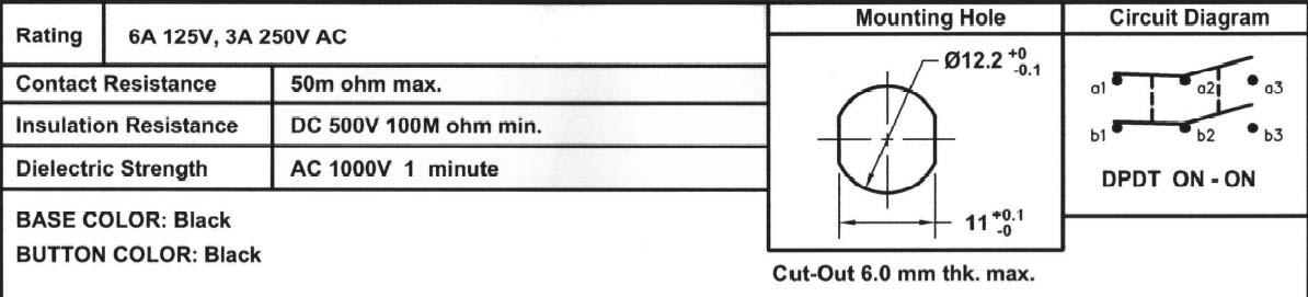

Hello,
Does anyone know how to drill a hole as indicated in this pdf?
http://switches-connectors-custom.cwind.com/Asset/GRB213B03BB.pdf
Is there a special tool? Just curious...
Carlos

There are specialized chassis punches but they cost a fortune. When faced with similar "flat sided" holes I've drilled the round hole and then backed it with a plate with a rectangular hole whose smaller dimension is the distance between the two flats and the longer dimension being the diameter of the round hole. You can also just mark the dimension on your panel and cut up to the edge with a series of smaller holes and some work with a fine file. But this is tedious and error-prone.
I find the standard bat-handled toggle switches with the small satellite hole for the tooth on the anti-rotation washer to be easier.

Large scale manufacturers would use a special hole punch or CNC machine for this but I would just use a drill with the same diameter as the distance across the flats and then file it to size with a round file.

1. Mark the hole outline with an ultra-fine marker. A pattern can help
with this.
2. Drill the center or possibly a couple of corners inside the marked
outline.
3. (For bigger holes) Cut close to outline with snips.
4. Finish cutting with a Dremel tool with "Christmas Tree" shaped high
speed cutter. Use the point area for fine adjustments and the wider
areas for quicker material removal.
5. Use hand file to finish hole - remove sharp edges and prevent loss
of blood.

Drill a 12.2 mm hole.
Or spend $100 and buy a punch...  I would just drill a 12.2 mm hole and be done with it.

Can I just add to Paul’s excellent advice. As a plans builder you will have a shed load of off-cuts and scrap so you drill three holes.
The first is in a piece of scrap and will be probably rubbish; the second will also be in a piece of scrap and will be pretty good; the third will be on your aircraft and be like the dogs dangly bits – perfect.

I think that the hole to install the switch is a normal round hole, like any other switch with a nut...
Looks that the plastic parts of the switch are the ones that have that rectangular form...

One problem is that DC is harder to switch than AC. Your switch is AC rated.
I know you are worried about hitting your head on a toggle switch, but I would be more concerned about an AC-only rated switch causing a problem in flight that could be much worse than that...

carlossa52(at)gmail.com
PostPosted: Thu Mar 13, 2014 4:25 am    Post subject: weird hole Reply with quote
Hello, Sabrina
That was just a sample I had handy to show the diagram.
There are plenty of rocker switches with the proper characteristics that I can choose from.
Carlos
