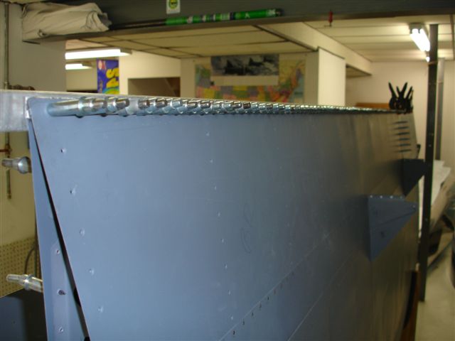

As you already know, I had rigging problems with my flaps (both of them). When I installed them on the wings, they were warped and extended below the bottom wing skin. Here's how I solved that problem with a brand new set of Flaps that I just built....and they came out perfect!

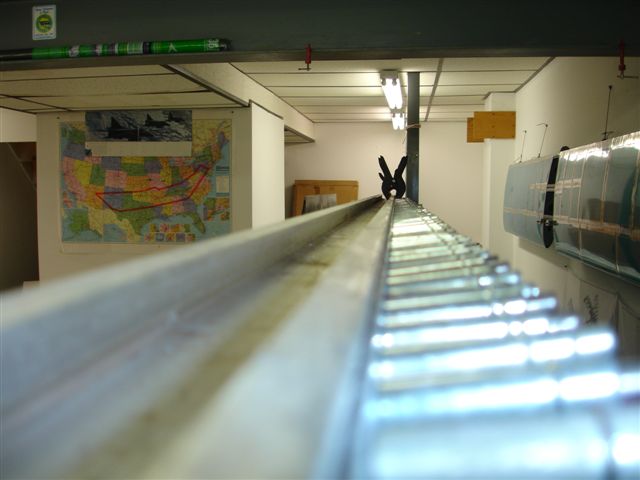

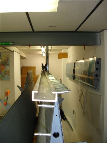

I built these new flaps according to plans up to and including riveting the top skin on. Then, I took the structure and pinned it on the wing at the 3 attach points.

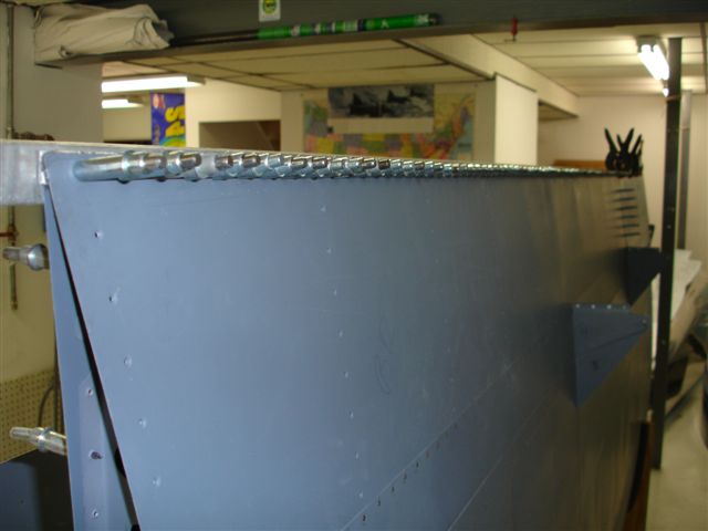

I then clecoed on the bottom flap skin and epoxied (or pro-seal if you wish) the trailing edge on with a long straight edge (see Pic #1). By doing this, you are assured 100% to be lined up with the aileron and everything in rig.

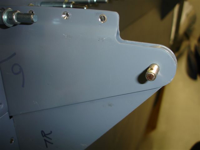

I then squeezed one rivet on each flap brace brace to keep the hinge alignment. (see next picture).

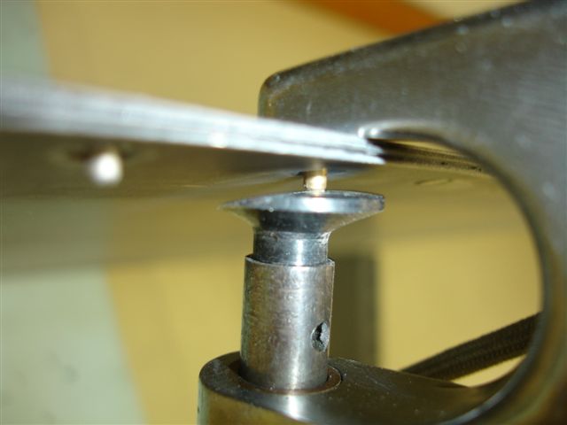

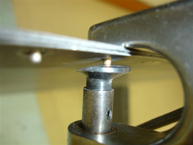

I then riveted on the trailing edge rivets to the flap, but here's the best part.....I squeezed them on. I don't know why I never tried this in the first place, maybe because Vans tells you to do it one way. But, that's the neat thing about building planes. There are many ways of doing it.

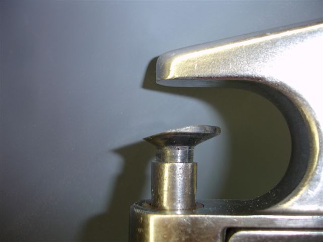

My brother made me up a wide rivet set (about the diameter of a quarter). I then ground the angle into it that represents the trailing edge angle (see next picture). Guys, I have to tell you... this is the best thing since sliced bread! I only wish I had thought of it earlier when doing the other trailing edges. And the neat part is that you don't beat up the skin with a rivet gun!
For those of you who haven't built your flaps yet, try my method. It works!!! Rigging is perfect because you align it with the wing and aileron while the epoxy/proseal is drying. And the best part, squeezing the rivets which eliminates all the possible warping you may get from back riveting.
If you don't have a wide rivet set that you can grind down, let me know and I'll see if my nephew Dave can make some sets up. It's important to have a wide set because on your intial squeeze, the rivet meets the flat part of the set. The final squeeze, the angled part of the set meets the rivet. I used a small Tatco flat C-frame for this. You can probably use another type set but need a flat on one side and the angle set on the other.
