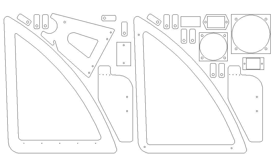

Hi all. Has anyone carried out this mod? If so could you please take a snap shot of it and add some dimension to it for me so i can forward it to my fabricator please. Many thanks Frank

Hi Frank,
I drew this up in AutoCAD LT, and sent the dxf file to a waterjet cutting company

PostPosted: Tue Feb 18, 2014 2:16 am    Post subject: Re: Mod 11354 Control lock Reply with quote
The Water jet company is:-
Precision Waterjet Limited
1 Uplyme Road Business Park
Lyme Regis
Dorset
DT7 3LS
01297 444456
sales(at)precisionwaterjet.co.uk
Phil Davis or David Bisson or Kath
www.precisionwaterjet.co.uk
They have various quality levels, based on speed of cut.
Q5 = best cut
Q4 = still OK for us
Q3 = marks now showing
Q2 = getting ropey
Q1 = lots of marks – internal bits only
Machine is accurate to =/- 0.01mm
I got various bits cut, in 1.2mm SS304 (Stainless), or 1.5mm 6082T6 (Aly)
Here is the dxf file. It includes templates for instruments.
DV ContLock DoorGuar RegPla 1.6mm v4 cutting.dxf
Download
 Filename:  DV ContLock DoorGuar RegPla 1.6mm v4 cutting.dxf
 Filesize:  99.56 KB
 Downloaded:  523 Time(s)
