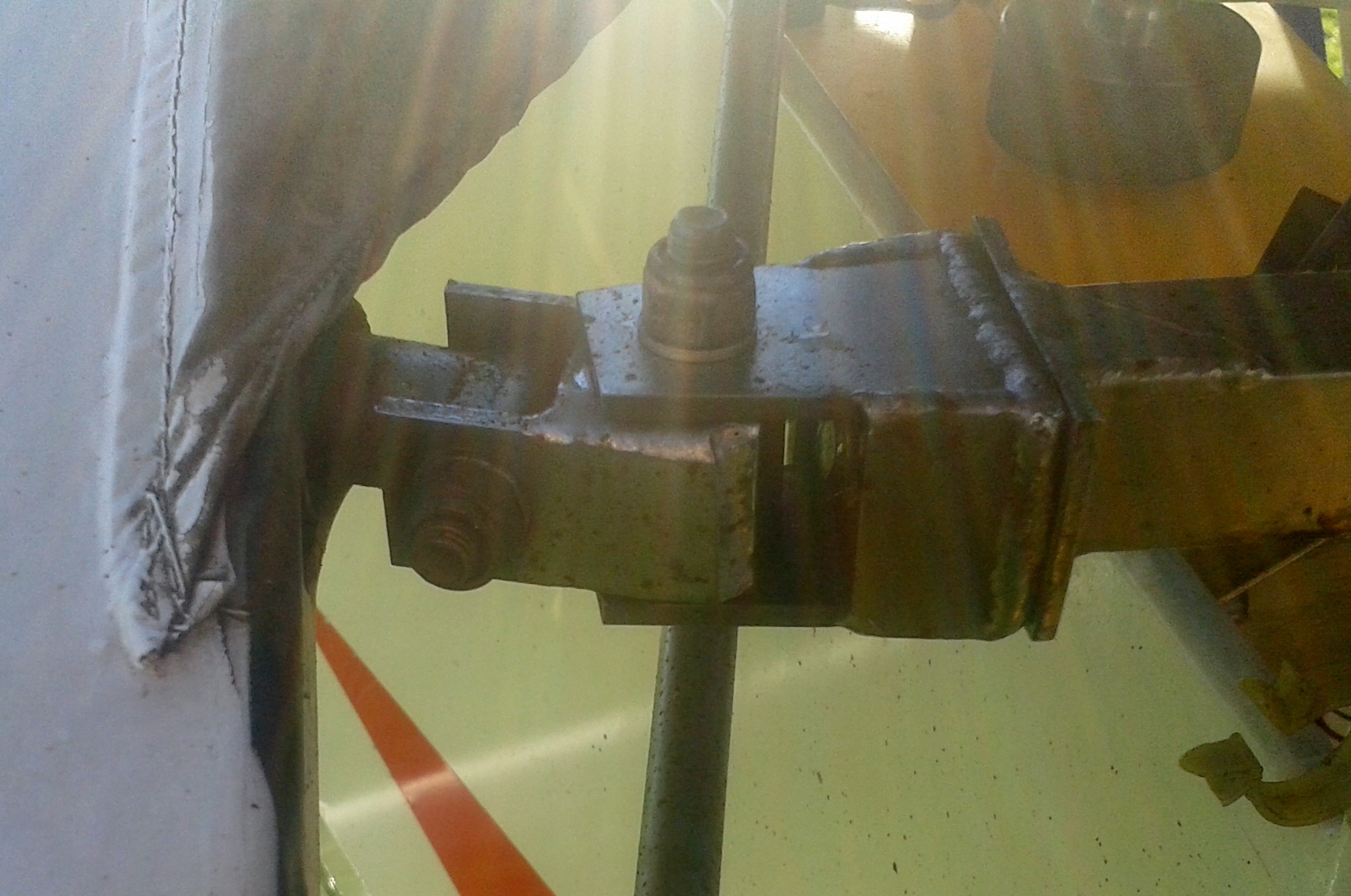

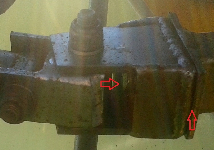

PostPosted: Mon Jan 27, 2014 11:47 am    Post subject: Re: problem firestar Reply with quote
Do you have any idea how I can remove this motion from the hole of the fork to the main pivot? Sad
 Filesize:  247.06 KB
 Viewed:  26668 Time(s)

PostPosted: Mon Jan 27, 2014 11:52 am    Post subject: problem firestar Reply with quote
It's the hole too big? On Jan 27, 2014 12:49 PM, "dany88" <danielecafaro(at)alice.it (danielecafaro(at)alice.it)> wrote:[quote] --> Kolb-List message posted by: "dany88" <danielecafaro(at)alice.it (danielecafaro(at)alice.it)>

PostPosted: Mon Jan 27, 2014 12:49 pm    Post subject: Re: problem firestar Reply with quote
the hole is slightly larger, in practice if witcher well the bolt movement disappears, but I'm afraid that by folding the wings and rub the two walls over time can cause damage

jbhart(at)onlyinternet.ne

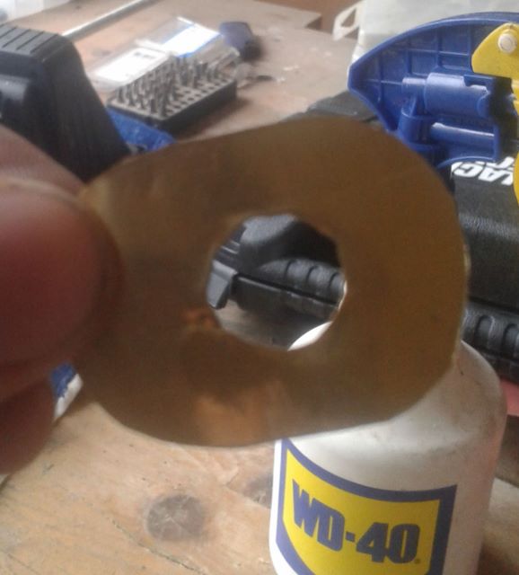

PostPosted: Mon Jan 27, 2014 4:29 pm    Post subject: problem firestar Reply with quote
Yes, I used very thin brass shim stock. This will not remove all of the
wear because the bolt and hole both wear. It is never good for steel to
wear on steel. In this case there is wear on the bolt too. The shim stock
can remove the wear from the hole but can not remove the wear from the
bolt.
That is why I proposed the second method to fix the problem. By tapering
the hole through the clevis and compressing and neoprene "O" ring, one can
compress into the wear on the bolt. In doing so the bolt and the clevis
hole do not touch and there is no further wear. The taper can easily be
formed by using a small grinding wheel mounted in a Dremel tool. See
http://www.dremel.com/en-us/tools/Pages/CategoryProducts.aspx?catid 13
If you are concerned about wear on the back side of the clevis place a thin
brass shim stock washer between the clevis and the flange on the fuselage
cage. Do not over tighten and use some thick grease lubricant on the "O"
ring and the washer.
PostPosted: Wed Jan 29, 2014 5:44 am    Post subject: problem firestar Reply with quote
Boyd,
Checked out possibilities at McMaster Carr. (http://www.mcmaster.com)
Looked at Teflon washers. Part number 95630A505, Low-Friction PTFE Flat
Washer, 1/2" Screw Size, 1.5" OD, .017"-.023" Thick Packages of 10 for
$15.71
And sheets. One side is etched for bonding with adhesive. The other side
has a smooth finish. Part number 8711K91, Sheets Made with Teflon® PTFE,
Adhesive Ready, .015" Thick, 6" x 6" $7.81 per sheet
Jack B. Hart FF004
Winchester, IN

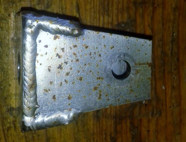

Here is a brass plate cutout thin now.

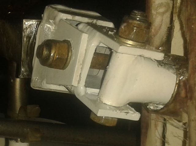

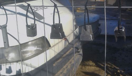

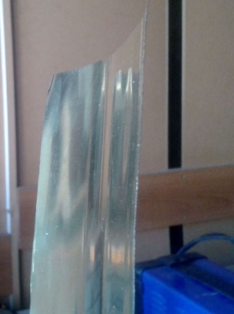

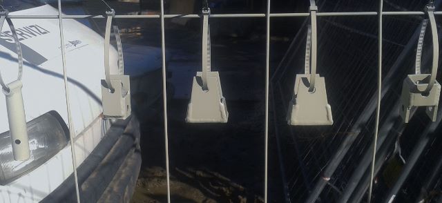

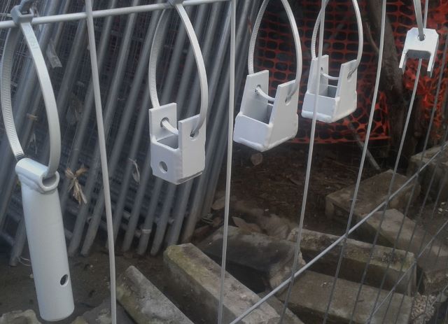

Some photos of the work done for painting
 Filesize:  50.7 KB
 Viewed:  26577 Time(s)
 Filesize:  83.1 KB
 Filesize:  51.25 KB
 Filesize:  54.05 KB
 Filesize:  78.49 KB
PostPosted: Wed Jan 29, 2014 11:37 am    Post subject: problem Firestar Reply with quote
John,
I do not believe Homer Kolb intended one to tighten the wing universal
assembly bolts after one unfolds the wing prior to flying as you do.
At 200+ hours mine were very loose and worn. I repaired them so that I can
fold the wing as Homer intended without using a wrench to untighten bolts.
Jack B. Hart FF004
Winchester, IN
At 09:55 AM 1/29/2014 -0600, you wrote:
Kolbers:
I don't think Homer Kolb intended anything between the universal and the
airframe, especially paint, plastic washers, and "o" rings, especially
paint. The end of the universal should be clean as well as the contact
point on the airframe, with a light coat of grease to prevent rust and
assist in rotation during wing fold.
I personally would not use plastic or rubber to snug up these connections.
My personal opinion only. Don't recommend anyone else doing it the way I
did, but my way has proven to work well over many hours and many years.
dany88
Joined: 13 Jan 2014
Posts: 25
PostPosted: Thu Jan 30, 2014 6:24 am    Post subject: Re: problem firestar Reply with quote
Work performed perfectly, the joint is not more movement, as you can see from this video http://youtu.be/AHbFpa_Q9NQ
I am attaching a few pictures

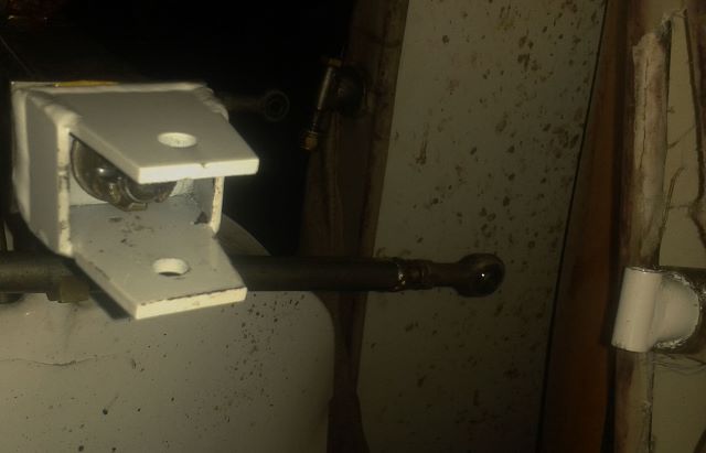

PostPosted: Thu Jan 30, 2014 6:36 am    Post subject: Re: problem firestar Reply with quote

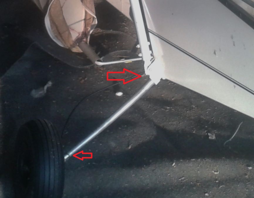

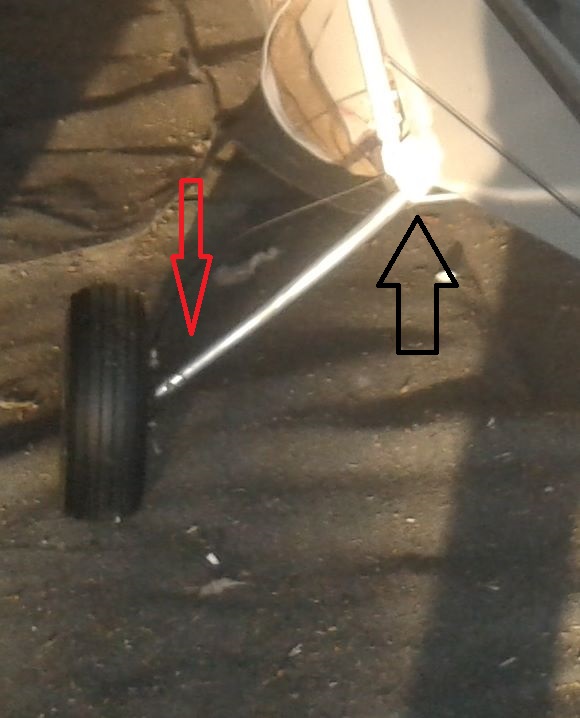

How do I replace the main landing gear?
I unscrewed the bolt near the hub and the bolt inside the fuselage, but not sfilla the bar of aluminum.
Why?
how can I do?
I enclose a photo
