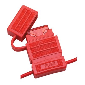

An if you have both space and desire to panel
mount some fuse holders, these are one option
of several . . .
You can acquire the holder above or the one below
from a local car-parts store. The one below uses
the plastic ATC style fuse and would tie into the
wire bundles behind the panel.
[img]cid:.0[/img]
You probably wont find an ATC1 fuse in the
car parts store but an ATC3 or 5 is fine.
