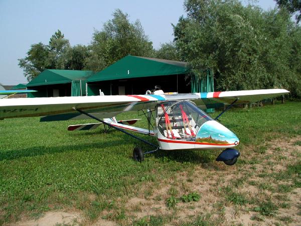

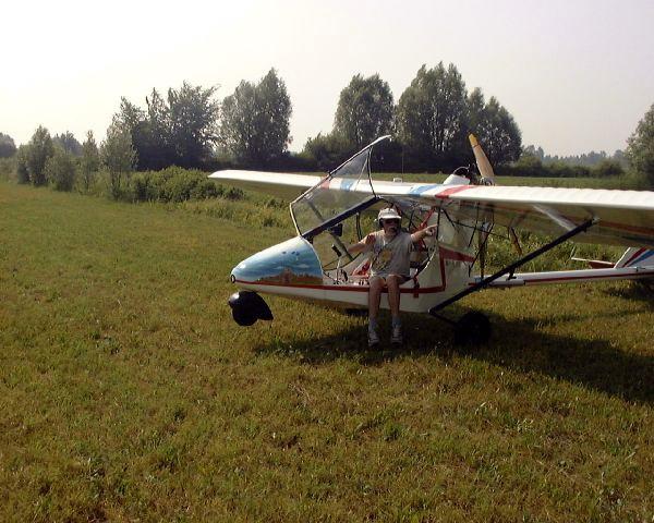

hello everyone.
are Daniele from Italy.
Should I buy this plane in Italy kolb mark 3 of 1995 I wanted some more information on the reliability and safety in flight, from someone who usa.Dal my point of view is doing research seems like a good aircraft, seeing the structure of 'wing seems robust, then the fact that the wings are closed again for me would be an advantage.
According to you flying in windy conditions even slightly accentuated and safe? Maneuver it well? I send you a picture.
do you think you can turn into bicyclo how did the original?
Even the doors and can turn gullwing?
in practice all the information you can give me.
one last thing a kolb the property after all these years, after having made ​​a good maintenance when it lasts over time?
sorry for writing but I'm writing tramitte translator.
thanks

Here are some answers for you:
The airplane is very sturdy and handles turbulence well.
It is easy to modify how the doors attach. If Italy law permits, it will be easy to change.
You ask about modifying to conventional landing gear arrangement -
Please send us a close up picture of how the gear exits the fuselage.
Without more information on the present main landing gear, it is difficult to answer.
The present landing gear might be something you would like to keep using.
However, looking at your picture, it appears that the fuselage is lower to the ground than normal.
The distance from the landing gear socket to the ground should be at least 14.5 inches with the tail wheel on the ground.
With an insufficient angle, you will not have the proper flight attitude when taking off or landing.
The aircraft is easy to maintain with little expense. Expense would depend on which engine you are using.

Am I looking at that picture right? My eyes are getting old but it looks like that is setup as a trike gear but the picture isn't that clear. I haven't seen that before on a MKIII.

And the tail is modified for higher rotation clearance. Hence there is no fin or ruder beneath the tail boom. Hardly a Kolb anymore. But probably still a solid flyer. No way for us to know the quality of the build without being able to touch and inspect it,
Buyer beware.

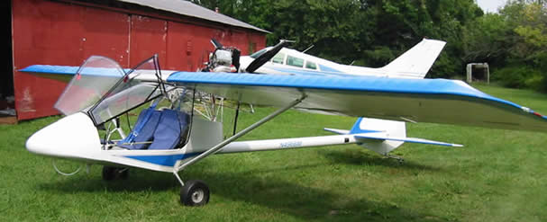

Tri gear... is that a Ferguson rather than a Kolb? Isn't a Ferguson basically a Kolb copy with tri gear? Or perhaps it's a Kolb modified with Ferguson parts. Then you have to wonder how well the conversion was engineered...

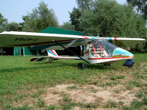

However, I can turn it like this?

Dana, I think you may have hit it.
http://siamesekrazy.wix.com/fergusonaircraft
Daniele - are you sure that the airplane you are looking at is a Kolb?
Because it looks a lot like a Ferguson.

Richard, comparing the picture he sent first it looks like a Kolb tail feathers. Horizontial stabalizer front attachment point mounted to the tailboom. Not like the Fergy.

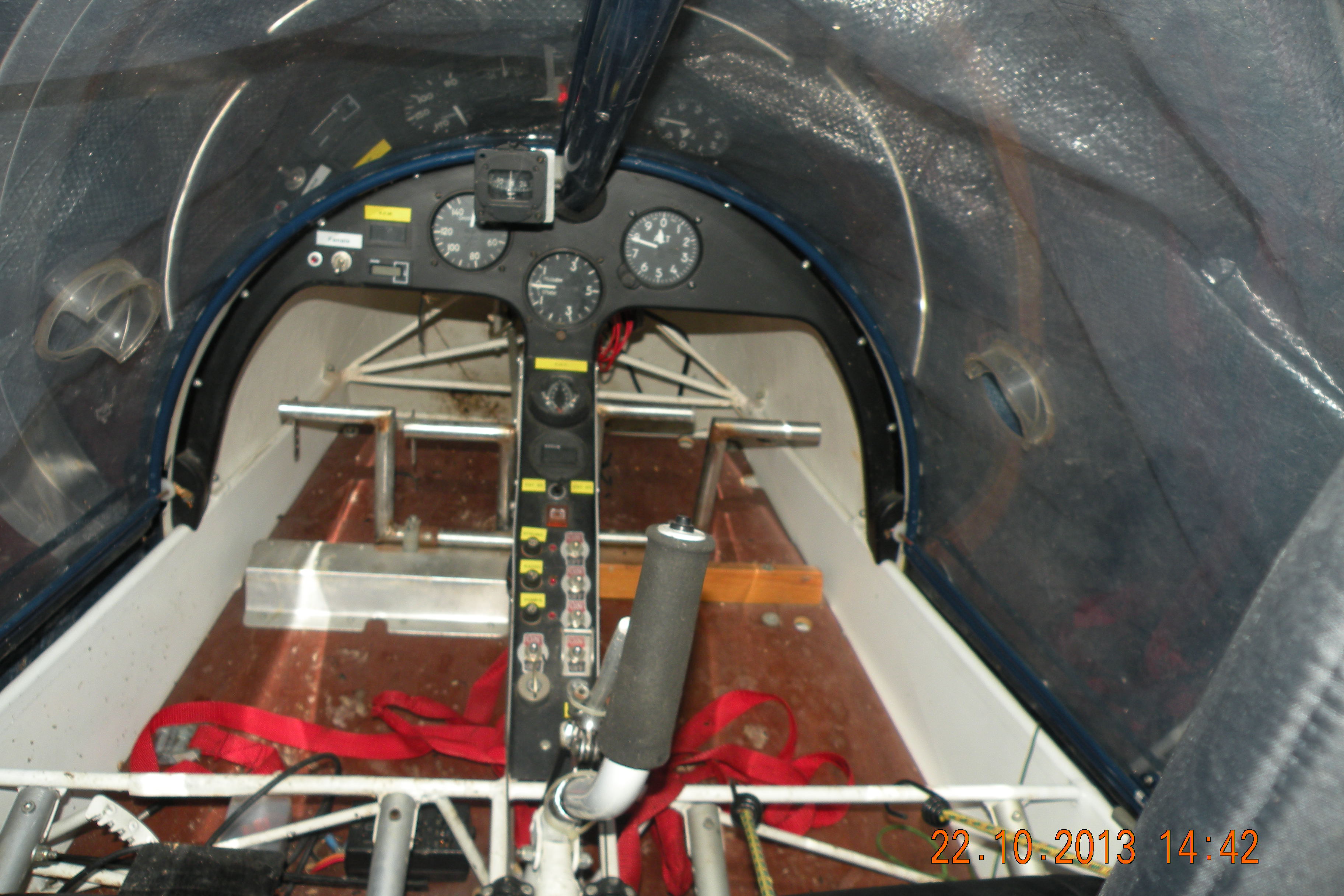

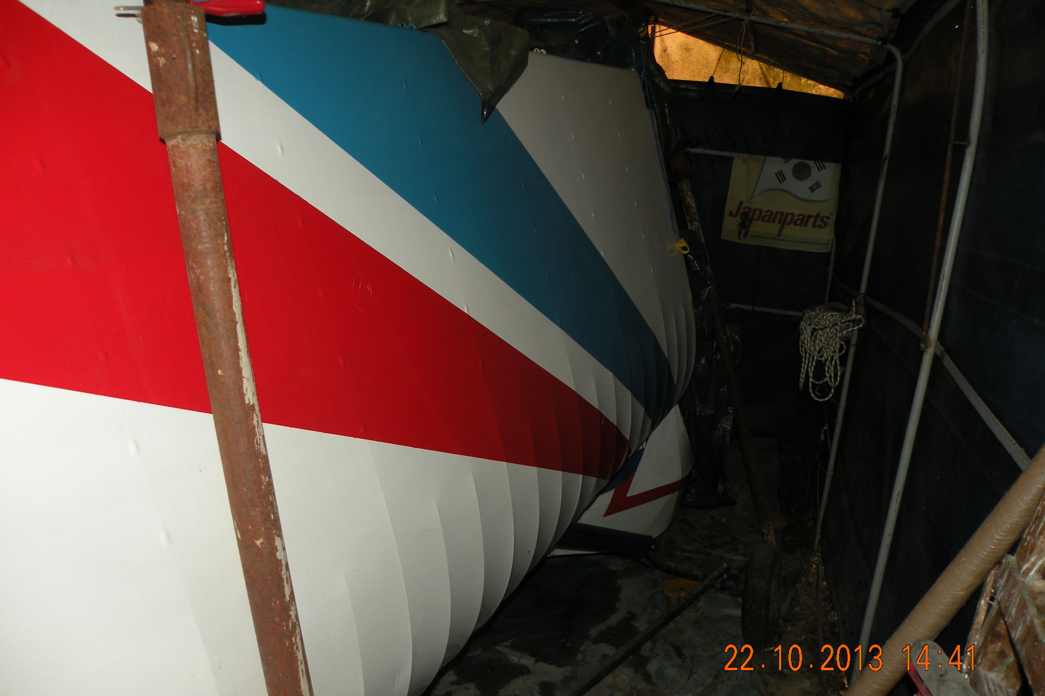

The owner has confirmed to me that it is a kolb mark the three. From the photos it does not seem fergusona. The owner told me that when it was built object to the amendment made ​​to the three axes, because he did not like the bicyclo

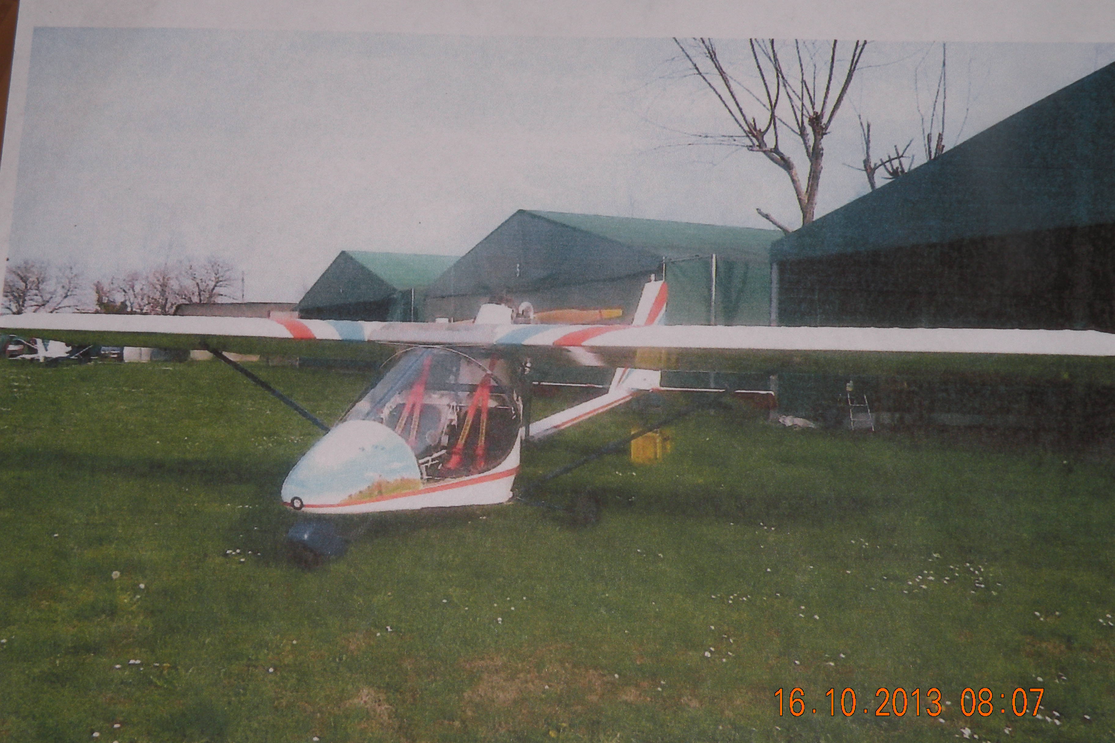

look at this picture.
Here you can see better.
the former owner.
according to you and a kolb mark 3 or not?
from the pictures it seems to you, anyway Saturday I'm going to take then you keep up to date

Very do able mods....use the original gear leg tube attach points but
angle the legs outward and backward ..add free castering nose wheel(or
maybe not?) .. and one is in business... should lengthen the take off
roll some what . Herb
the former owner.

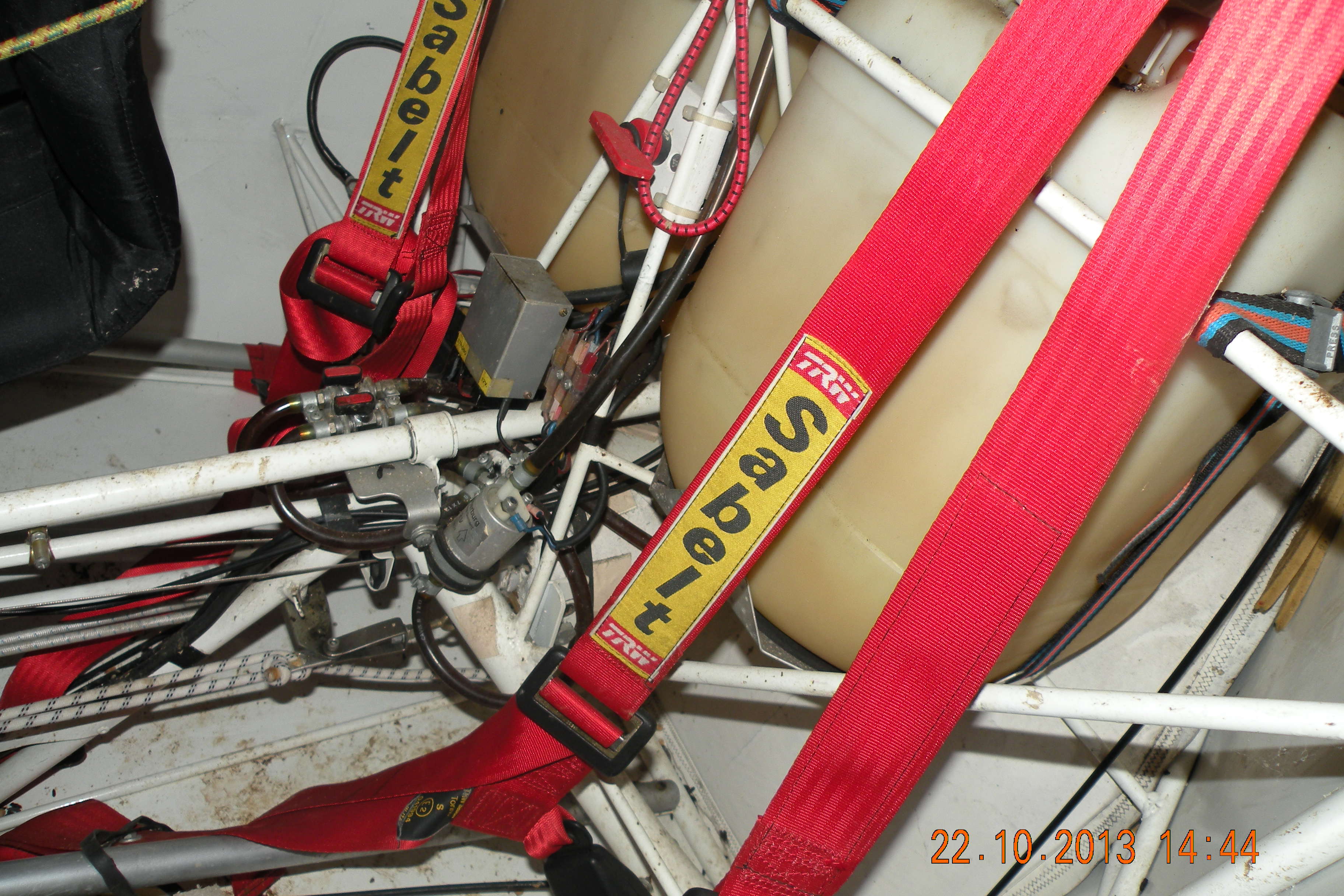

Looking at this interior picture, it appears the original gear leg tubes
were cut off of the hoop ring that fits at the forward end of the 6" fuselage tube.
Then it looks like new structure was welded up to attach the gear leg tubes
at a new angle. Assuming that if was done properly, it might be OK.
But I'm not an engineer, so I don't know..
The fuel lines in the picture are brown, obviously old.
They need to be replaced.
Suggest you use standard automotive fuel line.
Also suggest you carefully check the rest of the fuel system.
There may be other problems which are not as obvious.
