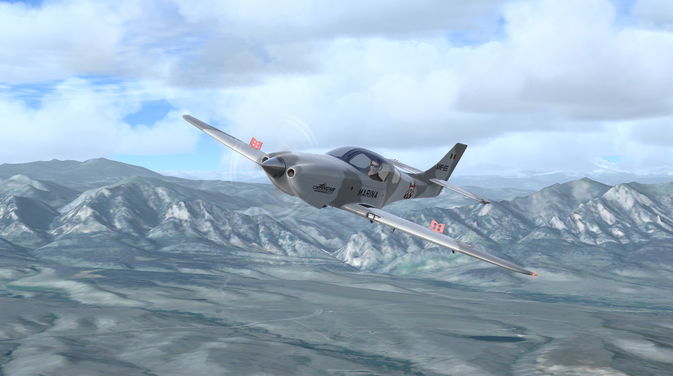

Yes, in the version used in the Legacy they scissor up from the wings – see image below...
