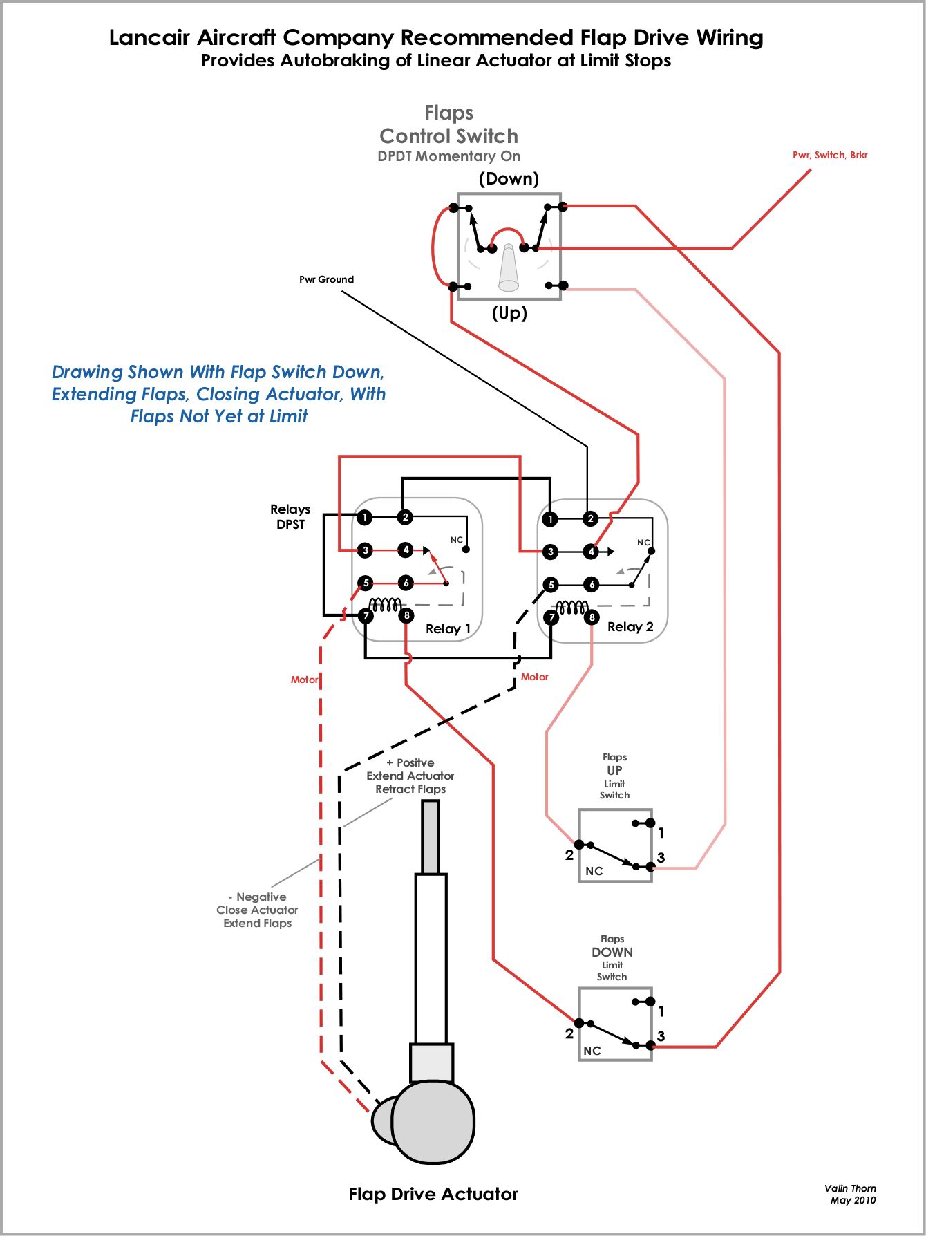

Here's more detail in what I'm trying to accomplish in trying to use the VPX and its flap control features with the motor breaking circuitry of the Lancair Legacy flap control mechanism.
The good things the VPX does for flap control is not allow deployment above the maximum flap extended speed, incremental deployment/retraction with flap momentary switch activation, and read/display its position.
The VPX controls the flap motor by changing the polarity of the outputs driving the flap motor.
The Legacy's flap control circuitry, with motor braking (grounding both sides) when not driving the motor or at its deploy and retraction limits, drives the motor in different direction at the flap switch (DPDT (Retract) Off (Deploy)) with the positive electrical connection to both the retract and deploy circuits. See attachment. This is much the way Bob N. showed how to do it where he was switching the ground.
So it seems that with the VPS sending out motor commands just directly changing the polarity that it could be hooked up to a Relay replacing the manual flap switch function DPDT (On) Off (On). But as some have pointed out, there's apparently no such animal.
I'm not sure how to take the changing flap control polarity coming out of the VPX and set up two relays to achieve the same result in the Lancair wiring of the DPDT flap control switch. I'm at novice at this but will think about it some more tomorrow. If anyone can suggest a specific solution to this interesting challenge I’d sure appreciate it.
Lancair Legacy Flap Control Circuit Design with Motor Braking
