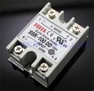

Yes . . . but take care that you get a DC/DC
device . . . they LOOK just like the DC/AC.
[img]cid:7.1.0.9.0.20131223113822.02165410(at)aeroelectric.com.0[/img]
Note the 5-60vdc rating on the output terminals
of this one.
I've ordered one of these to ponder and
perhaps bash on a bit . . .
http://tinyurl.com/l73b6lf

PostPosted: Mon Dec 23, 2013 10:08 am    Post subject: Any know is there a typical faliure mode for Soild State R Reply with quote
what are the power dissipation stats on these devices? I didn't see any data on this in the EBay link...

PostPosted: Mon Dec 23, 2013 10:32 am    Post subject: Any know is there a typical faliure mode for Soild State R Reply with quote
Good catch!
Eric
On Dec 23, 2013, at 10:40 AM, "Robert L. Nuckolls, III" <nuckolls.bob(at)aeroelectric.com> wrote:
Yes . . . but take care that you get a DC/DC device . . . they LOOK just like the DC/AC.
