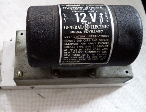

High voltage for the vacuum tubes was produced by a little
motor-generator not unlike this one:
These would take in 6, 12 or 24 volts (6v airplanes
in 1949??? maybe these radios were installed in airport
ground service vehicles too).
