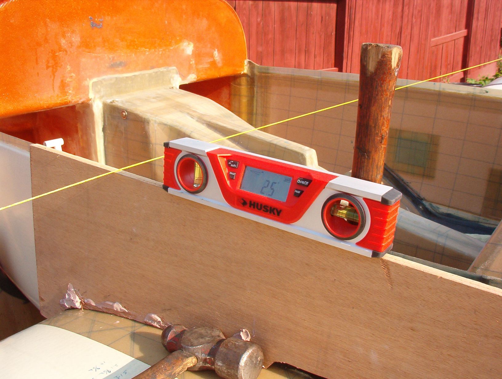

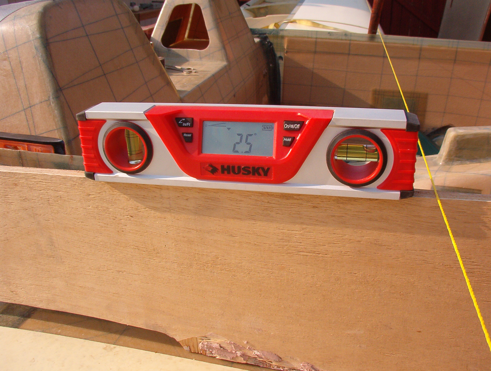

I have been trying to figure out why my airplane flies One Wing Low on the left wing.
I have tried a number of things to see if I could get the wing up. Bud suggested that I tape a couple of pencils to the opposite Aileron and that helped, but not help that much.
I have lower the flap on the left and that has helped in the cruise flight, but as soon as I slow down the wing well drop. I have attached a couple of picture showing the aileron that I need for cruise flight.
When I installed the W26A I took pictures of both wings showing 2.5 degrees. I also took picture of the string across the wings tips.
Yesterday, I took measurement of the wings using a 'T"-square. The measure show that the wing is installed very close as I also took measurement off another Europa in the hangar.
My measurements were as follows:
Left Tip F/A Root Root F/A Tip
8 ¼” 8 7/16” 8 7/8" 9 1/2" 8 1/2" 8 1/4"
F/A stand for mid wing where flaps and aileron come together.
I then took measurement from the tail plane tips to the aileron tip break out. 133” and 131 ¾” maybe 7/8”.
I took an inside measurement from the fuselage tail plane leading edge to the aileron break out of 165 7/8” and 165”
I’m thinking that I might place a shim in the left W26A and move the wing forward. The inch that it seems is out.
I’d like to hear from you your thoughts regarding what I might do to correct it.
One other thing, I weight 250lbs. I have put sand bags up to 150lbs in the right seat. It did not help with my problem.
 Filesize:  757.56 KB
 Viewed:  17764 Time(s)
 Filesize:  801.72 KB
