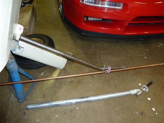

Several years ago, Kolb sold off their last set of machined, tapered gear legs for the MKIII, and I got them. Since the gear that was on the airplane was working OK, left them on the shelf for years.
Took the MKIII apart last week and put it in the garage for a major going through this winter, and since the aluminum tapered gear was a bit bent, decided it was time to try the high-class gear.
Back when I put the original gear legs on, I aligned them by getting a straight copper grounding rod from Lowe's and sticking it through the axle holes to get the alignment 0-0. Always worked good, so did the new gear the same way. Stuck the new legs in place, took a couple small bungees and strapped the same rod in place, and got everything perfectly parallel. Scribed the new legs by poking a scribe through the gear leg socket holes. (If you don't have machinist's bluing, a fresh Magic Marker works just as good)
Took it to a local machine shop and told them to make the hole start exactly at the scribed hole mark on one side, and come out exactly through the middle or the scribed hole mark on the other side.
They did it. $20.
WOOT!
Time to get to work. (Thanks, Travis!)

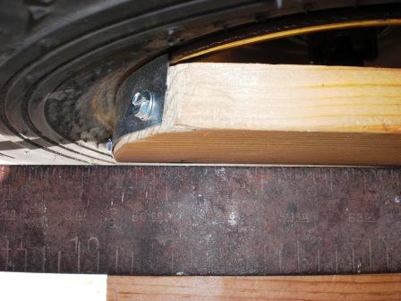

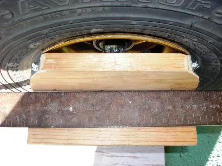

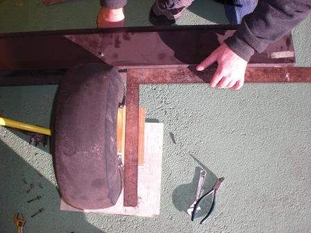

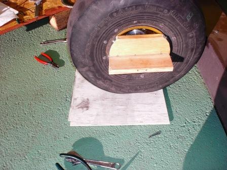

it was all the flex that caused the jackhammer ride..... I went from 2 deg, ( 1 deg per side) down to 0 deg...   and it would shake hard enough to make me think the dental work on my top teeth would end up in the bottom row.... I had to bend some toe in back in... as I remember it was around 1.2 deg total... .6 on each side. to make it ride smooth.
the way I tested was the wheels on a skid plate, an angle sheet metal across the back of both tires, and a carpenter square along the sheet metal, to the side of the wheel. check the photos. if you have any questions, let me know.
boyd

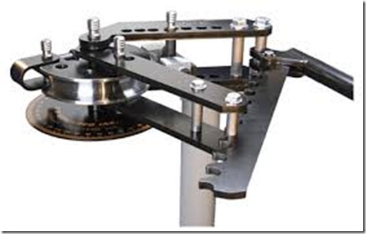

The pictures make perfect sense, thanks for that. How did you bend the gear legs a little at a time until you got the desired toe in? I have a tubing bender - or did you slip a pipe over the axles and armstrong it?
Richard Pike
I've had good luck bending with a long section of water pipe slipped over
the axle. Of course you have to support the main gear where you want to
make the correction.
Happy Thanksgiving to all the Kolbers out there. You all are a special
family of special builders and flyers.

I just visited Google and did a search on pipe benders, my son’s pipe bender looks very similar to this one, but his has two of the saw tooth ratchet arms, one arm is fixed and the other attaches to the actuating arm. they are set up so with one pull of the actuating arm you only move things one tooth,, but with the second arm... you can hold tension on the piece while you moved the primary arm to a new notch ,  then pull again. as I remember he told me that it would bend up to 1 1/2 inch solid steel rod. I cant see the fixed pointer in this photo. but it lines up just above the bottom plate marked off in degrees.
boyd
