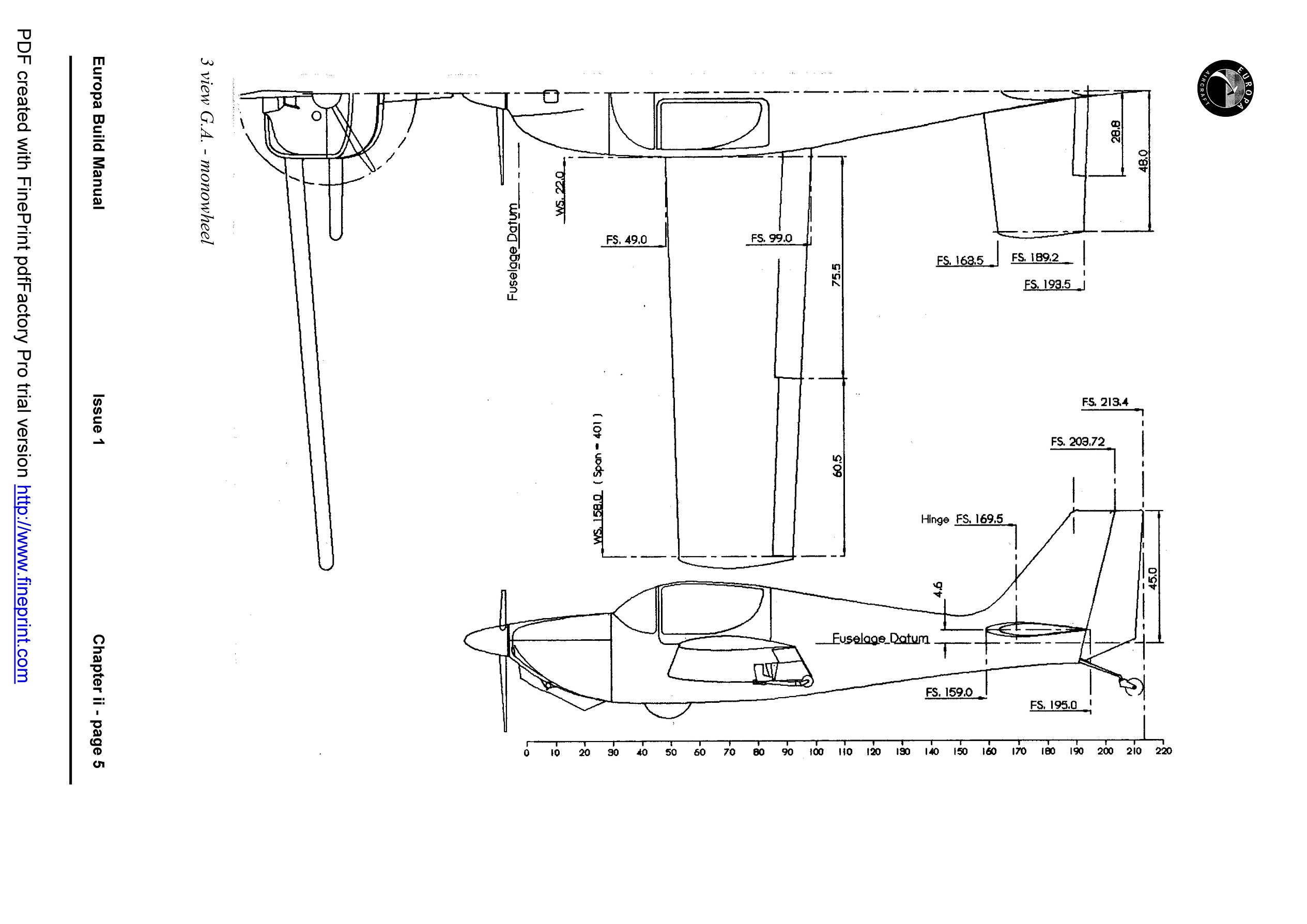

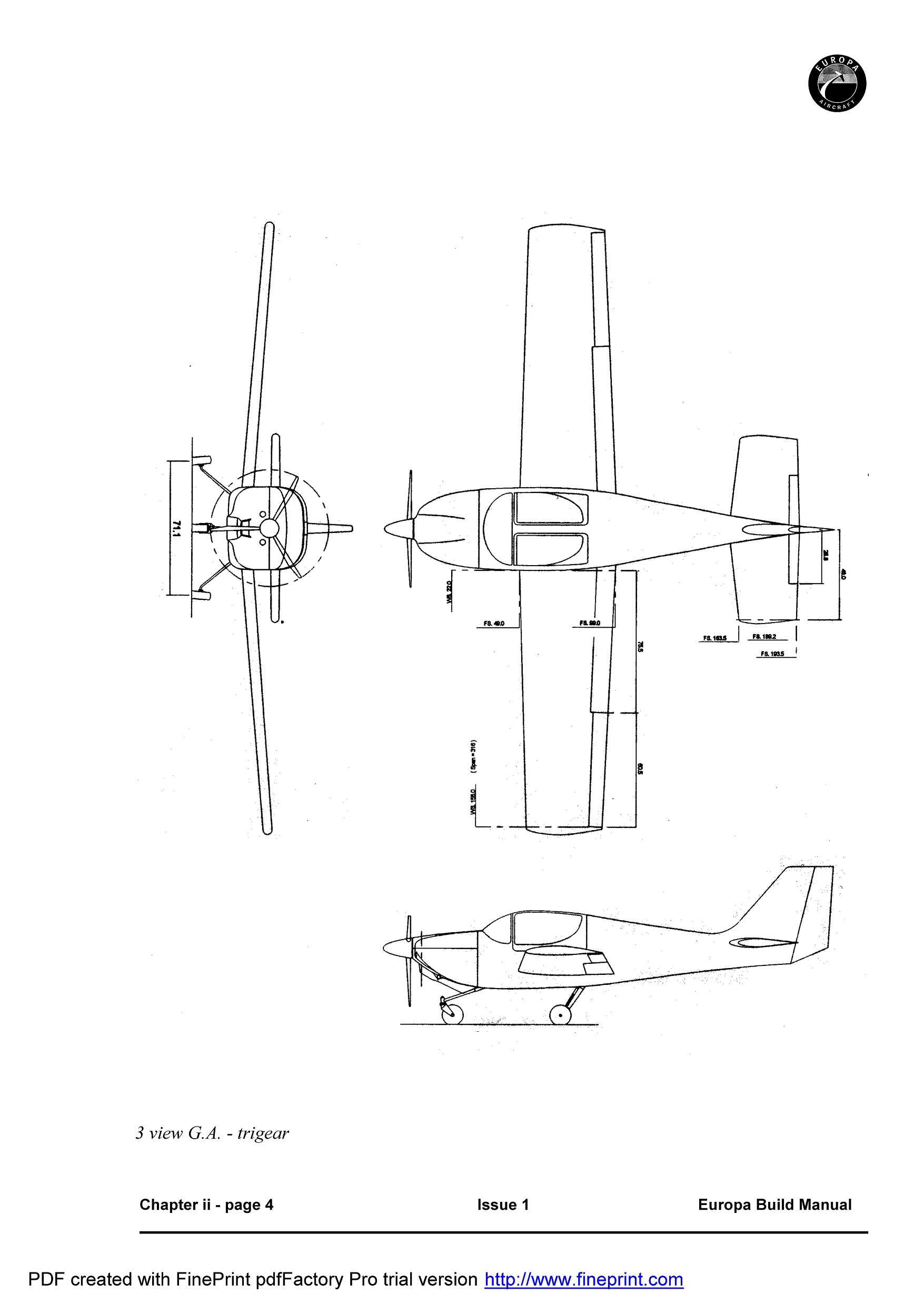

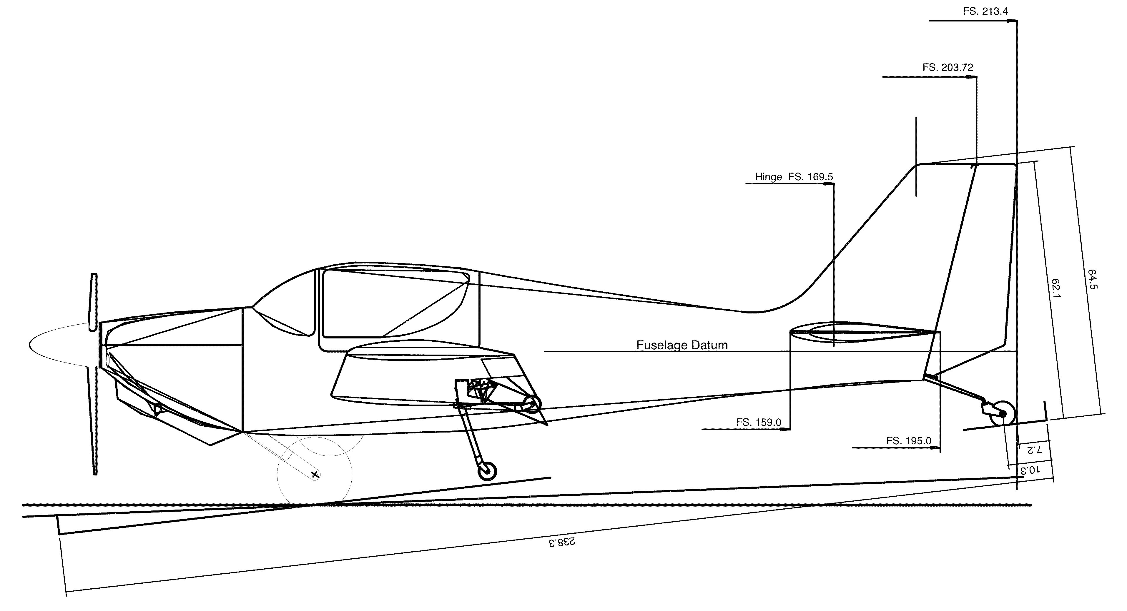

I know I must be getting close. As I am planning final vinyl graphics.
Does anyone have a blank outline of the fuselage?

Alan - is this any use?

These extracts from the Manual (converted to jpeg for your viewing pleasure) might help...
