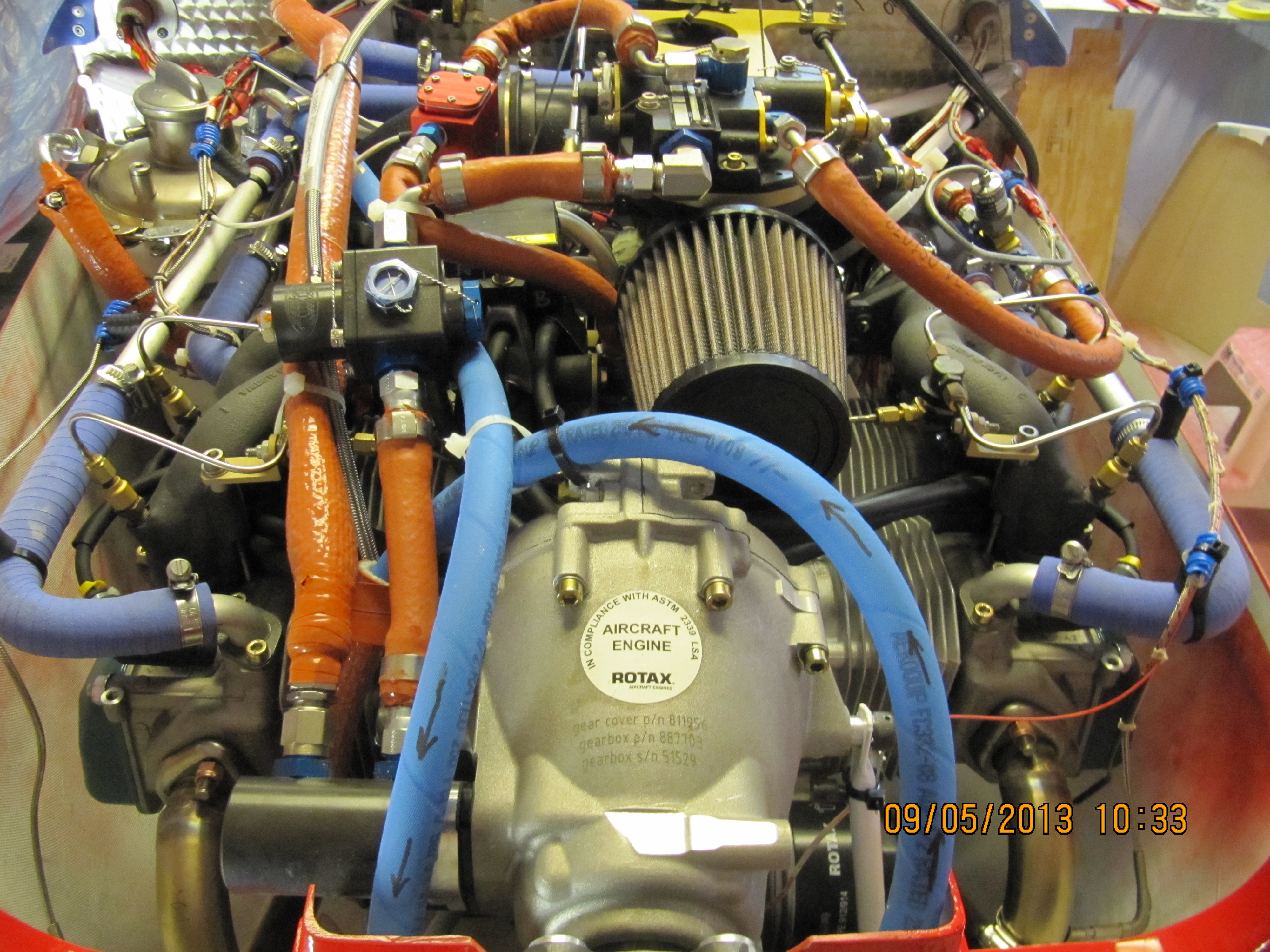

PostPosted: Tue Nov 19, 2013 6:23 pm    Post subject: 912 Fuel Injection Bolt on Reply with quote
Roger
Air performance in Spartenburg SC does>>>I have one...
John McMahon

PostPosted: Wed Nov 20, 2013 12:25 pm    Post subject: 912 Fuel Injection Bolt on Reply with quote
OK I will try to help you as much as possible..
The web page to his site http://airflowperformance.com/
The owner is Don Rivera His number is 864-576-4512
he is located on the Spartanburg,SC airport....
He has been making fuel injecting systems for 25+ years or so...
I have built 2 Vans aircraft and knew of him for some time
he has a fantastic reputation with us builders..
I let my medical run out as I have a condition (diabetes+74 yrs old) so
I purchased a Just Aircraft Kit (Highlander) with a new 912 Rotax eng
while at the factory at that time there was a lot of talk about fuel inj
systems and Dons name came up!!!!
There are 5 planes with his systems working perfect.....
The reason I did this is
1=smother running at all alt..
2=no more sync issue..
3=more horsepower( about 8 to 10 HP)
4=no computer systems in use!!!All bendix type eng that has proved...(bolt on kit)
The Negative issues are
1=more money to spent
2=if you install on new eng,it voids warrantee...
Hope this helps,I can send some pic if needed....
    John McMahon
