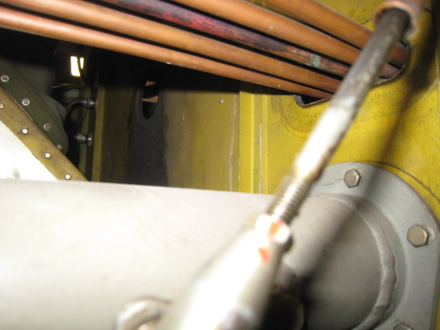

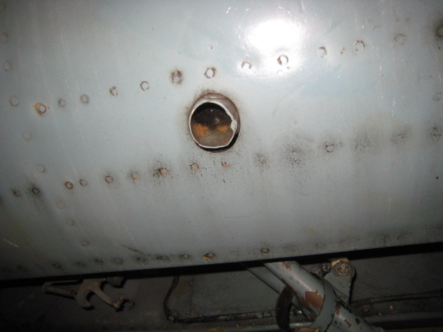

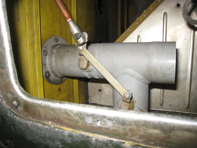

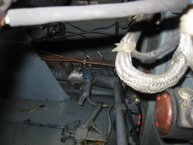

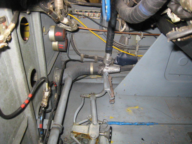

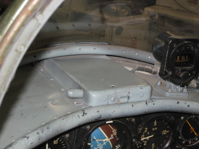

I was able to visit my CJ in CA and found I have scoops on both sides of my cowl. Both have felt seals on the inside which sealed the heat muff to the cowl. From the firewall back, there is around 2 1/2" metal insulated tubing to a heat valve on each side of the cockpit. The right side feeds the front heat and defrost, the left side tube feeds the rear cockpit.
I do not have the heat muffs and the firewall inlets are sealed.
Phil

Heat system in my CJ.
 Filesize:  89.32 KB
 Viewed:  14456 Time(s)
 Filesize:  71.29 KB
 Filesize:  88.02 KB
 Filesize:  99.44 KB
 Filesize:  117.99 KB
 Filesize:  82.17 KB
Phil

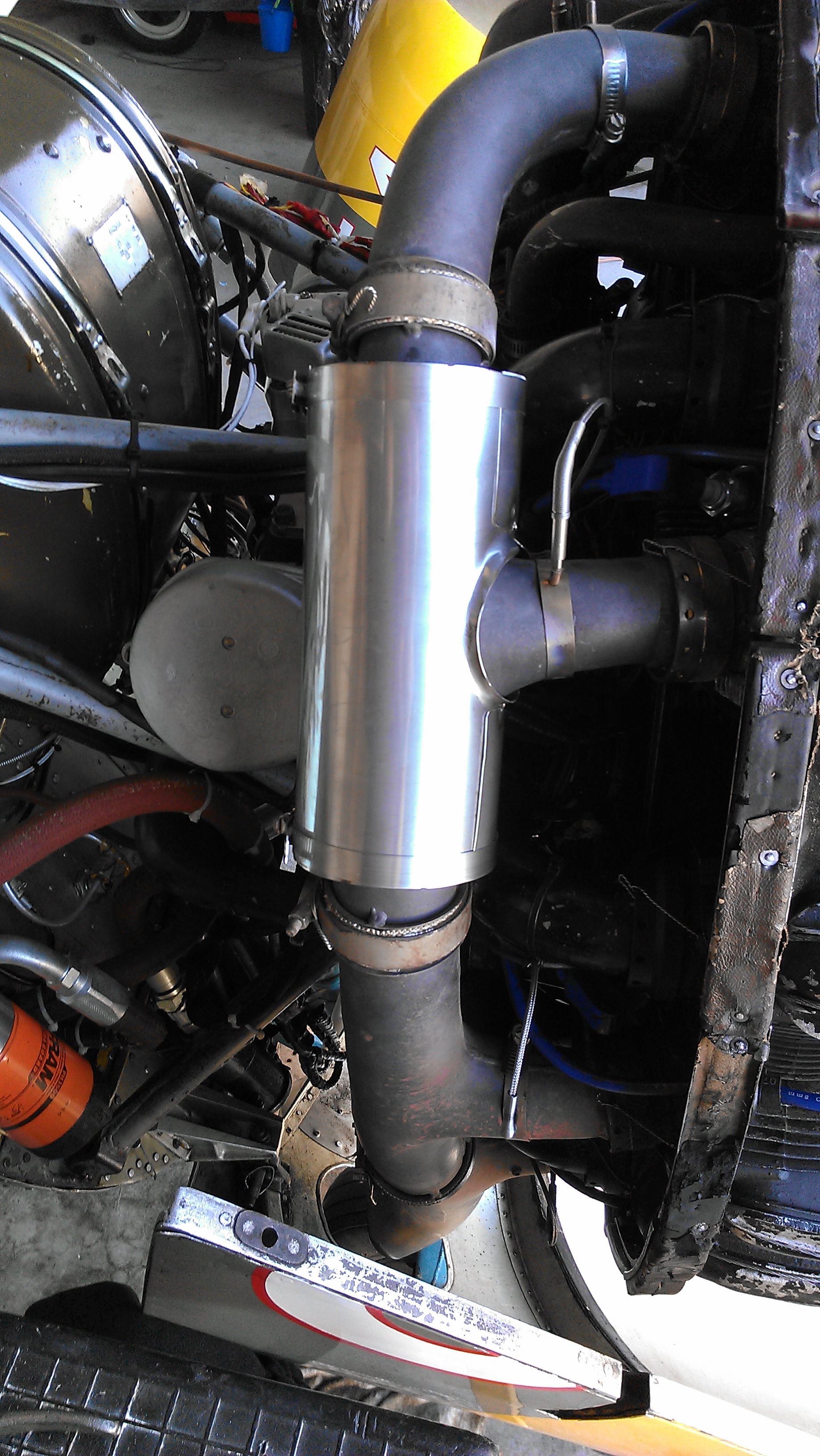

I have been working on my cabin heat install for the last couple weeks. It is a DIY system. Sonic Headers made my heat muff: http://sonicheaders.com/
This picture was taken when I put the heat muff on no. 8 which is the cylinder I told Sonic Headers to build my heat muff for. They built it for no. 4 instead, so the picture does not represent its final installation. It turns out that having the heat muff on no. 4 is a better location than on no. 8.
I just received some SCAT duct from Aircraft Spruce and should finish my installation this weekend. I will take more pictures this weekend.
