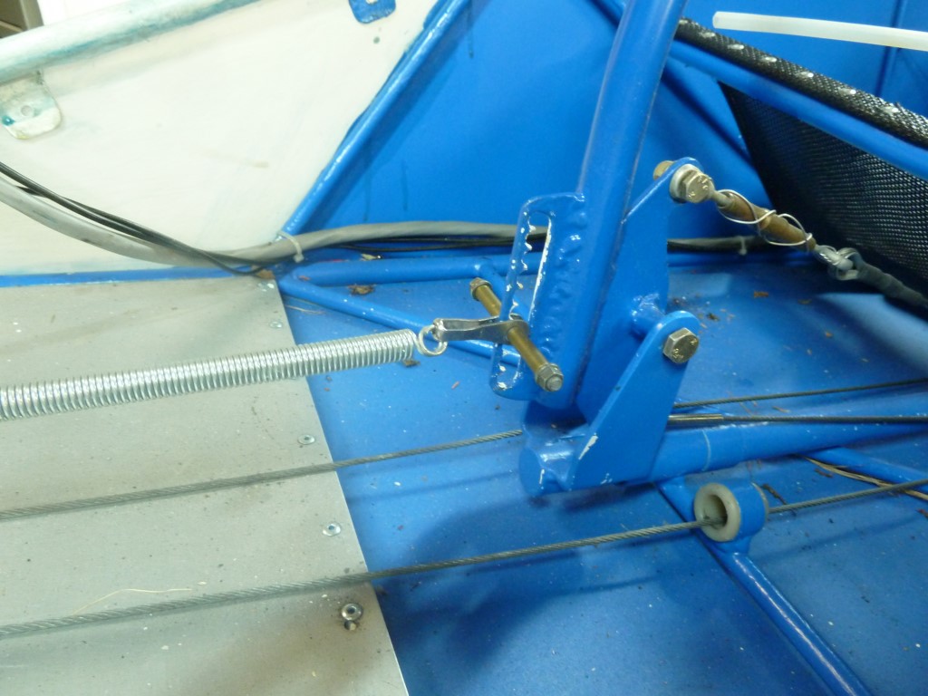

Just thinking about elevator trim tabs - I have a small one on my MKIII because when I first flew it there was was one speed and throttle setting where it wanted to do something wonky - too long ago, can't remember what it was. Also that was before I could slightly reflex or droop the flaps while in flight, so the elevator trim tab is probably unnecessary now. Or maybe not - I'm not changing anything.
Anyway, on the MKIII, the elevator trim tab is optimized for solo flight, it has a spring loaded trim lever that is used when carrying a passenger because there are radical trim changes when you add a passenger. The MKIII spring system works good, no problem.
Then there is the Firefly; we built it with this little spring loaded device on the front of the stick because pitch trim changes depending on how much fuel you have left. This is more than sufficient, you only have to move it a notch or two from full fuel to minimum fuel.

PostPosted: Sun Aug 19, 2018 4:31 am    Post subject: Kolb-List:Stabilizer Angle Reply with quote
That's a good system on the FF. I have also seen this accomplished using a
small lever instead of hooks.
