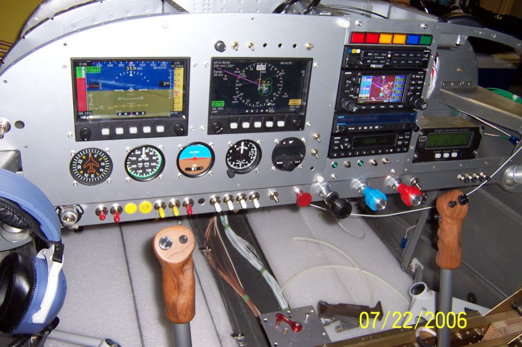

I have two GRT screens and a CMX 200 (picture attached with MX 20 before
trade in). The top screen is a GRT (PFD) and the left bottom screen is a
GRT screen. Under the top GRT screen is the MX 20. The lower screens (GRT
screen and CMX 200) are not all that easy to see. I'm 6' and find myself
looking down at the lower screens at an angle that seems to wash out the
screens (not all that bad but when I lower the viewing angle the screens
look much better. Laying out the panel my thought was to keep the screens
in front of the left seat as much as possible. May not have been such a
good idea. When I redo the panel with the new GRT hi res screens I'm
thinking I may go with a horizontal layout that gets the screens higher.
Mark
N410MR

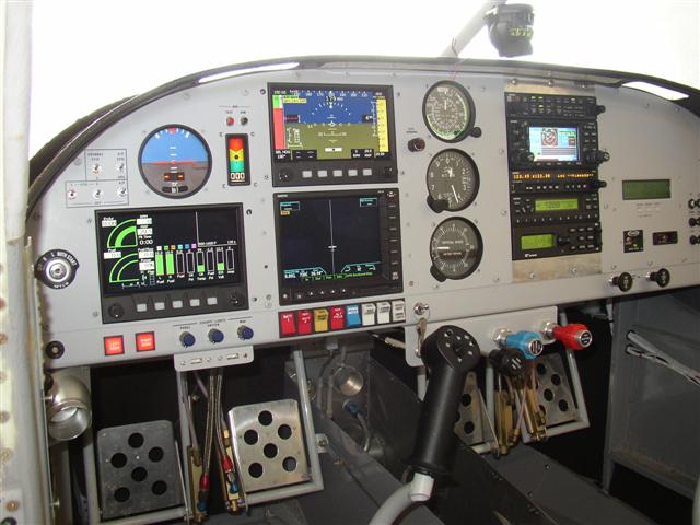

PostPosted: Fri May 25, 2007 6:06 pm    Post subject: The Perfect Panel...how to decide - was GNS-430W Reply with quote
Gary, mine is a 7 panel so it is smaller than the 10 but you can see how
they fit in this picture. If I had a third panel, I would dump the EIS
display and put it on a hidden sub panel. This is an Affordable Modular
Panel. I "might" put one of the Garmin docking panels in the right side but
am thinking of just putting one of the bigger panel GPS units (AVMAP EKP-4)
on the right to entertain the passenger Wink
I like the radio stack high and easy to get to so because that is typically
what pulls the eye from the EFIS unless you have the higher end units where
you do it all from the EFIS itself. Not sure vert or hor makes me a lot of
difference. How does it flow to the hand and eye would be my consideration.
Hope this helps

PostPosted: Fri May 25, 2007 6:20 pm    Post subject: The Perfect Panel...how to decide - was GNS-430W Reply with quote
Here is my panel and thoughts.....how I got here.
500+ hours
Commercial/instrument
Very little actual IMC, mostly penetrations, letdowns and a hand full of
real full approaches.
Of all my choices, I have only flown behind the 430.
1. Dual GRT, wanted it for the interface with the 430 and TT.
2. TT AP, great reviews and will fly profiles from the GRT....
3. Backup instruments, AS, TT ADI, and Altimeter...in a pinch that will do
(I lost a vacuum pump over Seattle once, that was all I had left in the spam
can, no gyro vectors till I punched out of the bottom)
4. Blue Mountain, CDI function for the 430, but really will be used by my
wife so she has her own set of buttons. Not really planning on it being the
backup.....wrong side of panel. But, could be used if necessary.
5. DVD player/screen......wife, two more for the kids.
6. 430 IFR GPS, used in current spam can, know and like interface.
7. SL30, wanted two radios, don't want to deal with hand held. Had to
after an alternator failure while VFR out of Palm Springs.....my assessment
was it just was not very effective and in a pinch I would want it to be the
very last resort. I still carry the handheld with me.
8. 327 for transponder, decided to wait for ADS-B, might have made the
wrong choice.
9. GRT EIS, good reviews and integrates with EFIS.......
I started serious work (thinking and purchasing) on my panel in Dec 05. Due
to my choice of hardware by the time I got around to ordering it was mid
2006. Worked almost final layout with Stein and then awaited
parts.......panel completed and in my garage last week, minus the TT ADI,
not making the smaller ones yet.
Stein has been great, but he is in demand........
Rene'
