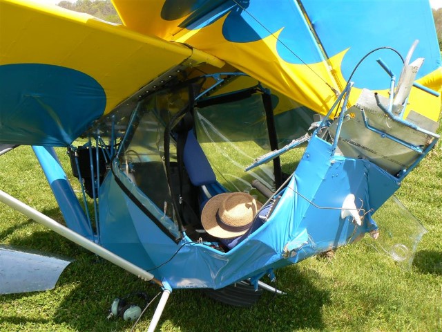

Richard Pike
Posts: 1671
PostPosted: Fri Aug 17, 2018 12:14 pm    Post subject: Re: Kolb-List:Stabilizer Angle Reply with quote
John Hauck wrote:
Is the tail boom adjustable?
Well, it sorta is - but then the airplane becomes even more difficult to trim... <Grin>
 Filesize:  123.88 KB
 Viewed:  19935 Time(s)
Richard Pike
Kolb MKIII N420P (420ldPoops)
Kingsport, TN 3TN0
PostPosted: Fri Aug 17, 2018 1:30 pm    Post subject: Kolb-List:Stabilizer Angle Reply with quote
Richard P had me scratching my head until I saw the attachment. I hadn't
thought about that particular adjuster. Wink Good comment. Goes well with
the photo.
