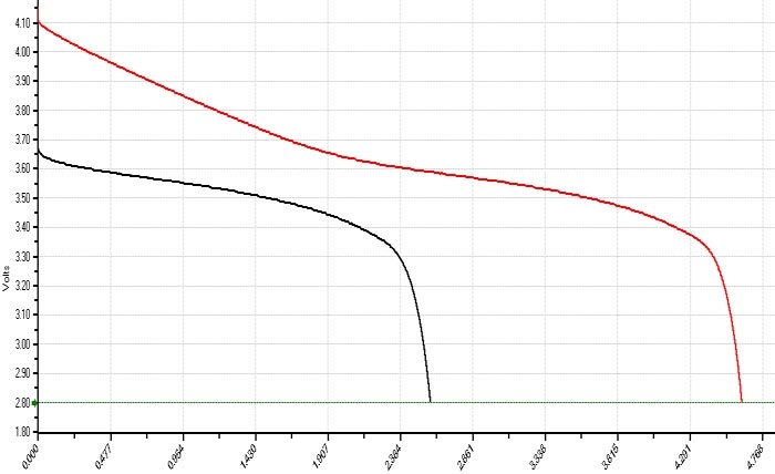

PostPosted: Mon Jan 05, 2015 3:46 pm    Post subject: lithium facts Reply with quote
So is there a definitive answer???
I've found that there's quite a variation in knowledge about LiFePo4 cells among the people who are selling them and even among those building them.
Gee . . . what was your first clue?
I've been sifting the lithium pile of sand for about 4 months.
I'll be writing an article for KitPlanes on some of my findings.
In brief, I believe I am on solid ground with the following
assertions:
LiFePo4 IS the chemistry of choice
The MAX charge voltage for LiFePo4 is 4.2 volts per
cell.
Sift through the spec sheets for commercial offerings
of LiFePo4 and you'll find MOST cells "rated" at 3.7V
charge, 3.3V nominal delivery point.
Here are some exemplar performance curves one particular
cell
[img]cid:.0[/img]
Note that charging at 4.2 volts nearly DOUBLES the cell's contained
energy. Stack 4 cells in series to perform in a 14v system and
you would have to charge the battery at 16.8 volts. A tad high for
many 14V bus operated devices . . . and perhaps out of reach for
many voltage regulators.
It's a little different ball game for consumer products that discharge
lithium cells with switchmode power supplies. You can order chargers
rated for EITHER 3.7 or 4.2 volts per cell. There are no caveats
offered for the use of these chargers with any of the COTS lithium
products . . .hence, no big risk . . . but a substantial difference
in cell performance.
3.7 x 4 is 14.8 volts . . . right in the ball park for plug-n-play
replacement of SLVA with Lithium. Yes, STORED energy is 1/2 but service
life gets a real boost . . . and risk for electrically induced damage
to the battery goes way down. The AeroVoltz 3x4 array I tested clocked
in at just over 7AH capacity when charged on a 14.5V bus.
