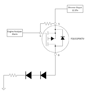

Here's (what I think is) the correct circuit. Still not sure I can integrate this into the existing PCB though.

Your LED circuit 3.pdf looks correct to me.

Definite improvement! Probably usable. There's a small range where the MOSFET controlled LEDs go out before the others. But it's such a small range that I doubt it's an issue.
Now I have to see if it's a doable mod to the PCB.

New diagram looked perfect. Glad to hear it works acceptably well. Hope you can bodge it into your PCB for a permanent solution!
Eric

[img]cid:.0[/img]
This is the best alternative for 'buffering' the
output port as it was handed to you. The size of
the resistor still leaves some risk for 'ghosting';
there might be sufficient leakage in their output
to produce a source-gate voltage that is greater than
the threshold voltage on the FET . . . typically
on the order of 2-3 volts.
A resistor on the order of 470 ohms is suggested.
The Perhelion dimmer is linear as opposed to duty-cycle
switched so yes, at some lower voltage, the gate-turn-on voltage
for the FET becomes a significant part of the supply
voltage out of the dimmer and LEDs controlled by the FET
will go out first.
A refinement of the design could consider duty-cycle
switched dimming or going to logic-level gate FET with
a much lower threshold voltage.

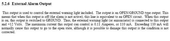

But... It does work with an incandescent bulb... As long as it's wired to 12v and not a dimmer.
The Engine Analyzer is a Grand Rapids EIS 6000.
Doc's are here:
http://grtavionics.com/manualseis.html
Okay, the warning light output is described thusly:
[img]cid:.0[/img]
The fact that it can 'shut down' automatically implies
some kind of protective 'smarts' on this pin. At the same
time, the rated switching current is more than
adequate to the task of handling either LED or incandescent
lamps . . . although the 'ghosting' phenomenon is not
understood.
Have you talked with GR about this? This still not
making sense.
