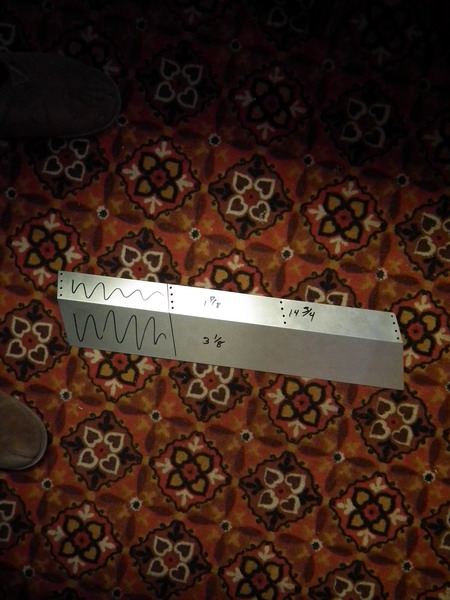

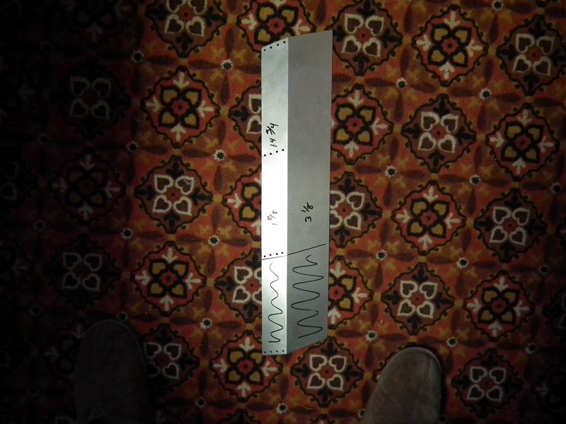

Frank D/Kolbers:
Here are some pics with a spare rudder trim tab I made. Same, same what I
have on my MKIII, except I rounded the corners more than depicted on this
piece. This was also the first tab I tested, which covered 3 rib bays, and
moved adverse yaw the opposite direction in the same amount as it flew
without a trim tab. After I cut it one rib bay and to the dimensions
indicated below, it flew with the ball centered and feet off the rudder
pedals.
Dimensions are marked on the trim tab, but in case you cannot read them,
here they are:
Width: 14 3/4"
Length: 1 7/8" to the bend (35 degrees) with a 3 1/8 trailing edge.
Short side is riveted to the ribs with large flange aluminum fabric rivets.
I use aluminum rivets (hardware store quality) for anything that is not
structural because they are much easier to remove when it comes time to
change a component.

PostPosted: Sun Dec 04, 2011 5:45 pm    Post subject: Some success at last Reply with quote
Richard G/Kolbers:
Don't know if Richard got this email or not, with a couple photos of my
rudder trim tab.
However, this particular rudder trim tab design has fixed adverse yaw on a
lot of MKIII and MKIIIx aircraft, to include the newest iteration of the
MKIIIx I tested several years ago. Before the rudder trim tab was
installed, that was the most God awful feeling airplane I have ever flown.
After rudder trim tab installation, this MKIIIx flew just like a Kolb.
If you haven't tried the trim tab on the critter you are trying to tame,
tape one on with duct tape and go fly.
 Filesize:  89.33 KB
 Viewed:  7067 Time(s)
 Filesize:  134.69 KB
Richard Pike
Posts: 1671
PostPosted: Thu Dec 08, 2011 6:05 am    Post subject: Re: Some success at last Reply with quote
John Hauck wrote:
Richard G/Kolbers:
rudder trim tab.
<snip>
Yep, thanks. I'll try one about 1 1/2" longer, and 1 1/2" wider and see what happens.
