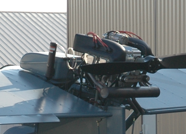

PostPosted: Tue Jul 05, 2011 2:45 am    Post subject: Re: N1014S MarkIII Xtra first flight - Frank D Reply with quote
Frank,
The NORMAL Jabiru scoops do not go to the prop. There are baffles at the entry and between the cylinders to make sure the air is directed over and then down between the cylinders and down at the back of the aft cylinders.
Attached is a photo of the normal scoops on my Jabiru.
