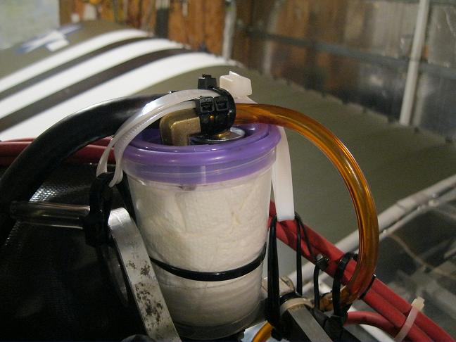

ps...this is the picture of the catch can...i removed the Brillo pad that was getting deteriorated and replaced it with paper toweling to soak up any moisture and oil...I am back using A Brillo coarse mesh pad again and I think I'm going to use larger diameter tubing too..when I took it apart you could see where the toweling was right up against the in-coming and out going openings...

PostPosted: Mon Jan 17, 2011 7:51 pm    Post subject: Kolb/Jabiru carb overflow Reply with quote
chris ambrose
M3X/Jabiru
Chris A/Gang:
Is it mandatory to use a large catch can? or can you configure the breather
hose to dump overboard?
Does the engine blow that much oil through the breather? or is the catch
can also the air/oil seperator?
titus, alabama

PostPosted: Mon Jan 17, 2011 8:00 pm    Post subject: Re: Kolb/Jabiru carb overflow Reply with quote
John,
It's more of an air/oil separator...this is where the moisture gets out of the engine and without it it would make an annoying mess on the tail...the one I had on last year had the Brillo pad in it and was not as tight as this one is...maybe I made it too good !
chris ambrose
PostPosted: Mon Jan 17, 2011 8:11 pm    Post subject: Kolb/Jabiru carb overflow Reply with quote

PostPosted: Mon Jan 17, 2011 8:38 pm    Post subject: Kolb/Jabiru carb overflow Reply with quote
Chris I have installed and flown two of the same Jabiru engines you have the 2200 I didnt get a big mess out of them and I would run that tube down through the tail boom and out to the end of the rudder it if was making that kind of a mess on the tail or
I am willing to make you an aluminum Can just for that crank case vent if you would like with a petcock in the bottom of it so you can drain it on pre flights

PostPosted: Tue Jan 18, 2011 3:38 am    Post subject: Kolb/Jabiru carb overflow Reply with quote
Chris, An old Lycosaurus trick is to put a slit in the breather tube so that if there is any obstruction in the end of the tube the pressure will push the slit open and allow the engine to vent.

PostPosted: Tue Jan 18, 2011 4:37 am    Post subject: Kolb/Jabiru carb overflow Reply with quote
John,
The oil fill tube,dip stick guide,crankcase vent are one and the same.About 3/4 in ID with the base of the tube not far enough above the oil level.The later model engines have a deeper oil pan,but it really should have a windage tray like we used in VWs .I have built a separator mounted on top of the engine with 5 vanes in it that cause the vent gases to make sharp turns when leaving the case that SEEMS to help,and have used a PCV valve to try to hold a negative pressure in the case, but the venting system needs a redesign IMHO.If I still have it at the 2000hr TBO,I would try to modify it.It is such a sweet engine in other respects.

PostPosted: Tue Jan 18, 2011 5:55 am    Post subject: Re: Kolb/Jabiru carb overflow Reply with quote
Chris,
Glad you found the culprit!
My rather small air/oil separator has one inlet and two outlets. The top outlet goes via flex hose directly overboard. The bottom outlet goes to a petcock and from there it also goes overboard. After every flight, I drain the several drops of the muck that collects in the bottom using the petcock. As long as I never let the separator fill up (drain after every flight), no oil or muck comes out of the upper outlet and the tail stays nice and clean.
I add no more than a 1/2 pint or so of oil between 50 hour changes, so most of what comes out of the separator is oily water.

if there was someway that you could put some insulation around the seperator / tubing, it would keep it warm enough it could not ice over. just thinking outloud here, i have seen some foam tape that would keep things a bit warmer. as to paper or corse mesh pad... when working with pnumataic thermostats and controls,, one of the best filter housings ive seen used a roll of toilet paper as a filter element. it worked as a filter dryer. and cheap to replace.

PostPosted: Tue Feb 15, 2011 2:56 pm    Post subject: Re: Kolb/Jabiru carb overflow Reply with quote
Hello all....
Well,I got the head back on yesterday and flew it todayfor .5 hrs and it ran perfect ! Ellery's catch can worked perfect and my fuel pressure stays between 1.4 to 1.7 and absolutely no problems running what so ever!
Thank you Thom for making me look closer and the crankcase vent system as that was my problem from the start. I believe condensation in the line froze blocking the venting and raising the pressure in the engine causing the fuel pump to go wild!. It was 16* today when I flew it and all was good ! Now to build trust in her again...lol
