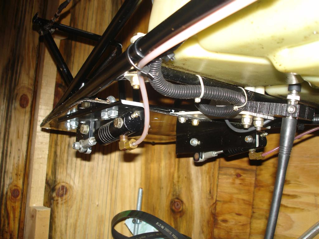

Dana
Joined: 13 Dec 2007
Posts: 1047
Location: Connecticut, USA
PostPosted: Sat Oct 03, 2009 12:39 pm    Post subject: Re: Heel brakes or ??? Reply with quote
Here's a couple of pix of my "substandard" heel brake installation for anybody who's interested. Not saying they're "better", never did, but they work just fine for me.
-Dana

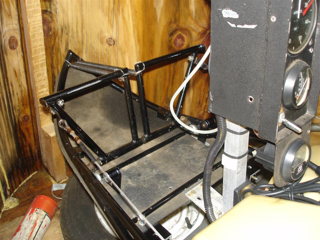

-Dana
Growing old is inevitable, but we can stay immature indefinitely.
Dana, that is sweet, much better than the stock cable operated setup. I saved those pix, I can actually see myself liking that, thanks.
(Now if John will ever get over his crabs and go home so he can post some pix...)
