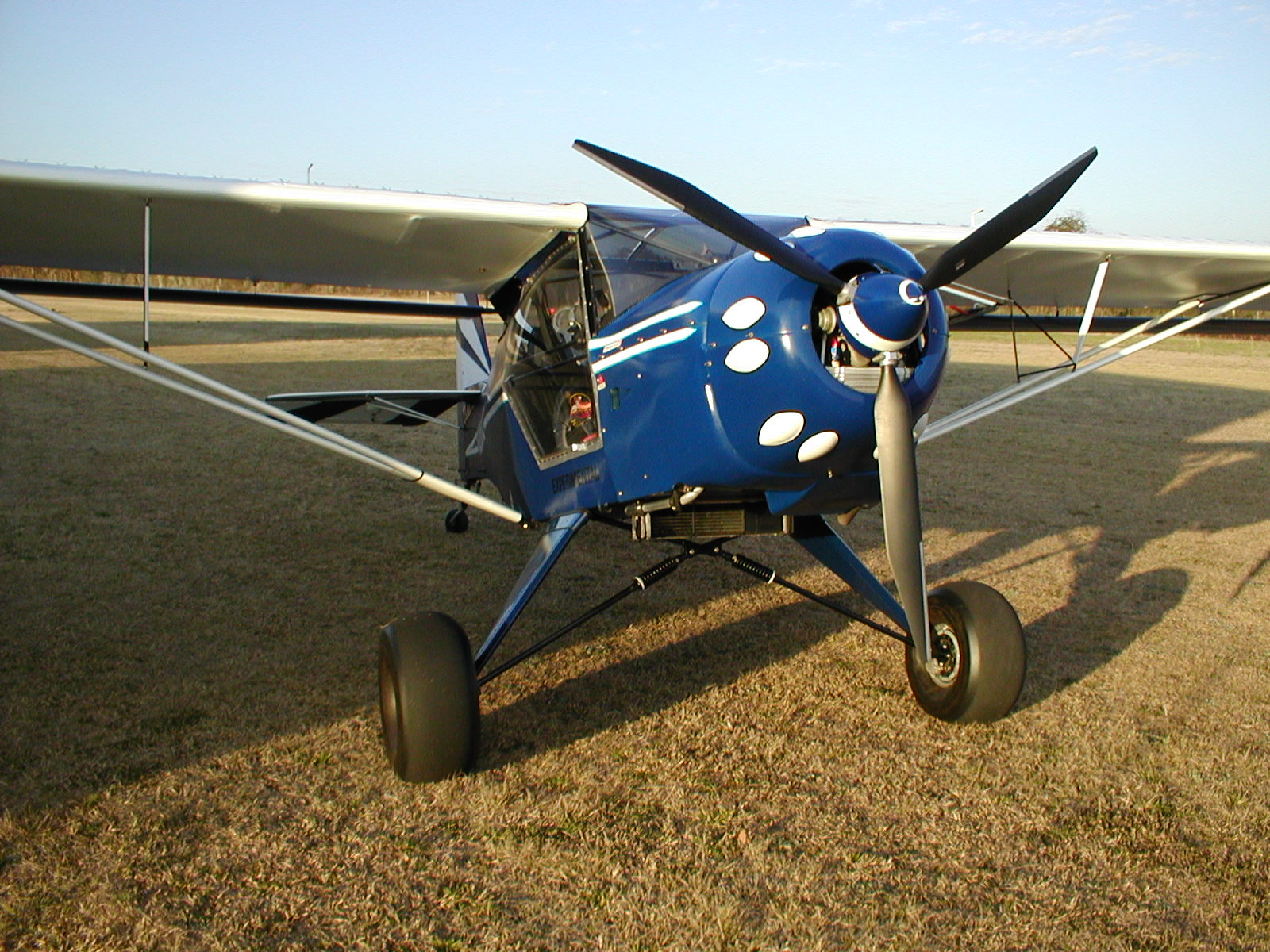

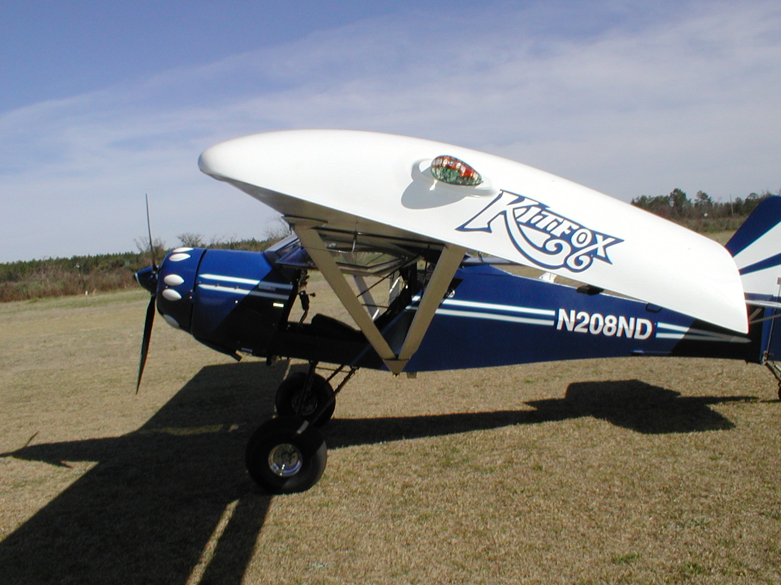

I have a few more pictures of my installation. One of the pictures shows the fairings which I have put on with a couple of Clecos. I will order enamel tomorrow so I can complete this part of the project.
I was going to fly today but a front came through and it was too windy, maybe tomorrow.

PostPosted: Sun Feb 22, 2009 5:40 pm    Post subject: Re: new bush gear Reply with quote
Dick, and Fransisco,
The thing that strikes me the most when looking at your pictures is that the Bush Gear makes your airplanes look bigger. I hate it when non airplane people look at my Kitfox and say, "it sure is Little".
You both know that now I have to save up for tw items...a big 4 stroke engine AND a Bush gear.

PostPosted: Sun Feb 22, 2009 6:50 pm    Post subject: Re: new bush gear Reply with quote
Heck, I like it even without the fairings (the kitfox brand style), and maybe I could save some more money without the sheet-metal and tabs. Hopefully Highwing can beat the grove gear upgrade by more than just $140 like Kitfox does though.
Guess we'll see. I've tried to reach both Mark and Lloyd at Highwing LLC. So, maybe I'll hear something soon.

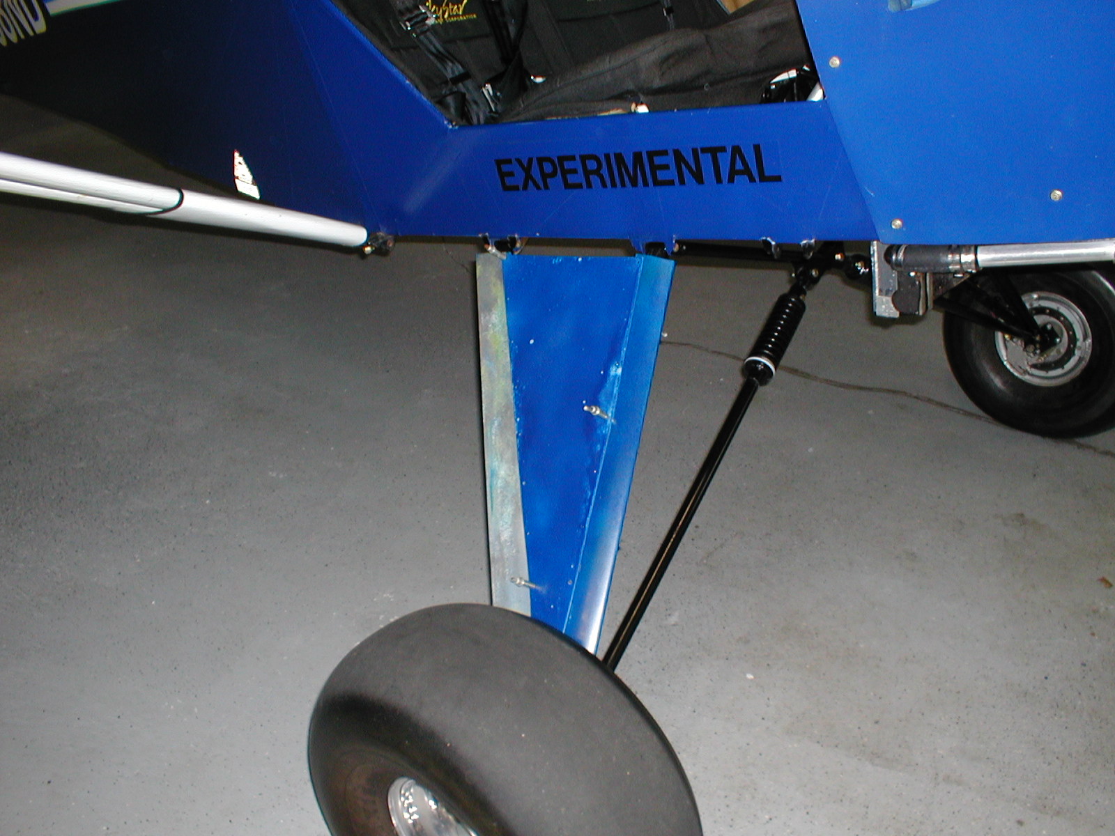

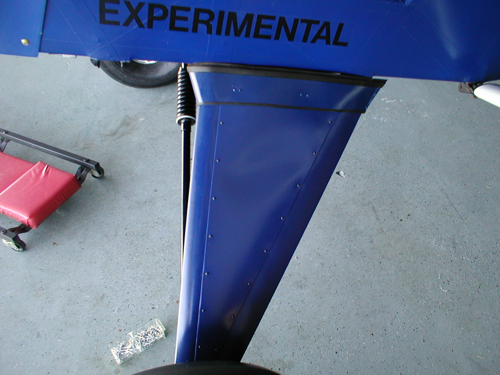

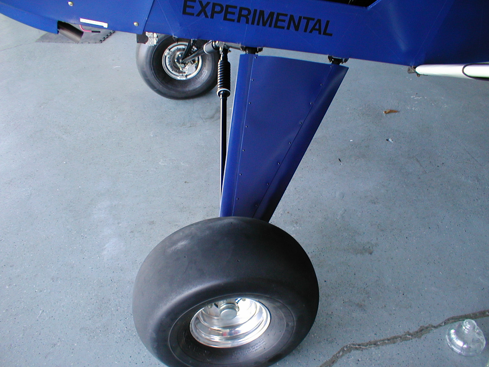

I installed one of the gear fairings today. It is not completely done but I am getting there.I had to fly a little prior to starting the fairing work.
Here,s a couple of photos to show how they will look.

PostPosted: Tue Feb 24, 2009 5:48 pm    Post subject: new bush gear Reply with quote
Very nice, Dick. It looks great!

PostPosted: Tue Feb 24, 2009 9:19 pm    Post subject: new bush gear Reply with quote
Thanks Dick,
I was watching for pictures of the fairings. Lowell does nice work and I was wanting to see how the fairings were done.
They look good!
Randy

PostPosted: Thu Feb 26, 2009 4:52 am    Post subject: new bush gear Reply with quote

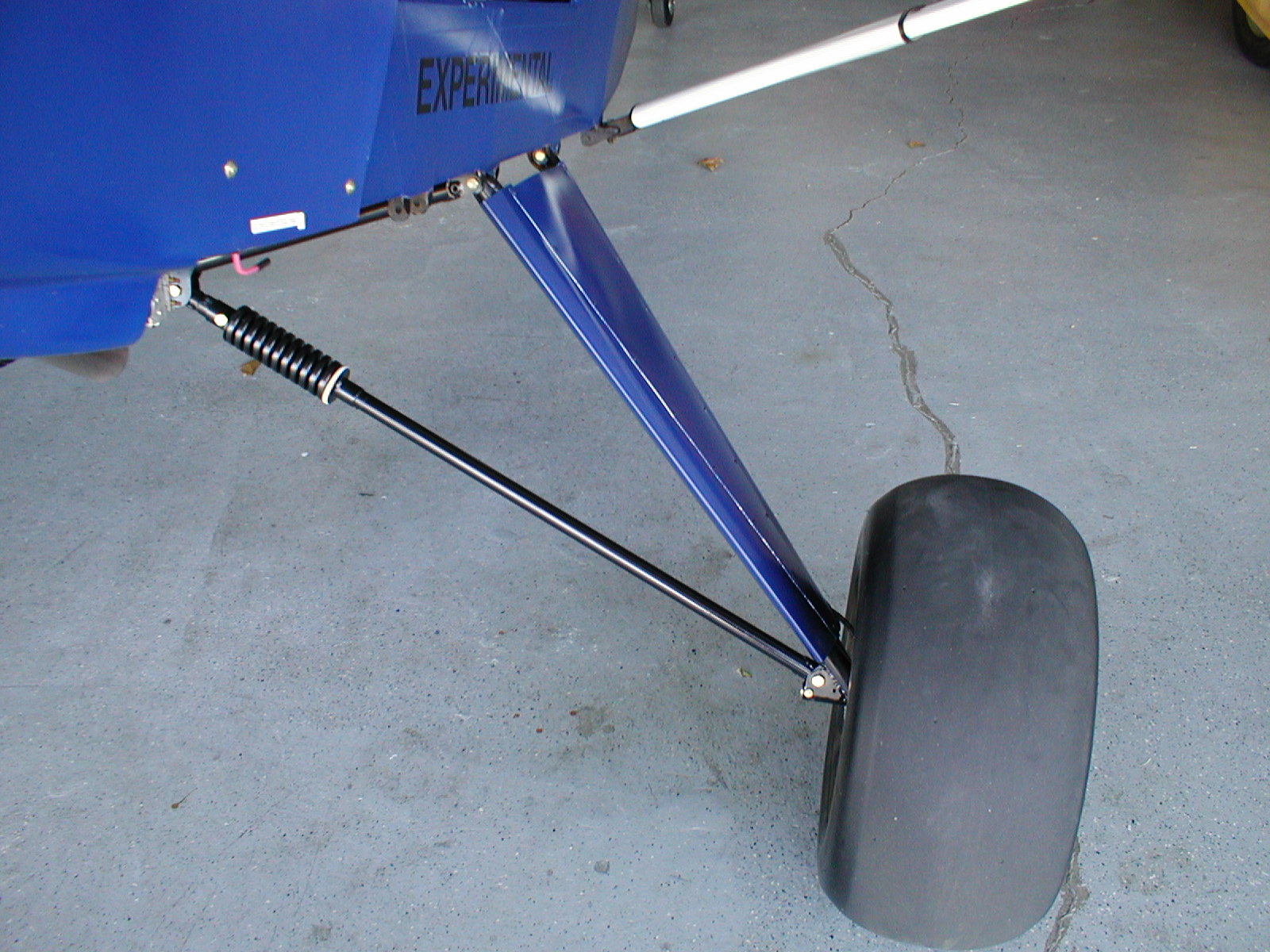

I completed the gear installation with the fairings and will post two more photos.(the fairing from the top of the gear legs to the fuselage is my own build) This will be my last as I don't want to bore you with this topic. As mentioned earlier,I am absolutely thrilled with this new gear and would never want to go back to the old one. The ground handling is fantastic!
The completed fairing installation seems to have added my 3-4 mph speed loss back to my cruise speed. Keep in mind this is not a scientific analysis but is based totally on observed indicated airspeed. The fairings are thin .016 skins attached to the gear legs to "clean up" the installation for aerodynamic purposes, they do not add any strength to the gear as one member had questioned.
I really don't know who came up with the term "bush gear" for this style of gear. It looks like a cub gear with springs and this type of gear has been used on a lot of different aircraft. Is it as strong as a Highlander's? (my favorite aircraft) I doubt it. Is it as strong or stronger than the original. I don't know that either. Is it easier to maintain and look at? YOU BET!

Dick C Beautiful! You aren't boring anybody. The added top fairing looks great. I believe my wheels are about the same size as yours.

 The completed fairing installation seems to have added my 3-4 mph speed loss back to my cruise speed. Keep in mind this is not a scientific analysis but is based totally on observed indicated airspeed. The fairings are thin .016 skins attached to the gear legs to "clean up" the installation for aerodynamic purposes C they do not add any strength to the gear as one member had questioned.
                                                                Dick Maddux
                                                                Fox 4-1200
                                                                Pensacola CFl
