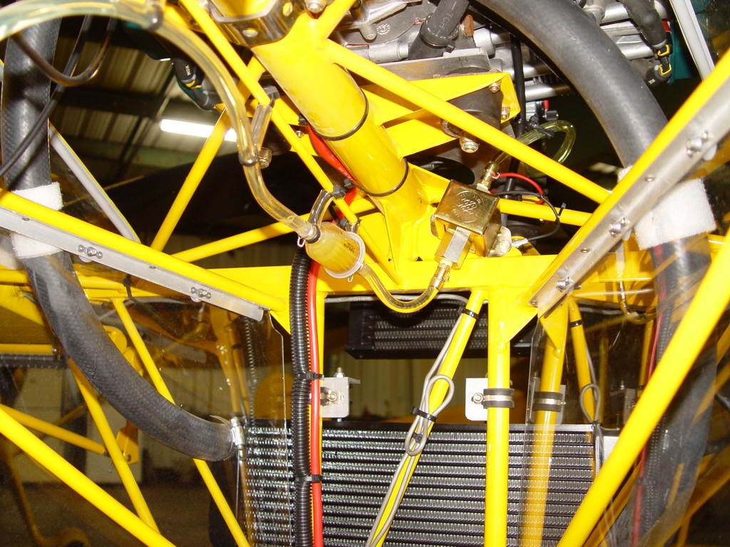

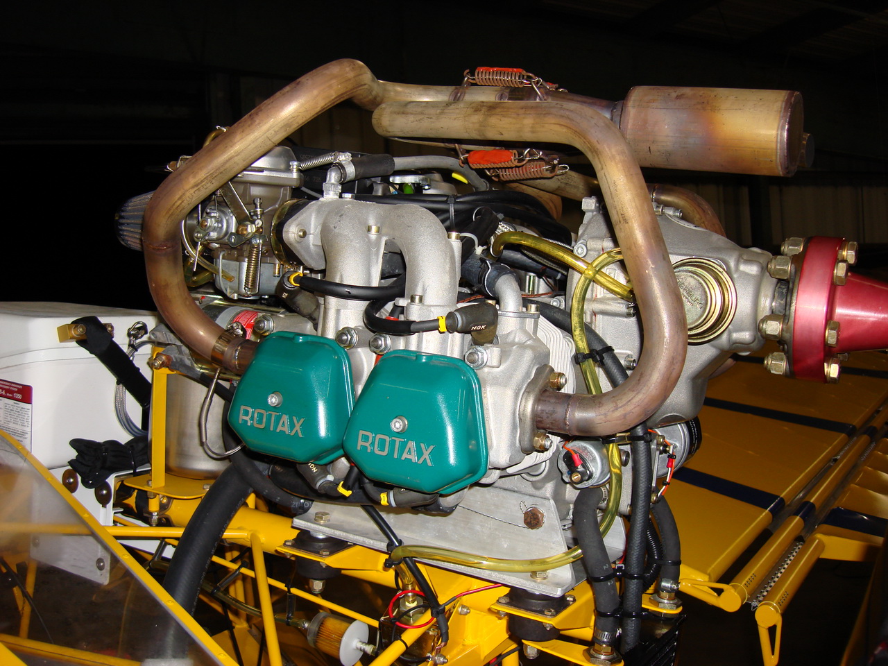

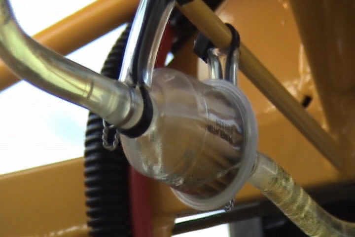

Here are some pictures of my first fuel system. The first picture shows lots of bubbles that form in the gasoline after the fuel filter due to fuel being pulled through it rather than pushed. There was no leak, changing the fuel filter did not reduce the amount of bubbles flowing out of the filter. At what point are there enough bubbles that the engine would quit ??? I do not know... I do know that the amount of bubbles forming in the gas could greatly increase with altitude and temperature.
The second picture shows more of my first fuel system, with the fuel line and the Facet pump sucking the fuel up on top of the cage, not good system design. This is vapor lock waiting to happen, or an engine out due to air entering through a pinhole leak causing the fuel pumps to lose their prime.
The last picture shows my first fuel system with the clear line running up to the engine, and out to the carburetors. This type of fuel line melts very easily, and is also very thin and easily cut. This is a fire, or at least an engine failure waiting to happen. Rotax came up with a fix for their 912 engines, I copied what Rotax did and put aviation fuel line with firesleeve on my engine.
Like John H. says, we are all free to chose what we do with our airplanes, and I agree. For those that like clear fuel line and always will, that is your choice, just be careful and keep inspecting it as often as possible... These posts and pictures are for those that want good information on fuel systems and their design. There is much more information about fuel systems than I know, or I could possibly present here, but hopefully this will start some people thinking. I would encourage everyone wondering about this subject to research recommended aviation fuel system design and materials to make Kolb as safe and reliable as possible. The EAA has a lot of excellent articles and suggestions on this subject.
Fly Safe,
Mike
A fire or failure waiting to happen. Easily melted line in close proximity to hot exhaust pipes, and also prone to being cut or chafed open.

Improper fuel system design, fuel being sucked up at least 2 feet causing gas bubbles to form in the fuel.

Bubbles forming in Gasoline due to low pressure... NO LEAK !!!

PostPosted: Wed Sep 17, 2008 12:33 pm    Post subject: fuel line? Reply with quote
"JetPilot" wrote: << The paper fuel filter has been replaced with
a Challenger Stainless Steel 10 micron fuel filter from Aircraft Spruce.
It was expensive, ... 130 dollars for the filter. The stainless steel
filter is designed to be taken apart and cleaned, so it should be a one
time purchase. Mike >>
Mike, and Kolbers -
Another (less expensive) option to the paper element filter are the
in-line clear glass "micro screen" cartridge filters, available at most
auto parts stores. You've heard them recommended by various Kolbers
more than once over the past several years.
Purolator and Mr Gasket make these types of filters; I'm sure there are
others. They're usually under 15 dollars. The screens are replaceable
- you just toss the old one. Because they're glass, you can see the
junk accumulating on the screen inside, and change it when necessary. I
do this every annual. At annual, I also check and replace the rubber
o-rings on the filter (there are 2). Easy, cheap, and o-rings are
always available.
I remember Hauck telling us the story of how the glass on his Purolator
filter broke once (John - I do not recall the details, did that happen
in flight?), which prompted him to replace the glass tube with the same
diameter, same length piece of alum tube. Works the same.
Dennis Kirby
Mark-3, 912ul
NM
aslsa.rng(at)gmail.com
always available.
Dennis Kirby
Mark-3, 912ul
NM
