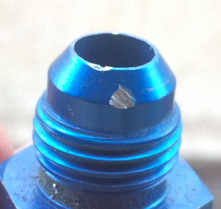

Couple of small items to report, but no smoking guns yet.  Just a couple of small items.  But for the benefit of the group or those coming after me in the archives...
1) The system from the left tank to the firewall is tight.
2) I learned that it doesn't take much vacuum (5 inches is enough) to leak fuel from the right side of the Andair fuel valve to the left.   Not surprising as the valve is designed to operate near-zero pressures and just provide the path of least resistance.   So the valve is a bit difficult to test if you're looking at doing it with vacuum.  Lessons learned.
3) I did replace the line from the fuel valve to the filter.  It passed the leak test, but did show signs of stress on the flares.  So I went ahead and replaced it.

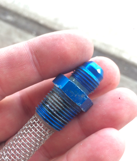

4) The thing I did find that could potentially be a clue came when checking the fuel strainer on the right tank.  The strainer was clean and I was getting ready to re-install it when I noticed this nick where the flare fitting would seat.  It looks more like an abrasion with a file than a nick.  Photos attached.  If you look closely, you can see where the flare would seat on the fitting and a small portion of the abrasion intersects that "ring".   This fitting hasn't leaked fuel, so there's no promises here.  But it's marginal enough in quality that I want to replace it so I don't have to worry about it being a cause going forward.  It's possible that it was leaking just enough air to put a bubble up at the sensor.
Who knows....  But I called Vans and ordered a replacement overnight.
I'm done until it shows up.   I've got things torn down enough at this point that I don't want to complicate things any more by proceeding to check other items.  Just want to finish up what I've started, get it back to a known state, then proceed from there with further inspections.
But thats the info at this point.
Phil
