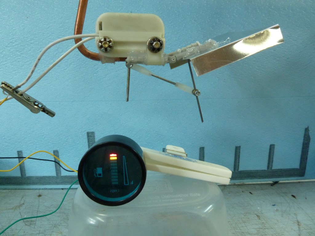

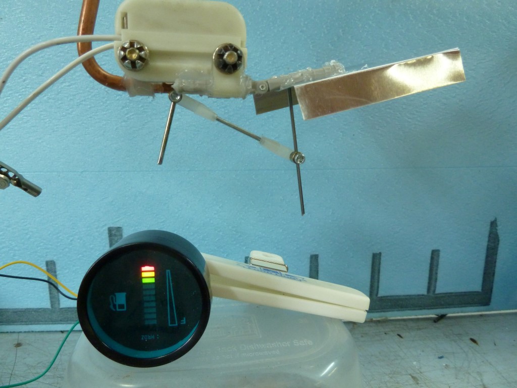

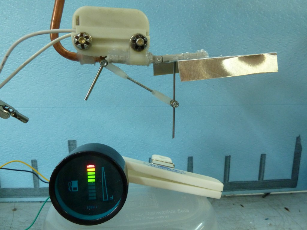

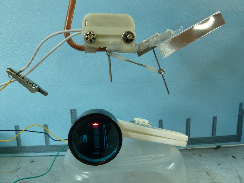

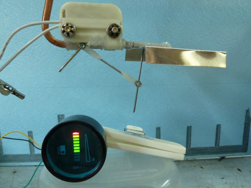

PostPosted: Wed Jun 15, 2016 1:08 pm    Post subject: Re: AOA Reply with quote
Earlier this spring the topic of AOA indicators was kicked around for a while and I ordered some items that I thought could be used to make one. Finally got around to cobbing together a workbench version just to see what it did. It works great on the bench, but in practice I don't think it would be something you would want.
1st picture shows the gas tank sending unit with a vane out behind it. Level flight attitude, and the LED fuel gauge below it, upside down. Lots of bars in the green, then a yellow one and finally a red one up top.
The next several pictures show a gradually increasing angle of attack, some of the green bars are out then a very high angle of attack, all you see is the yellow and red bars.
Finally would be stalled, all you see is the red bar. Obviously you would need a lot of trial and error fiddling to adjust the linkage between the vane and the sender to correlate with the actual onset of the stall, but I think it could be made to work.
The problem is in the gauge, it responds very slowly to changes from the sender. The LED's turn off and on at 2 or 3 second intervals. Move the vane abruptly and start counting: "One thousand one, one thousand two" - the first LED goes out. "One thousand three, one thousand four." - the 2nd LED goes out. And so on. In practice it is just too slow.
But it was interesting to fool around with.

Ist thought: you used a fuel gauge. Any fuel gauge that's worth a flip as a fuel gauge will display the exact behavior you saw. If you're bouncing around in rough air (or more likely, a rough road) you don't want the gauge alternately reading empty & full as you bounce across the potholes and sweep around corners.
There's almost certainly an RC (resistor/capacitor) network inside the case to average out the variations in voltage from the sender (which would normally be a float-controlled resistor in your tank). It's likely that the same LED ladder display can be found in power indicating meters for stereo and/or public address amplifiers. The basic indicator is *much* faster than your eye can follow.
Try again with an LED bar graph meter.
http://www.ebay.com/sch/i.html?_odkw=led+bar+graph&_osacat=0&_from=R40&_trksid=p2045573.m570.l1313.TR0.TRC0.H0.Xled+bar+graph+meter.TRS1&_nkw=led+bar+graph+meter&_sacat=0
I think you'll be much more impressed.
Charlie

Well, shucks. Now you've got me hoping I was right. Smile
Seriously, the display itself is easily capable of responding instantly,
so the mfgr must have done something to make it less sensitive to abrupt
changes.
You should be able to find a more suitable meter.
Charlie
