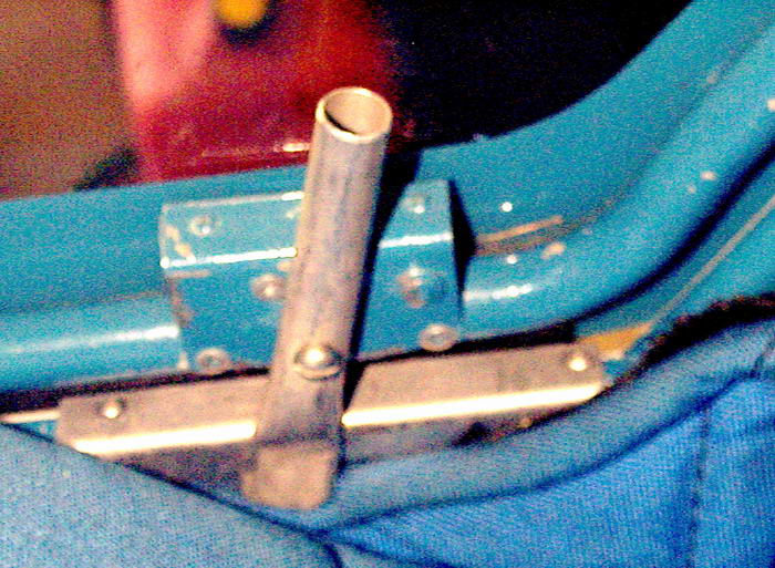

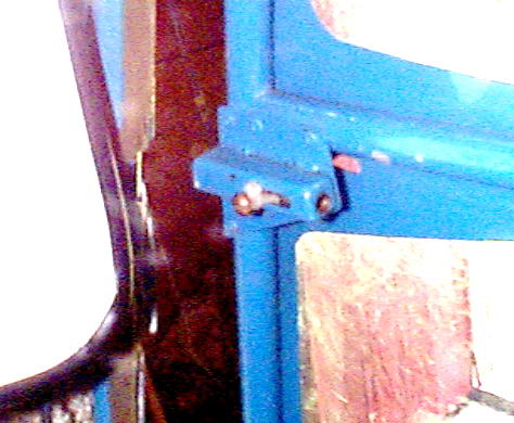

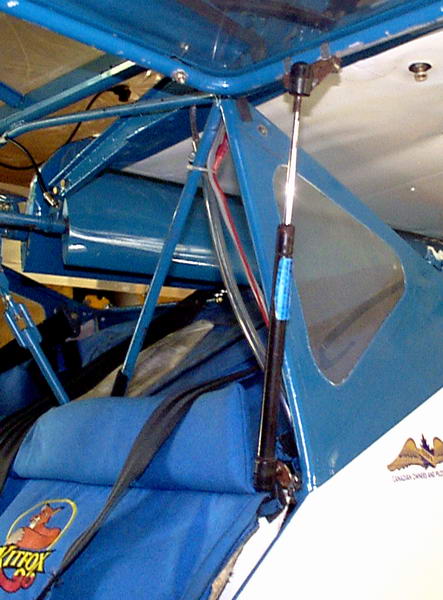

PostPosted: Fri Aug 11, 2006 6:35 am    Post subject: Flying without doors Reply with quote
Lynn:
I just went out and checked my aircraft for the use of those nylon bushings.
From what I can see they will prevent some metal fatigue over a period of
years. I would say that if any one didn't install them they should consider
doing so.
I'm going to enclose a few pictures of the latching system on my plane. The
doors are the standard metal frame and the main latch is similar to what you
will find in a house. Each door also has a safety latch that I check as
part of my run up list. Last year I went to the local scrap yard and looked
through several hundred automotive gas struts . I came up with one that was
easy to install to the door and the support behind the seat. I
intentionally made part of the mount that attaches to the door with worm
clamps so the strut goes over centre to help close the door. What I've
found is that when I go to open the door in flight I actually have to push
to open it. Before installing the strut wind would open the door at least
halfway.
Noel

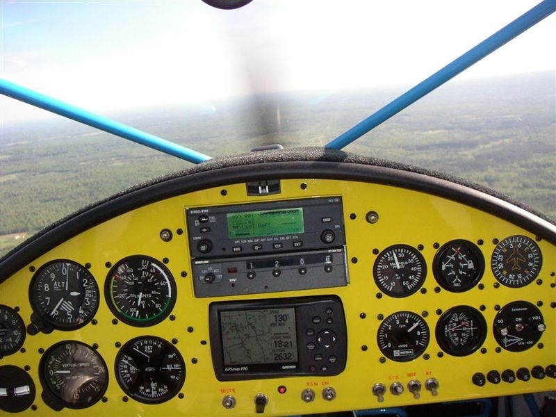

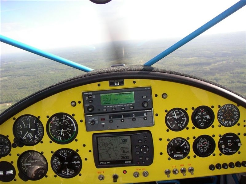

My prop is an IVO in-flight electric0 ultralight+ (higher pitch than the standard). Works good, but I0 should probably convert to the lower pitch blades as I can't get the rpms the0 engine needs to develop max horsepower. I'm convinced the other blades0 will increase my climb rate while reducing my takeoff time on the0 water. I have never been able to get to max power rpm of 5800. So0 even though I have an inflight prop, not developing max horsepower is reducing0 my climb and my cruise. But for now I am just going to enjoy it as is. Overall it works quite well just the way it is. 0
I've really been enjoying this Model IV-1200 Kitfox0 with the 912ul. It performs very well, especially considering it is0 only an 80 hp amphibian. It can get off the water in 8-10 seconds with0 just me and 1/2 tank of fuel (14 gallons). And with the same load I can0 climb out at around a thousand fpm average. Cruise speeds? Well0 that is the really fun part. For years all of the Rans S-7's in the area0 have been the fast floatplane to catch. Now they have to try and catch me0 <snicker> And I only have 80 hp vs their 100 hp. I tested0 max power cruise the other day with me and 7/8 tank of fuel (24 gallons) in dead0 air - 116 mph one way, and 117 the other. So this little bird cooks right0 along. I rarely run my engine that hard, but still typically see 1000 mph+ for groundspeeds pretty much wherever I go even at less than0 5000 rpm. And that little 80 hp 912 is a real fuel mizer. 0 Fourty hours of keeping track of my fuel shows an average of 3.3 gallons an0 hour. Isn't that something? This little floatplane is0 incredibly efficient. I wonder how it might perform if I ever get the0 prop pitch figured out? Although it's so good now I am almost afraid0 to touch anything.
Here are a few pictures in-flight showing0 my speeds. Note: I have been too busy flying to finish all the0 little things like instrument panel markings.... (chuckle)
Paul
 Filesize:  235.55 KB
 Viewed:  485 Time(s)
 Filesize:  249.03 KB
 Viewed:  506 Time(s)
av8rps(at)tznet.com

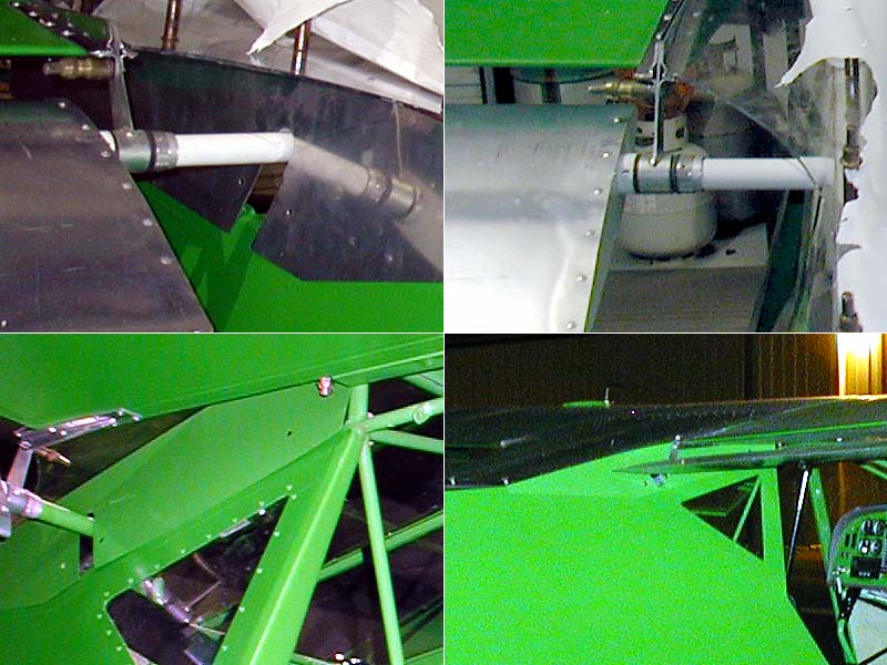

PostPosted: Sat Aug 12, 2006 9:50 am    Post subject: Flying without doors Reply with quote
Lynn asks:
Mike, didn't you have the nylon material attached to the t'deck and
to the fuse member just below the flaperon control tube, which
provides a split bearing around the flap tube?
No. My turtledeck simply had a slot cut into it for the flaperon
horn to pass through. The inboard flaperon hinge held the bearing
surface that the horn swiveled within (see attached).
Mike G.
N728KF

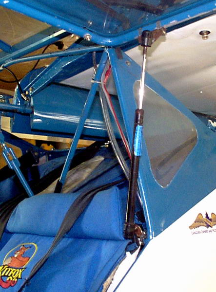

Lynn:
doing so.
halfway.
Noel
