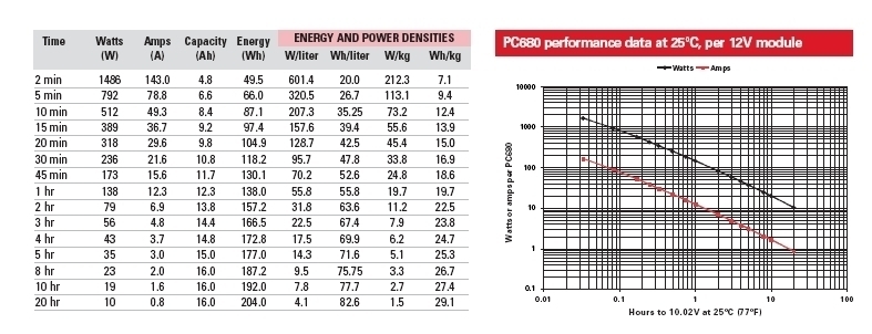

Okay, consider the PC680 which claims to offer 45 minutes
endurance when loaded to 15.6 amps for an energy delivery
value of 130 Watt-hours.

Okay, let's do a back-of-the-envelope . . . (actually, restaurant napkins are my favorite these days - don't carry much mail around with me. Best yet, I've discovered a ball-point pen that writes on grade Z napkins without tearing them. I hand them out to my cohorts in brainstorming at lunch!) . . . back of the napkin sanity check on a DIY replacement
for a PC-680:
Referring to the specs for an A123, 25560 cell,
    • lifepo4 CHEMISTRY
    • Nominal voltage: 3.3V
    • Nominal capacity: 2.3Ah
    • Core cell weight: 70 grams
    • 65mm tall, 26mm diameter (same diameter as a C battery)
    • Internal impedance: (1kHz AC) 8 m typical
    • Typical fast charge current: 10A to 3.6V CCCV
    • 70A continuous discharge
    • 120A, 10 sec pulse discharge
    • Cycle life at 10C discharge, 100% DOD: over 1,000 cycles
. . . they will allow very high discharge currents with a
relatively flat discharge curve so we can calculate each cell to contain
about 7.5 watt-hours of energy.
To approximate the energy content of the PC680, we would need
130/7.5 or 17 cells. We are obliged to configure these cells in
series strings of four so a 4 x 4 array of 16 cells gets
us 120 watt-hours. Okay, right in the ballpark. Further,
the 70A continuous discharge rating says the 4 parallel
strings would grunt a 280A cranking current without
breathing hard. Higher momentary loads are obviously
not out of the question.
Okay, the 4 x 4 x 26650 array would weigh in at about
1200gm plus another 400 for a case, which gives
us 1600gm (3.5 pounds with no battery management
system).

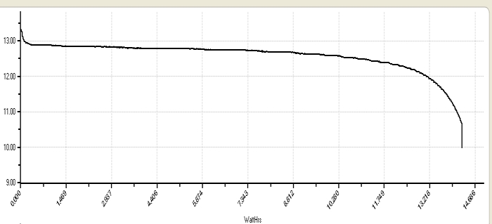

Okay, I just put the EarthX ETX36 . . . Model: ETX36D
Nominal Operational Voltage . . 13.3 V Ah (Lead-acid equivalent) . . . 36 Ah (actual) . . . . . . . . . . 12 (.5C rate) . . . Reserve Capacity . . . . . . . 27 min. Pulse Crank Amps (PCA) . . . . 680A (3 sec (at) 25 °C, voltage >9V) Cold Crank Amps (CCA) . . . . . 405A (modified SAE, 3 sec(at) 0°F,     voltage >7.2V) Continuous Discharge Amps . . . 100A Standard Charge Voltage . . . . 13.9 - 14.6 V Maximum Charge Voltage . . . . 15 V Recommended Charge Amps . . . . 1 - 15A Max Charge Amps . . . . . . . . 60A (from vehicle charging system) Life (Charge cycles, 80% deep of discharge)   4000 cycles (at) 1C discharge rate, 25°C   2000 cycles (at)10C discharge rate, 25°C
Life (Years) . . . . . . . . . 8 Years Weight . . . . . . . . . . . . 3.9 lb. (1.8Kg) Dimensions ETX36D . . . . . . . 6.9 x 3.4 x 6.1 inches Environmental Ratings
Resistance to water intrusion . IP 66 (Hi Pressure wash) Operating Temperature . . . . 30 °C to +60 °C Storage Temperature . . . . . .-40 °C to +70 °C
. . . on a 15A discharge with a data acquisition
system attached . . . let's see what we get.
[img]cid:.1[/img]
This product has a built-in BMS that disconnects the output if the terminal
voltage drops below a safe value for the battery . . . in this case, 10.6
volts. There was a 10x multiplier in the load current so the readings across
the bottom should be multiplied by 10. This particular test cycle terminated
at 142 watt-hours . . . right in the same ball-park as PC-680 published
data and our back-of-the-napkin DIY analysis for a 4 x 4 array of 26650 cells.
So from the perspective of evaluating available energy,
it appears that the ETX-36 series batteries are a drop-in
replacement for the PC-680. Both batteries demonstrate
performance in the 12AH class with a 15A load.
You get a weight differential of 14.8 - 3.9 = 10.9
pounds and a price differential of 350 - 110 = $240.
In the TC aircraft world, most manufacturer's would
be delighted to pay $24/lb for empty weight
reduction. In the OBAM aircraft world, that 10
pounds is not so 'valuable' . . . how many flights
have you re-configured because you were 10# "over
gross". Now, if the lithium battery could demonstrate
a service life of say 3x that of the SVLA, then
cost per operating hour is a wash and the weight
savings are 'free'.

So lets take a non-starting, constant load of say--15A and compare a lead acid battery of a given size and a LIFEPo4 battery (Or batteries) of EQUAL weight.
I see I blew the original premise . . . EQUAL weight.
Okay, stack 4 ETX-36 batteries in for approximately
the same weight as a PC-680. At 4x the stored energy
of the PC-680 at the 15A load rate you can fly
for 3+ hours while supporting the 180W load.
Bob . . . [quote][b]

Equal weight? No contest although I'm too lazy to do the math right now.
Here's an anecdotal answer though. I have a Ford Ranger that was
converted to electric. 144 volts with 24 215Ah lead-acid batteries. They
weighed 1600 pounds and would drive the truck about 40 miles.
I replaced them with 38 100ah lithium cells. Still 144 volts but only
weighing 347 pounds. The truck will go about 50 miles and it does it in
a much more spritely manner.
There are some interesting considerations for your test. One is that
voltage of lead-acid batteries decreases linearly with state of charge
(SOC). From roughly 12.65 volts fully charged to 11.89 volts completely
empty. At what point in that slope, though, will your electronics start
to behave erratically? I don't know. In general, for long life, you
don't want to discharge more than 50% or down to 12.24 volts.
LiFePo4 cells have a very flat discharge curve. 4 cells tied together
will be at roughly 13.2 volts full and will drop to 12.6 before suddenly
dropping to 0 as the battery reaches empty. You'd like to avoid that
drop but as far as your plane is concerned the battery will look full
for the entire discharge time which could use up almost all the capacity == (And Get Some AWESOME FREE Gifts!)

If equal weight gives li batts 4 x the stored energy it follows that you can use 1 li batt for equivalency-- or 2 for redundancy.
Canard type aircraft may have more critical w&b battery location situations and a batt at 1/4 the weight may be helpful
So if you eliminate the possible cost disadvantage and the seemingly now debunked safety issues what other reasons are there for lithium rejection
Rich
On Nov 13, 2014, at 12:38 PM, "Robert L. Nuckolls, III" <nuckolls.bob(at)aeroelectric.com (nuckolls.bob(at)aeroelectric.com)> wrote:
