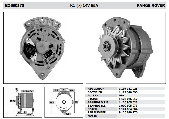

PostPosted: Mon Apr 16, 2012 3:55 am    Post subject: Converting to externally reg alternator Reply with quote
Is the alternator in picture "externally regulated"?
Bob Verwey

PostPosted: Mon Apr 16, 2012 5:07 am    Post subject: Converting to externally reg alternator Reply with quote
Bob Verwey
Safari ZU-AJF
The parts list for spares lists a regulator
so I would guess that the regulator is internal
to the machine.
