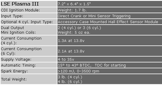

Discussions not withstanding, the published
current draw values for LSE products say that
the greatest current draw for a 6-cylinder
system is 2.1A at 13.8 volts.
[img]cid:.0[/img]
Given that the device features a switchmode power
supply with a wide range of operating voltages,
we know that this is a constant-power mode of
operation. So 2.1 x 13.8 sez the critter needs
right at 30 watts for operation at MAX RPM. One
can expect the current to climb as voltage goes
down . . . so if you're operating battery only
and the battery is down on that 11-volt-slide-
to-darkness, the ignition system current will
have risen to something around 2.7 amps.
Likewise, operating current on a 29 volt bus
will be down around 1.0 amps. The 4-Cylinder
systems are still more frugal in their demands
on the electrical system.

>"I have had to do one inflight reset on the Plasma III on one system
>once. The reset was successful and power was restored to the unit. I
>removed the unit and sent it back to Klaus for inspection.
> . . .<snip>
>The point, when the unit faulted it tripped the CB and was then reset
>and provided service throughout the remainder of that flight."
Hmmm. If it immediately resumed functioning after resetting the
breaker, perhaps the ignition never failed, but the heat (and probably
higher currents operating at high temperatures) caused the breaker
to nuisance trip.
The keyword here is "nuisance". I've had to cut the
TC guys some slack for being somewhat submissive to
nuisance trips . . . to strive for the elegant solution
can sometimes be very time consuming and expensive.
One is well advised to trade off cost/benefit ratios.
In the OBAM aircraft world, we're not only able, we are
encouraged to refine any system's configuration in way
that increases the displacement between it's experimental
roots and an enduring recipe for success.
But when one gets a 'nuisance trip' with current protection
that is nearly 2.5 times the published draw numbers . . .
there are reasons to seek answers to some serious questions.
There is a clash of postulates which beg resolution.

Back when this came up a couple years ago, and Bob C and I discussed possible solutions to this, I did some testing with a 10amp breaker and a 7.5 amp breaker switch. Klaus calls out for power to always be hot from the battery which is not something I am fond of so I figured a switch breaker would be a better choice than two breakers and a switch. In running these two devices in series with the approx length of wire needed, I was able to repeatedly get the breaker switch to "blow" without tripping the 10amp. I know this is a bit of a given but I wanted to see it for myself.
I have a dual LSE3 config and I'm now considering simplifying this by having one off of my vp200 and the other direct to the battery with just a 7.5 amp fuse or breaker. This way if there is a nuisance trip, I can reset via the vp200 and run off a single lse if needed until I land. Of course that still does leave a potential failure mode should both trip and the vp200 connected one not come back online.
Michael
On Jan 26, 2012, at 2:21 PM, "bcondrey" <bob.condrey(at)baesystems.com> wrote:
FWIW, this subject has been discussed before on the AeroElectric list. Use the search function for the words "Klaus" and "crowbar" and you'll find a couple threads from early 2009. Turns out that it's not just over-voltage events that will cause them to crowbar but apparently over-temp. This was posted on Feb 1, 2009:
removed the unit and sent it back to Klaus for inspection. The fault
was determined to be an overheat situation. That unit was located in
an area without any real ventilation and without an form of cooling
while operation in Arizona during the summer. the compartment temp
was estimated to have exceeded 200 deg. F. The unit was modified to
the latest version (lower heat output components and a ventilation
port. The aircraft was modified to provide air circulation in that
compartment. After 300+ hours on that unit no faults noted. The
point, when the unit faulted it tripped the CB and was then reset and
provided service throughout the remainder of that flight. "
Without getting into the discussion of whether the design should or shouldn't be modified, my purpose on posting (now and back in early 2009) is simply to make those with dual LSE ignition setups aware that fuses can't be arbitrarily substituted for CBs in this case.

In the spirit of trying to move the ball forward I'll suggest that fusible links to protect the battery feeders are probably the best way to go in a cost/weight/reliability trade. They provide protection of the feeder wires, have a slow time constant so a panel CB will trip first, are inexpensive and lightweight. A larger CB would does the job also but with more weight and cost.
If you've only got a single LSE then maybe no issue since you'll always have a mag to fall back on. If you're running a pair of them however, you need to fully understand failure modes and mitigate the risks. This thread started with the question of whether a fuse would be an adequate substitute for a CB in this application. Given what I believe to be true about the ignitions, the answer is a qualified NO. Qualified because it's only a REAL issue if you don't have a mag to fall back on. Installing as recommended by the manufacturer using a panel mounted CB gives you a solid install. Just make sure you don't do something that compromises that by putting a fuse upstream or substituting a fuse for the panel CB. If you want to protect the feeder use a slightly larger CB or fusible link. You can do a very simple experiment as Michael did to validate the fuse issue (when upstream of a CB).
Bob C

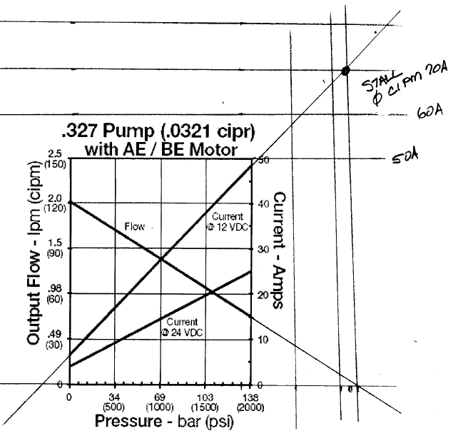

PostPosted: Sat Jan 28, 2012 12:12 pm    Post subject: Fuses instead of breakers Reply with quote
So perhaps 10AWG wire is not required ?
The installation instructions show 12AWG with a 25A pullable breaker.
Many builders are happily flying with this installation.
Well, let's run the numbers and see . . .
The hydralic pump motor is a Parker-Oildyne series 108 12VDC permanent
magnet motor code AE 0.327".
AHA! REAL stick-to-your-grey-matter data. It's amazing
what you can discover if given a few numbers. In this case:
[img]cid:.0[/img]
Okay. The critical numbers here are the cubic inch displacement
per revolution (0.0321). The current at any two flow points which
gives you the slope of the line in PSI/AMP. The point where
pressure goes to zero but flow is max. This point establishes
the internal energy dissipation in motor and pump. We could
develop all the torque and CEMF constants for the motor
in numbers . . . but the questions yield nicely to a
pencil and straight-edge solution too.
I've extended the curves to the point where flow goes to
zero (stall) and current goes to zero (which provides
the anchor point for zero load RPM of the motor. But to
get to THE question of the moment, I deduce that stall
current for this motor is on the order of 70 amps. This
current is EQUAL to that demanded of a 3200 PSI condition
which can never be achieved because of the relief valves.
The pressure switches are 500psi. I assume this means that there will
be brief spikes above this pressure at the motor when it first starts
up, but after the fluid is moving, it must be less than 500psi.
Actually no. Pressure induced motor current is dominant only
after the motor is stable at some speed. During start up, the
flows can be no greater than what the system back pressure
allows and is probably quite low. Motor current is high because
the armature is accelerating to a stable operating point. If
pressure reliefs are set for 500 psi then the maximum operating
current for the motor will be 17A and probably achieved only
when all cylinders reach their limits causing flow resistance
to spike. Only then would we expect the pressure to climb
rapidly for the moon . . . and were it NOT for relief valves,
the current would approach stall or a hose will blow off.
Now, if you started the motor up to FURTHER extend/retract
the gear against hard stops, you get the same 70A inrush
which would fall only to 17A and stay there as the relief valves
cracked. System pressure would never exceed 500 PSI.
Based on the small graph, the current at 500psi is 17A to produce a
flow of 51 cubic inches per minute, but I have no method to estimate
the inrush current as the motor starts up. The graph stops at 2000psi
at 48A continuous (but not for long according to the intermittent use
temperature graph).
Now you know how to do it.
The successful use of small relays would indicate the inrush
current is not significant ?
No, it's always significant.
Keep in mind that system wiring can have a profound
effect on inrush currents. 70A at 12v implies a motor
resistance of 12/70 or 0.17 ohms. 10AWG wire is one
millohm per foot. So adding say 10' of 10AWG in the total
loop resistance takes your motor + wire up to 180
milliohms for a new inrush of 12/.180 or 66 amps. Of
course, this doesn't account for any sag in electrical
system voltage during inrush. 12AWG wire is 1.6 milliohms
per foot so inrush comes down some more.
Since the running current cannot exceed 17A due to
action of relief valves, you COULD consider a 14AWG
or even 16AWG feeder for the purpose of limiting
inrush . . . assuming that becomes a design goal.
This would have no effect on available system pressure
because that is set by relief valves. It WOULD reduce
available flow at that pressure because motor voltage
hence RPM is slightly reduced. Wired per the instructions,
it seems that your inrush will be on the order of 50-65
amps which is no big deal on a 30A relay.
I don't know how to estimate the inrush current, nor the amount of
voltage sag that would negatively impact the motor at startup.
So I can't calculate any possible advantages of heavier wire Sad
The 'advantages' if any are murky. The system you're installing
has a successful track record with components specified
by the manufacturer. I can see no compelling reason
to alter that recipe.
