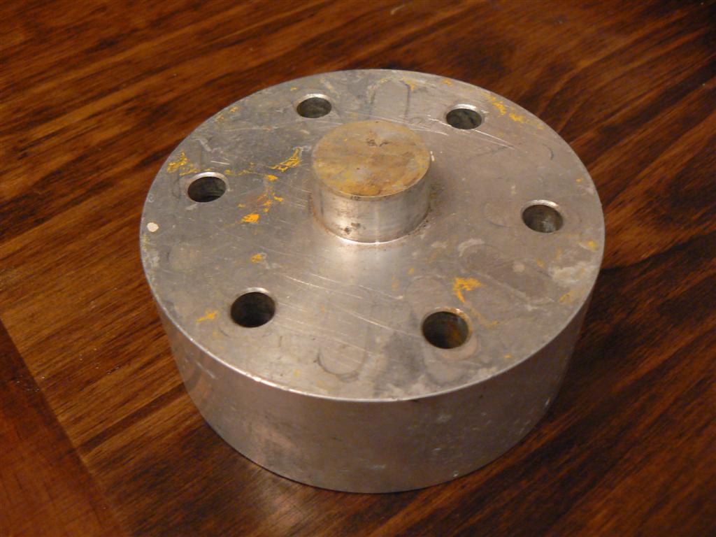

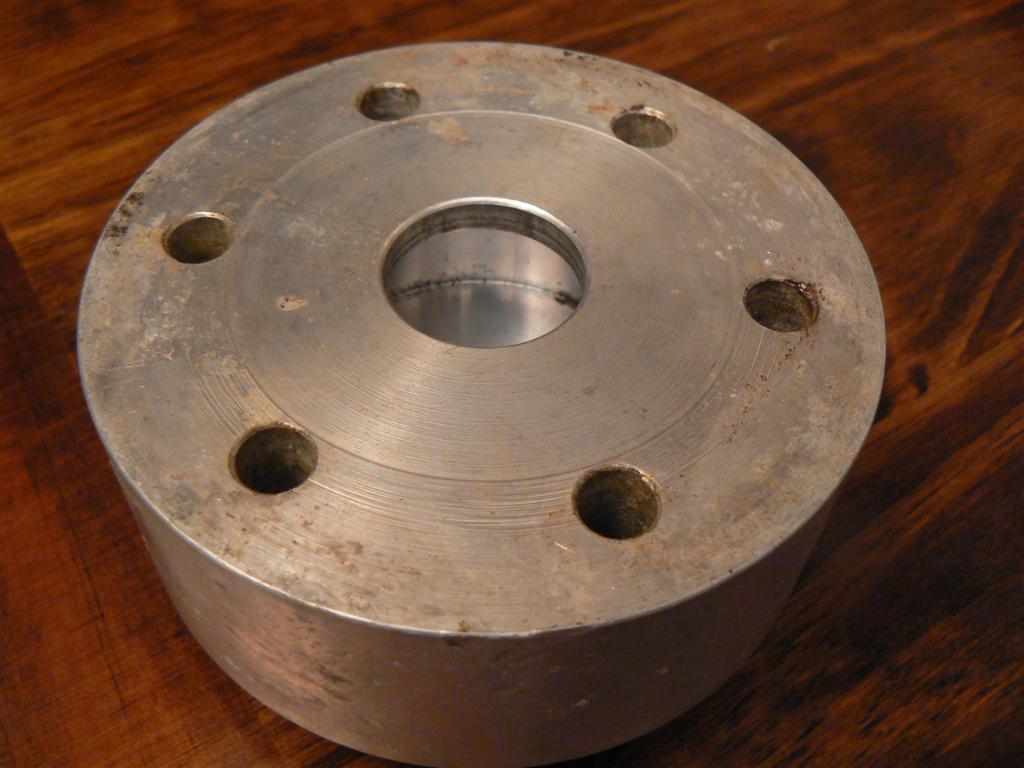

Finally found my spare Ivoprop spacer. It is 1.5" thick, and anyone who wants it can have it for $30, that includes shipping. You'll need to source your own bolts & crush plate, don't have any spares. Yes, that is yellow paint on it, not sure how it got there, it will look better after a little attention from the Scotchbrite pad & Mothers polish...

As you can see from the pictures, the Ivo spacer does have a centering boss on the prop side, and a hole cut in it for the drive flange boss, and both of them are snug fits.
