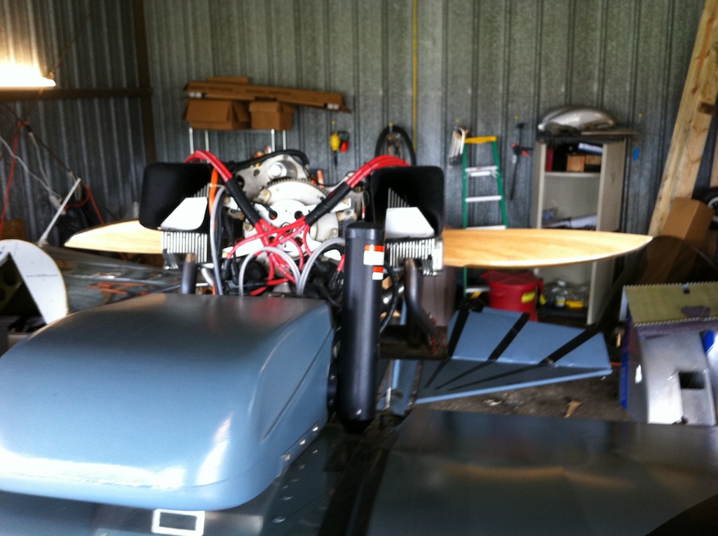

I do now. See attached photo.
Went to the hangar today to replace the Bing jet needle with the Jabiru jet needle for the 2200. It made a world of difference. My cruise EGTs with the Bing needle were around 1225 and it topped 1350 on WOT climb, more or less the opposite of what they should be. I swapped needles and changed main and needle jets to the closest I had to what Jabiru recommends for this needle on a solid lifter 2200.
With 255 main jet (235 recommended) and 280 needle jet (as recommended) and Jabiru needle, I get EGT of 1320-1330 at all cruise rpms below 2900. At 2900 and above the EGT starts dropping. During climb, I can get to over 500' AGL at WOT before the EGT starts climbing above 1250 and into the 1325 range. Lowering the nose to raise the airspeed a little or backing off the throttle a bit gets the EGTs back down to correct range. I'm perfectly content with the cruise EGT but might go to a bit larger main jet to reduce the climb EGT. As a side benefit, the climb RPM went up about 25 rpm and climb rate was up to 1200 fpm from 1100 before.

Thanks Thom !
A picture is worth a thousand words ! Waiting for the weather to break to try out the deflectors ...I''ll let you know what happens..

Thanks Thom, good pic of the baffles. I will try to make something similar for mine. I also already have close to the same jets I just need the needle, I will go ahead and order one I think, and I will make sure I call Jabiru Pacific for it.

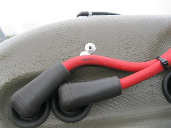

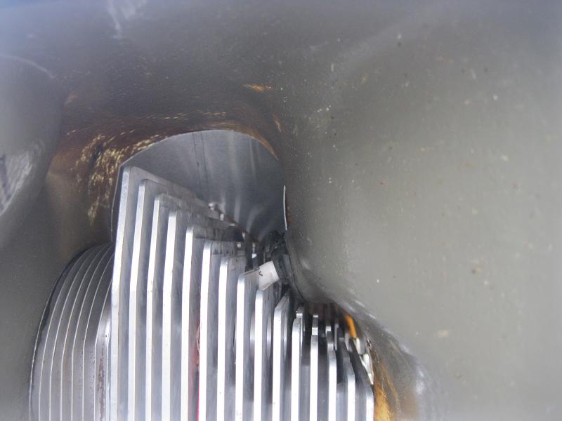

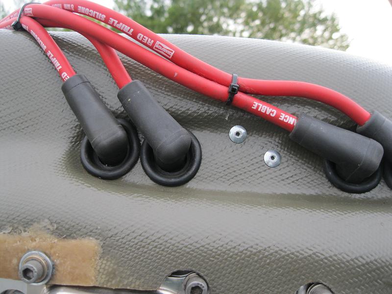

here are some pictures for you....the scoop with the rivits on a steeper angle is the way you want to do it...at least 45*....the first one ended up being less than that and although it worked,it didn't work as well as the second one I did...also it's aimed toward the front of center...
Take a look and I'll try and answer your questions...I haven't put the ones in the front yet...

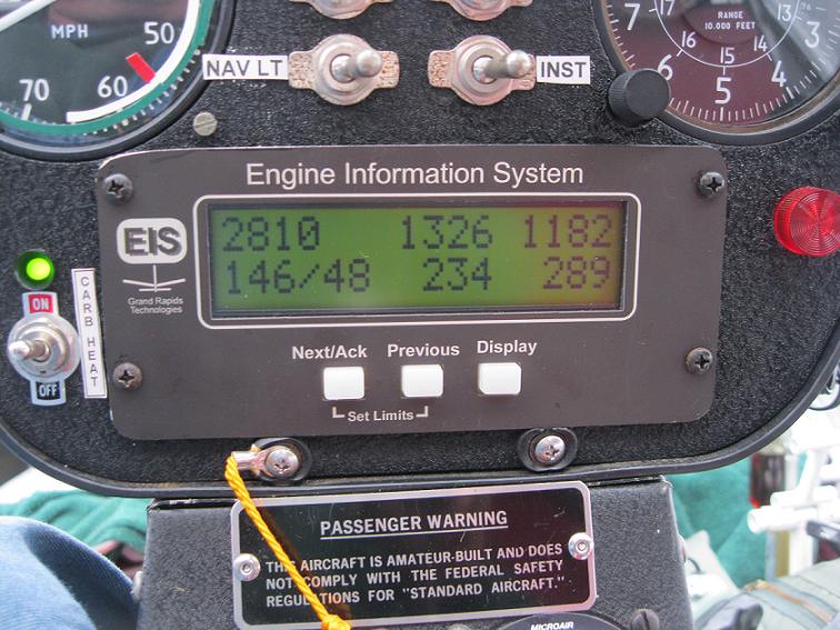

In your photo, is your EIS reading 1326 and 1128 EGTs?
If so, that is quite a spread. Are they on opposite sides? If so, you may be able to get a better balance by tilting the carb bottom (float bowl) about 10 or more degrees toward the lean side, instead of level.
There is an airflow divider in the intake, oriented vertically, that smoothes the fuel/air flow before the fuel is completely atomized. However, it also splits the flow somewhat. The fuel comes into the venturi from the bottom and the airflow tends to spiral somewhat so one side frequently gets a richer mixture than the other side. According to Pete Krotje, this can be offset by tilting the float bowl toward the lean side.

I did that and it did help some...the egt's are on 3 & 4 respectively with 4 having the lowest compression of the 3...(65#)....in your opinion would that make it lower?? This winter I am planning on cleaning that cylinder up and re ring it...2&4 were the 2 cylinders that got hot during that mess I went through last winter when I had the engine stoppage problem..

Lower compression means lower power but not by much. I doubt that in itself would mean lower EGT. It is possible you have a valve issue or something else. I can't remember if your engine is a solid lifter or hydraulic lifter. If solid, do you adjust them at every oil change? Do you check the head bolt torque then too? Just thinking out loud.

The photo of your forward deflector looks to me like it goes down all the way to the head fins. If that is the case, then you are probably blocking air flow to the aft cylinders. Since your two CHT sensors are on the front cylinders (3 & 4) you should move them to 1 & 2 temporarily to check their temps.  Once you get them all in fairly close to each other, then it doesn't much matter which ones you monitor thereafter.

I have the cht's on 1 & 2 and the egt's on the front cylinders...I wish I had the 4 cylinder one.... ;(... I know it's kind of confusing... front is back and left is right....lol
