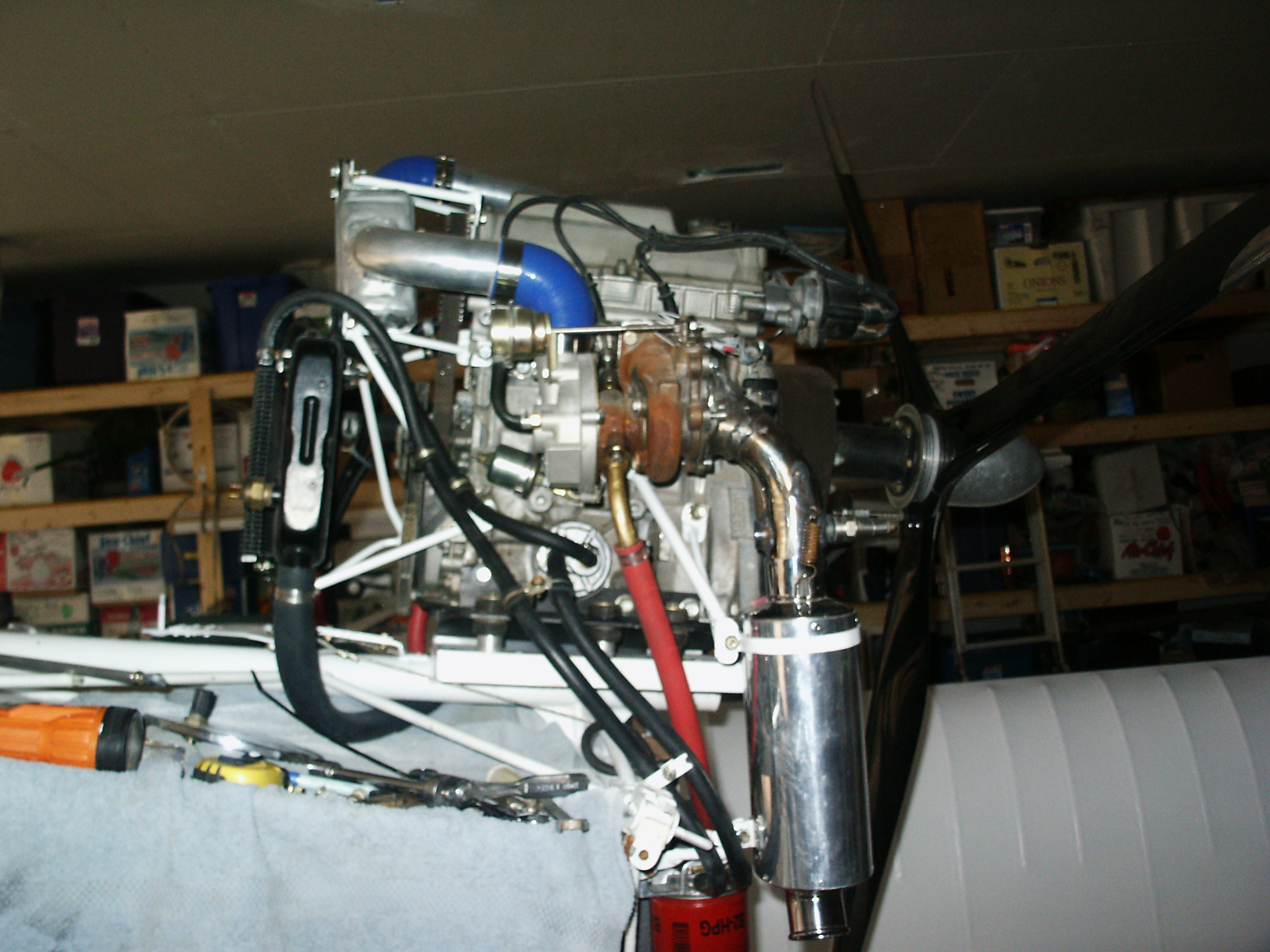

  Here's a picture of my engine/turbo/exhaust that I took last year.  Since this photo was
taken, I have "buttoned up" a lot of loose ends.  In other words...this is a photo of a
'work in progress'!
  Some details about the engine;  the remote oil filter is the orange thing by the muffler.
The silver thing that the blue hose things attach to is the intercooler (the 'air' radiator
that takes the heat out of the compressed turbo air).  The oil cooler and radiator
are mounted out in front of the motor (duh).  The red hose from the turbo is the oil
drain line, that gravity feeds excess oil to the remote oil tank for the motor.
  There.  More info than you needed.
